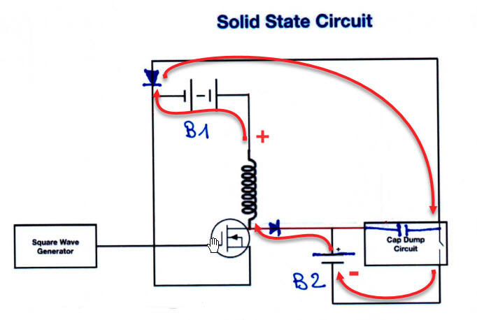

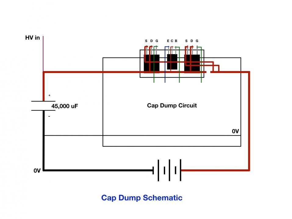

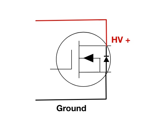

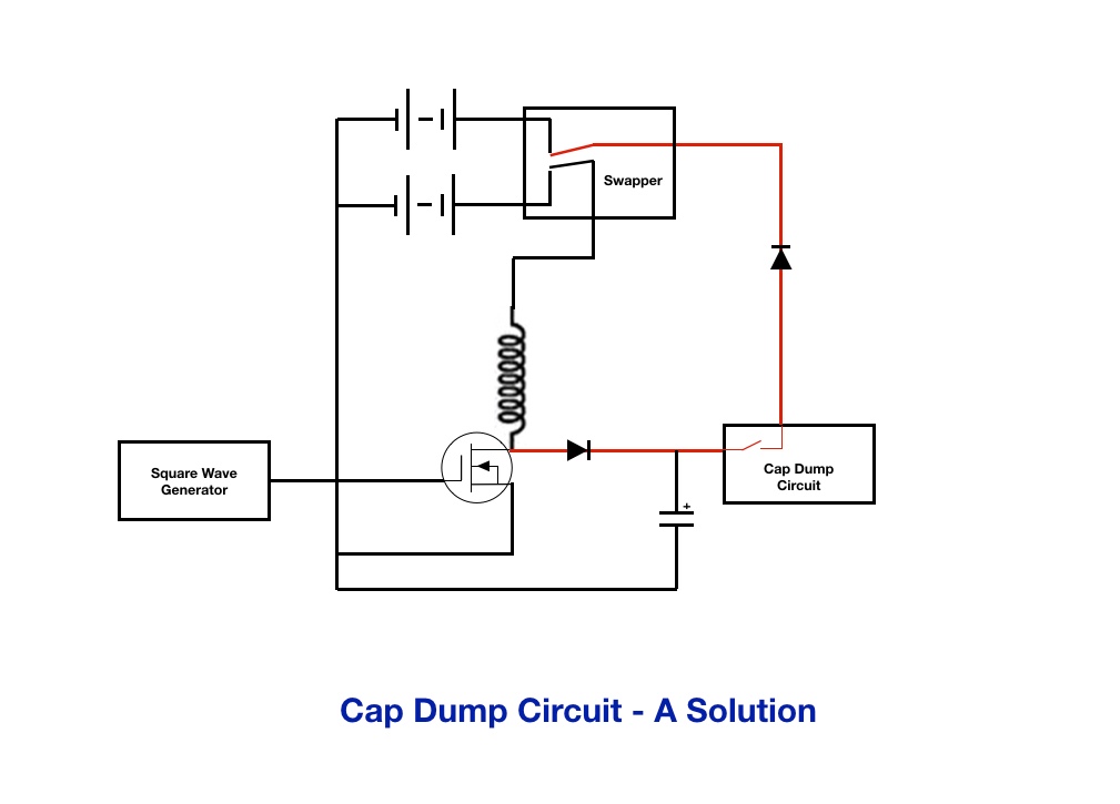

here is a solution that works, with a second battery.
In red: the circuit of the current when the coil collapses (Note: B1 does not discharge during this time, it just lets the current flow).
You can think of other solutions.
