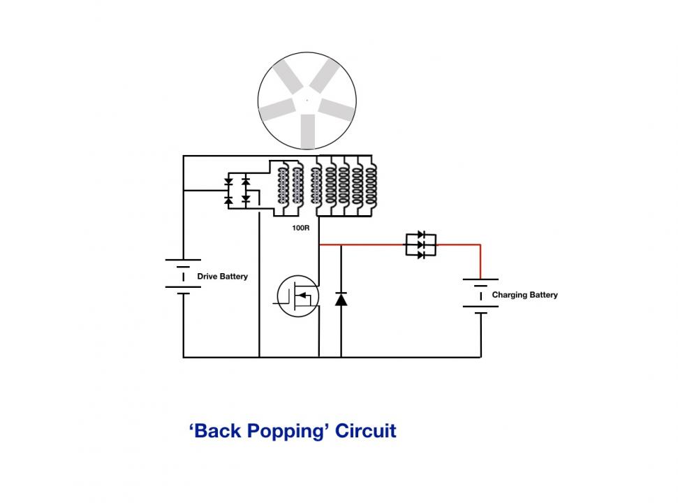

            Hi Gary,
            I have come up with a circuit that I think does what you suggest for 'back popping' and integrated it into my 'basic' Hall switched circuit, but I also have in mind the sketch that you sent to me earlier. The three coils with grey lines through them are lizted on one coil. Have I got this right?
            Thank you
            Jules
            'Consciousness came First'

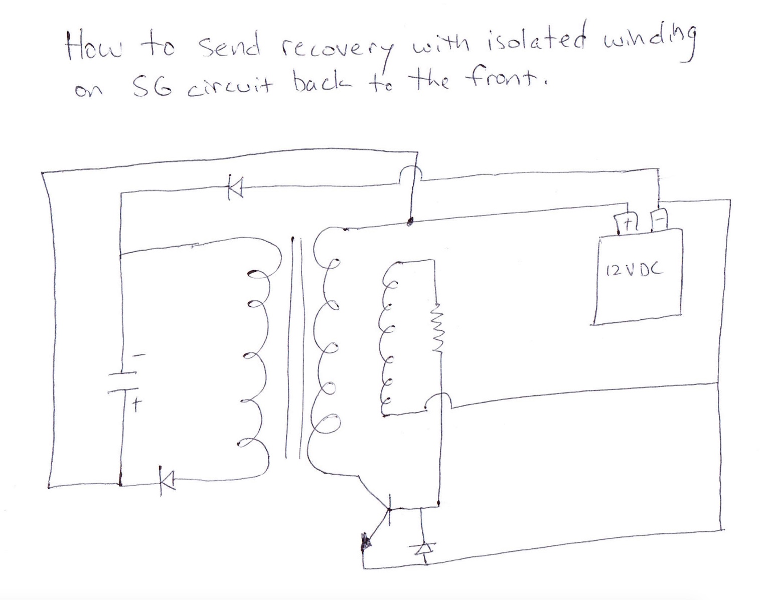

                The circuit you came up with should work quite well! It is a common ground "generator mode" circuit. And if you want to change it to "radiant mode" just connect the negative end of the charging battery to the top of the coils which is also the drive battery positive. (And yes, you are correct about the three windings litzed on one coil in that schetch. One is the trigger winding, one is the power winding, and the other one is the recovery winding in Classic Bedini fashion.)
                In your new circuit you can also install the common terminal of a single pole, double throw switch to the charging battery negative and then one switched terminal to the drive battery positive and the other switched terminal to the drive battery negative. This will allow you to easily switch back and forth from "generator mode" to "radiant" mode with only the flick of a switch! This is how I have my Bedini SSG configured and it works great for experimenting and making comparisons. And in radiant mode you could charge several batteries in series as you've already discovered.
                Besides the option you mention at the end to 'back pop' the drive battery, I think we agreed that the synchronised FET option I devised could also work to isolate that route and it might be interesting to see how both options work. I will put together some circuits to run by you.
                At some stage I am also interested to either assemble a battery swapping system for charging two batteries, with each one acting as the drive battery without being charged, or a capacitor charge/discharge unit and probably both.
                I like all these ideas.

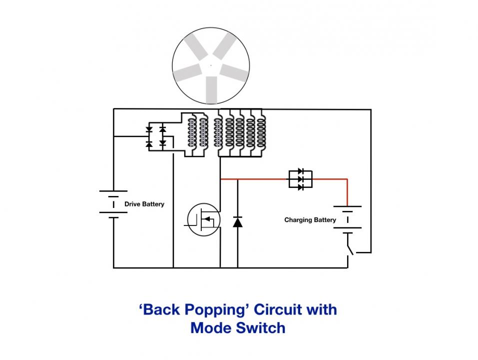

                  • #69
                    'Back Pop' and mode switch
                    Hi Jules,
                    Hi Gary,
                    You mean like the attached?
                    From what I have read the 'Generator' mode is more efficient and makes best use of the extracted energy but it would be worth experimenting to see the difference, especially to compare having 2/3 additional batteries in both modes.
                    For my bridge rectifier do I need 1000V rated diodes or can I use the IN5408?
                    I should be in a position to test my 'double FET isolator' circuit early next week and will report back - and of course the other developments as I come to them and get results. I have a good circuit for the battery swapper and for the cap dump I am reading up on time vs voltage based methods. I'm hoping that when the time comes you or others will be able to guide me on the optimum circuit and related matters
                    Jules

                          Hi Jules,
                          Originally posted by JulesP View Post
                          Hi Gary,
                          You mean like the attached? .......... Jules
                          Yes. That's exactly how I did it.
                          I think the 1N5408 diodes are rated at 1000 volts? They should work just fine.

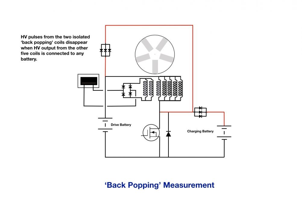

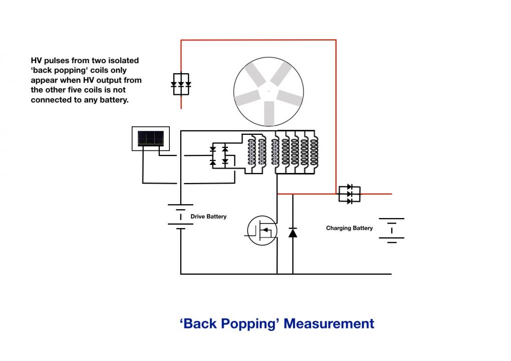

                            Back Popping Measurements
                            Hi Gary and co,
                            I have tried the two approaches to delivering some charging to the drive battery with the following results.
                            Firstly, using the double FET method to isolate the line from the battery to the top of the coils did not function as, despite a simultaneous pulse from the transistor collector reaching both FETs to turn them on, the additional one did not conduct to initiate the coil current. It may be something very simple or perhaps I need a different type of FET to trigger the + line in that position. Whatever it is I decided to put that aside for the time being and focus on the 'back popping' option.
                            I measured some nice HV pulses of the same magnitude and resulting capacitor voltage as from my earlier tests. I am assuming then that the back emf pulses being generated in these two isolated coils (from the litzed three coil) result from the collapsing field in the remaining single coil and not from the rotor magnet moving away. As such I would expect the pulses to be of similar voltage and magnitude to those I measured before the circuit modification. However, as soon as I connected the HV from the main coil group back up to either the drive battery or any additional batteries to charge, and in any configuration (Generator or Classic/Radiant mode), the pulses from the two isolated coils disappear (like in the second pic)
                            I am wondering if this is because once the HV from the main coil group is being 'assimilated' by one or more batteries then that loading alters the way induction occurs in the 'back popping' pair of coils. If that is even remotely so then I can't see how any HV pulses are going to reach the drive battery to try and offset its discharge. I attach a pic of the setup where I see good pulses.
                            I'm sure your much greater experience will come up with an answer.
                            Jules
                            • #74
                              Hi Jules,
                              Hi Gary and co,
                              Jules
                              Yes, you are correct. The pulses you are collecting from the two isolated coils result from the collapsing field in the remaining single coil and not from the fleeing magnets. They are all magnetically coupled on a single core.
                              The reason you are not able to harvest the pulses from the other four coils is probably because they are driven by the same FET that is powering the master coil and using the drain lead to attach the three parallel collection diodes to.
                              The main coil needs to have it's own FET for switching and the other four coils need a separate FET with the paralleled collection diodes attached. You don't want a collection diode attached to the drive winding of the master coil, as this will steal the pulse from the two isolated windings you want to harvest with the bridge diodes for " back popping" the run battery.
                              • #75
                                Hi Jules,
                                your results make sense in your circuit as shown. The oscilloscope is a very high impedance load (basically an open) and the batteries are an extremely low impedance load (basically a short) so when you hook up the batteries you short the coil across that battery. The problem is not in the circuit, but in the measurement technique. Try replacing the oscilloscope with a battery and checking for charging, which is what you really want anyway.
                                The same applies to checking for charging when applying the back popping signal to the drive battery. you should measure the voltage decrease over time without the back popping, then measure the voltage drain of the drive battery over the same length of time with back popping, if you have less drain then your back popping is giving you a charging effect. The disadvantage to this is it is not a quick measurement and takes a significant amount of time to establish your baseline and then observe for charging effects.
                                Michael
