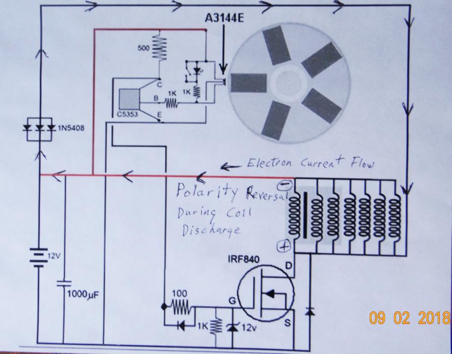

Hi John,
That sounds like an ideal solution. Did you use that in 'attraction' mode where the 'on' time finished just before TDC? Do you have a circuit diagram for that and is it straightforward to integrate it into my circuit which is shown as image 'BEMF Circuit 2' at: https://www.dropbox.com/sh/0y15dybr5...mn2q6QhHCa?dl= 0
Jules
