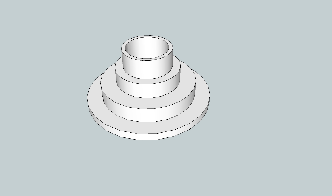

        Lately, I have been experimenting with coil forms. Treating the EMF as light, using optics principles. It seems to be working, winding coils as lenses so to speak. A wedding cake design, gluing the two pieces together as convex or concave. Using bifilar windings on each. I glue a disk on the smaller end, and wind up to each step in one direction, the same direction for both. Click image for larger version
