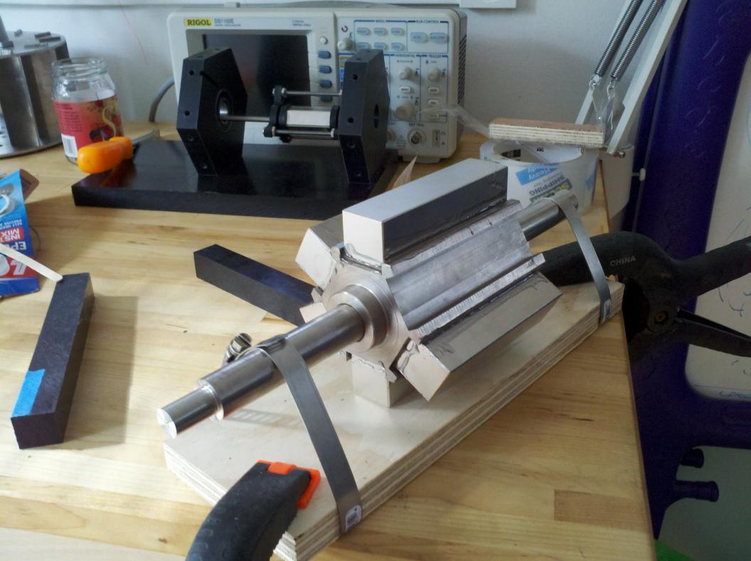

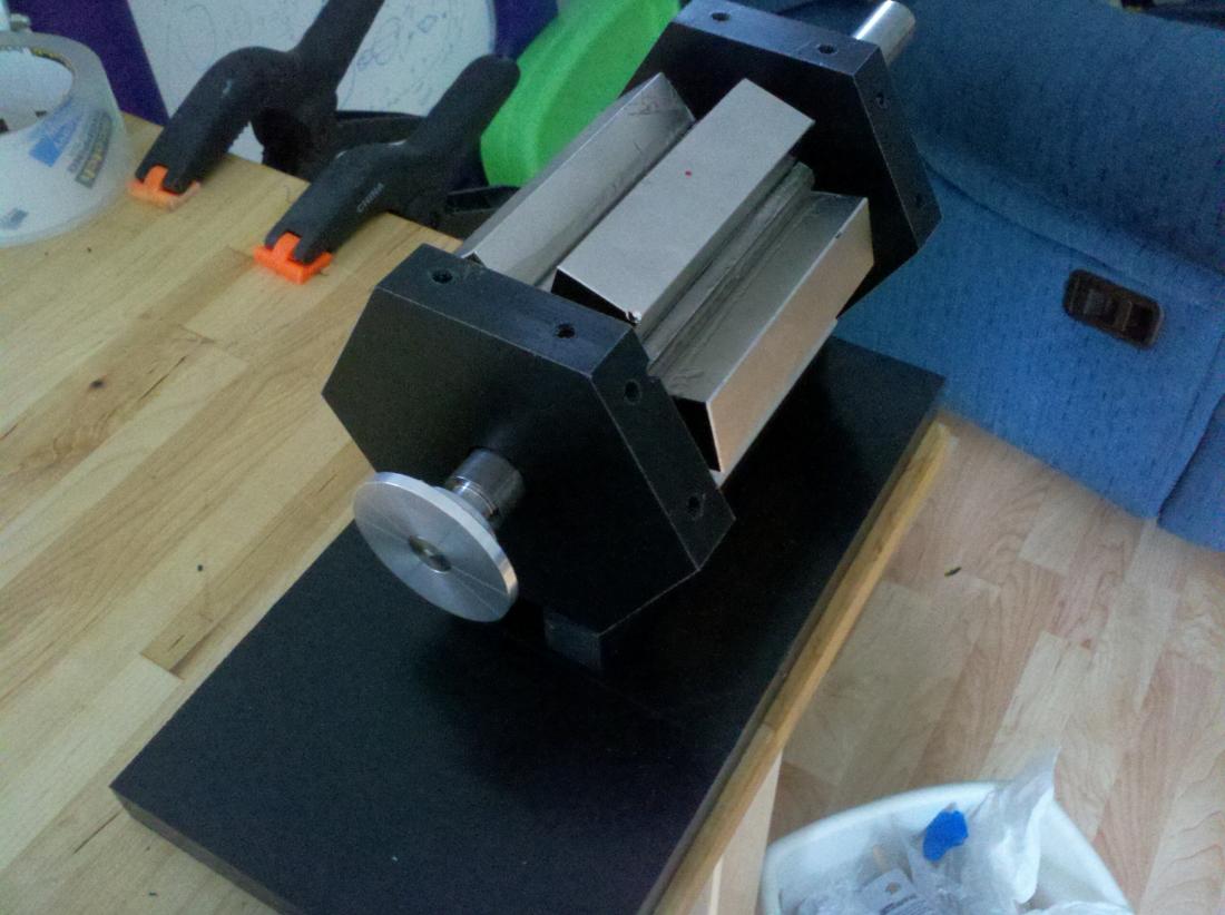

        the only safe way to handle neo mags is to leave them somewhere else, far away from things that can bleed...... I have a rotor with 500 LB pull neo mags, its a widow maker. I had to build a special jig to use them and shorting plates for them so they fields were a bit weaker.
          id love to see this rotor/setup tom

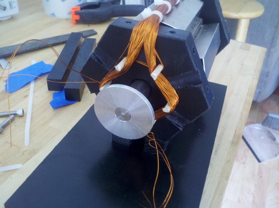

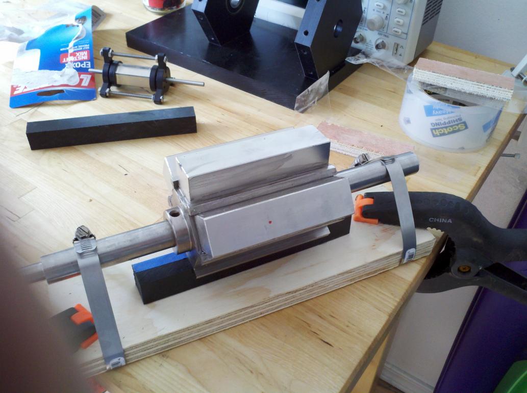

            here ya go note to everyone, this rotor was a FAILURE!!! the fields were so huge that there was no way this thing was going to work... I had the core machined 250.00 the magnets were almost 600.00 another two hundred for the PTFE cut machined and tapped the timing disc was 25.00 I brought it to John and he said "it will never work" I said "why?' he said " take the coil and short it" with the coil shorted to itself, you could not turn the rotor by hand, or even with a 2 foot bar on the axle. the induced current in the coil was so hi, it was immediately in a locked rotor situation, and I shocked myself pretty good unhooking the coil. basically for this rotor to even begin to work as a window motor the coils need to be 9 inches away from each side.
            in order to use this as a generator rotor it would need a 10 horsepower motor at least.
            so... yea expensive lesson learned. I wanted to reuse the rotor but guess what, I glued the magnets on with 3500 psi 2 part epoxy, and the slots are all tolerance fit at three thousands of an inch. I then dropped it out of my press and chipped the corner off one of the 90 dollar magnets...
            so everyone just stick with ceramics.... especially with window motors until you really know what you are doing.

                  the full BC circuit likes 12 or 24 volts, I have never run them higher. it would require different components. it did not even turn....... the force was just too hi. it will run one day as a generator. I wish I could re use the rotor, going to get another one machined eventually, at least then I can use the frame, axle and the timing disk.
                  it just shows what using the wrong ideas about magnets will lead you to.. like stronger is better for a window motor... WRONG!!

                        did you ever try the windings 9" away ?

                          The rotor is drilled and tapped for dogpoint allen set screws, it looks like a collar but it is just a step, no never tried the big windings, just too much wire. you handle them one at a time. I used plastic spacers between each magnet when I glued them in. they came from the magnet place with spacers and shorting plates,
