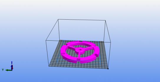

                  my first rotor drawn in 123D design from autodesk, imported into repteir- host. this is the screen grab from it after it imports the STL file. Click image for larger version

                    Awesome stuff Tom! Love this machine...thank you for recommending it. Does everything I need and cost so much less to get started....just a little time investment and voila!
