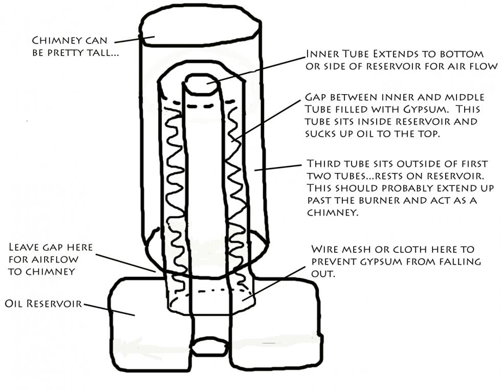

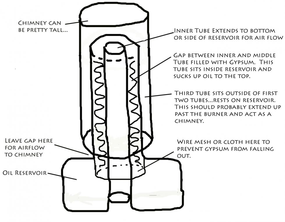

Ok I think I have a design laid out. I am not a pro in photoshop by any means...so this is a very crude drawing. Incidentally it kinda looks like a penis lantern, haha...so just ignore that.
This is how I THINK it needs to be laid out according to what I've read here: Argand burner (oil lamp) -- Britannica Online Encyclopedia
