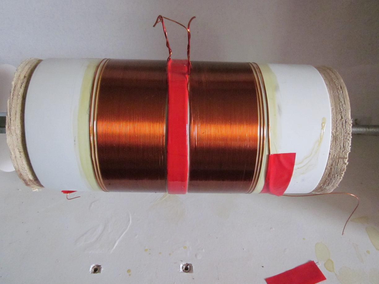

          Thank you Nick,

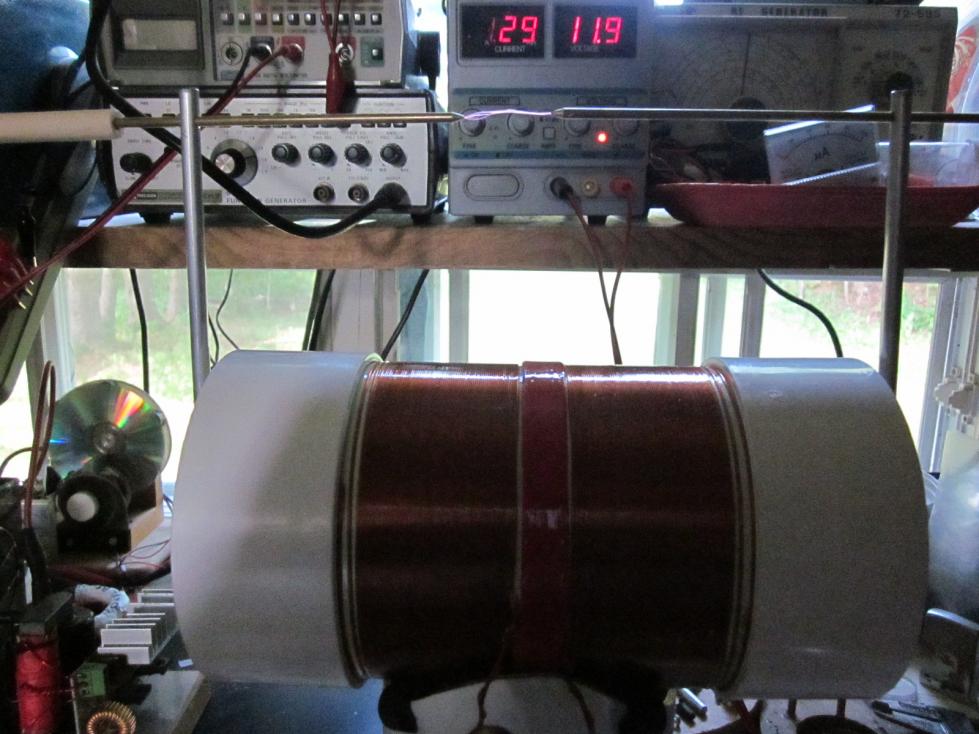

          The whole concept may not be easy to grasp for everyone. Also, the circuit including Tesla Coil, dealing with high voltage and overall cost may not appeal to an average experimenter. I managed to get main components for far less than "retail price" and make the rest at home. It maybe easier for some to get NST than build ZVS circuit. This can be also done on LM555 based PWM driving ignition coils which are easier to find and cheaper in EU than here. Tesla Coil can be made with 150 feet of wire (2x70T) instead of 2x350T as I did, but that was the wire I had. Instead of single hv capacitor rated at 30kV (which can cost $30-50) it is better to use a bank of 4kV rated in series/parallel. It is cheaper and the overall stress is equally spread among them. Spark gap can be single and made of two stainless bolts. I used a roller shaft from printer which was cut with dremel into 1-1/4 pieces, fastened in household fuse box terminal. Scrap piles are full of treasures. I built my first SSG (few years ago) and it didn't cost me one cent. It is a matter of adapting of what you have. This can also apply to every day of our life.

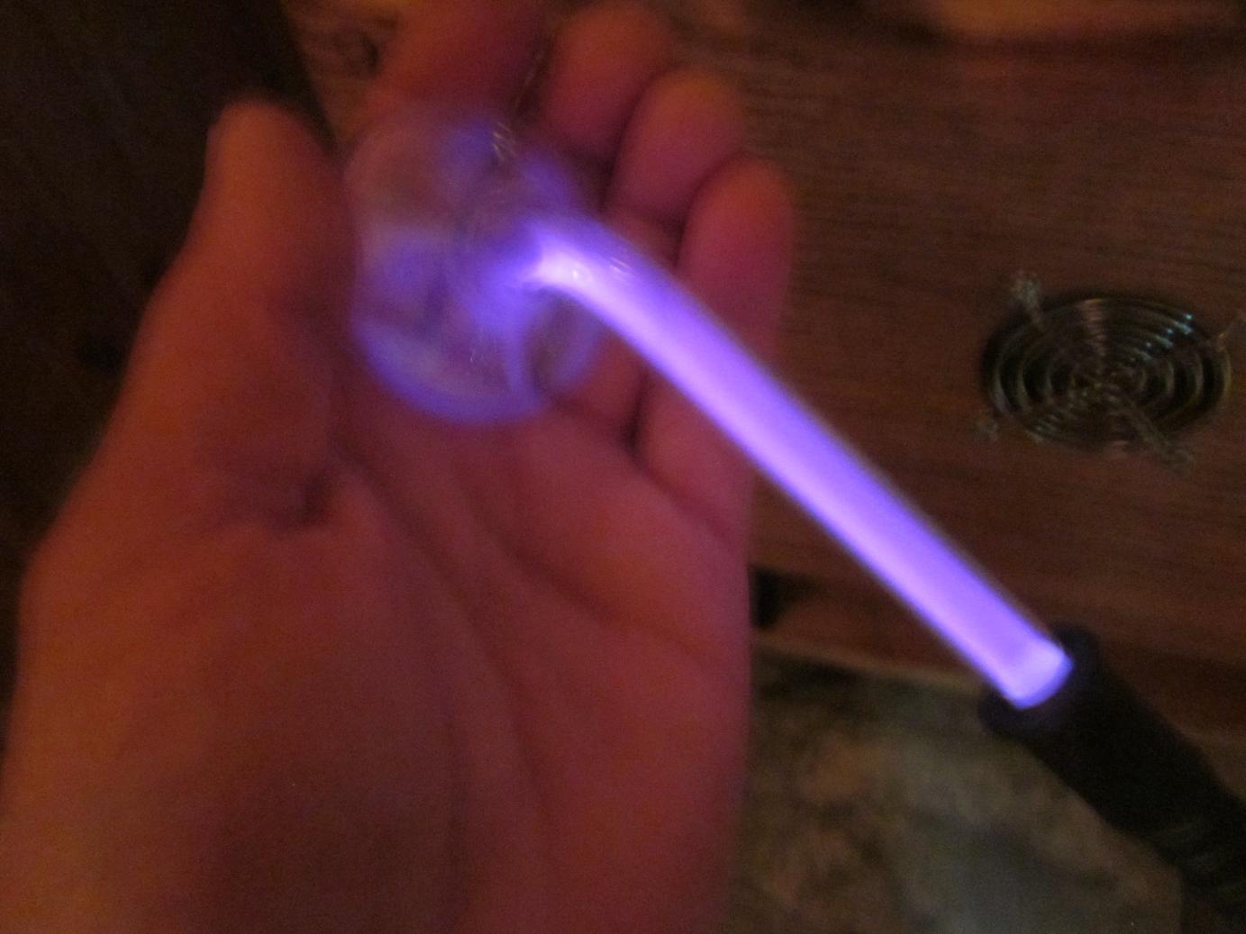

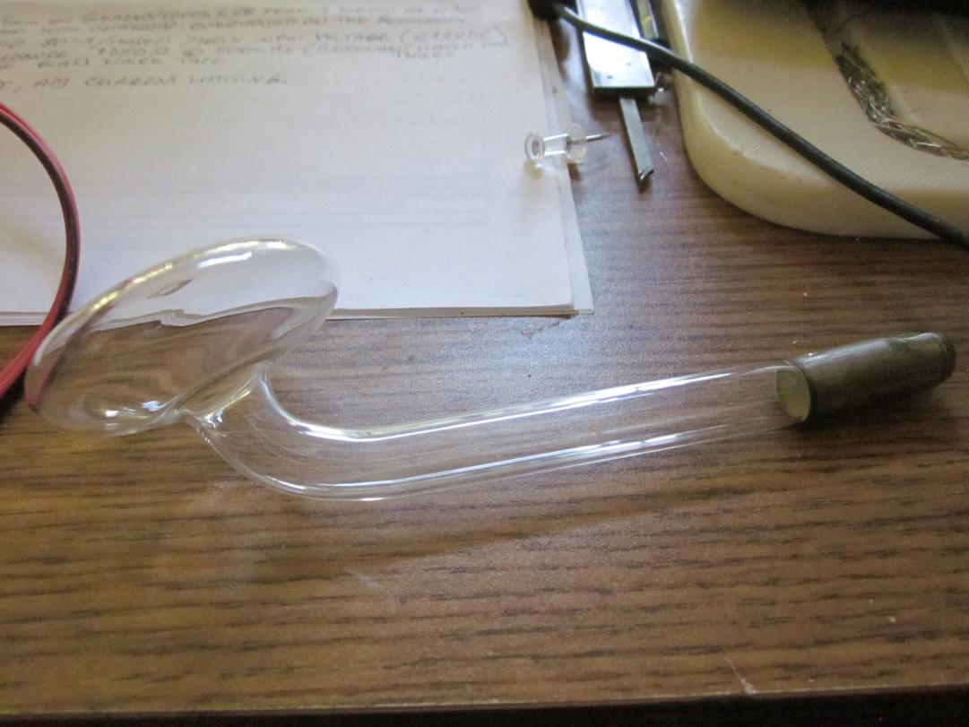

                  I've been doing more tests and studied MWO operation in resent days. It seems that the antennas designed by Eric Dollard are indeed the MWO on their own, even not being powered from Tesla Coil. I just got more hv caps and will try to assemble another circuit without NST transformer but ZVS driven flyback and spark gap interrupter. I already tested this idea with my current device and it works just fine. New coil is awaiting more varnish and better insulation of primary winding as I discovered some sparking between primary and one side of secondary in my bigger coil at higher power levels. Also, I found those conductive silicone cables having too much of impedance. I liked them at first since they're very flexible but found them getting warm after 15min at 50W only. I have hv cable on order but it is rated at 40kV only and I may have to use some highly dielectric tubing over to increase their breakdown value. Good 100kV rated cables are quite expensive.
                  The original devices had only 5-15kV running from the main unit to the TC, which was connected to the antenna. Here, I run both outputs from bi polar TC to the antennas and these potentials are much higher.
                  Also, managed to acquire original Violet Ray mushroom type tube from 1927 and in perfect working order. I wish to eventually get the Phanotron helium filled tube and hook up to my MWO but can't afford that right at the moment.
                  Once I get everything in "mobile" form I want to conduct some test outside, using the Earth ground instead of grounded metal plate.
                  More will follow.
                  Vtech

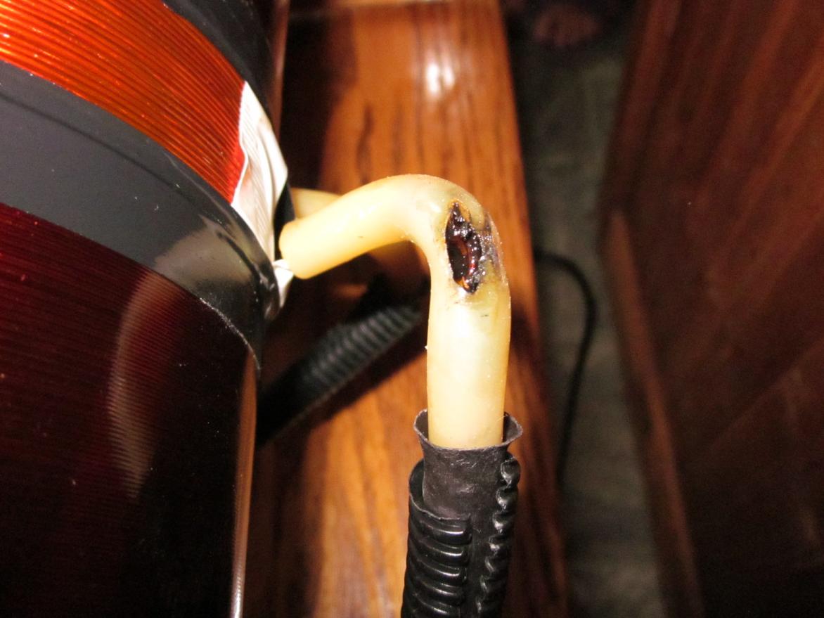

                    This morning I unwrapped the primary to find the problem with decreased output from one secondary at higher power level. What I found was the cable going to the primary failure. Interesting, since it was 20kV rated cable with 1/16 thick silicone tubing over it which I folded before wrapping with PVC tape. Luckily, windings didn't sustain any damage so it is just a matter of replacing cable and running straight down without any bends. I was expecting shorting between primary and secondary winding so this came out as a surprise and relief since it is a minor fix.
                    Vtech

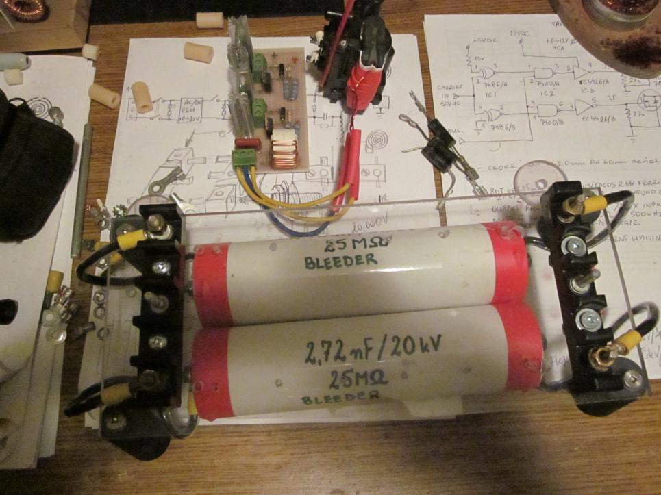

                      New, smaller coil and ZVS/flyback driver. Power input between 11-15W at 12VDC which can be increased. Still testing with temporary spark gap. White tubes are holding capacitors with bleeding resistors. Much more "compact" than NST driven and it should be sufficient enough.
                      Vtech
