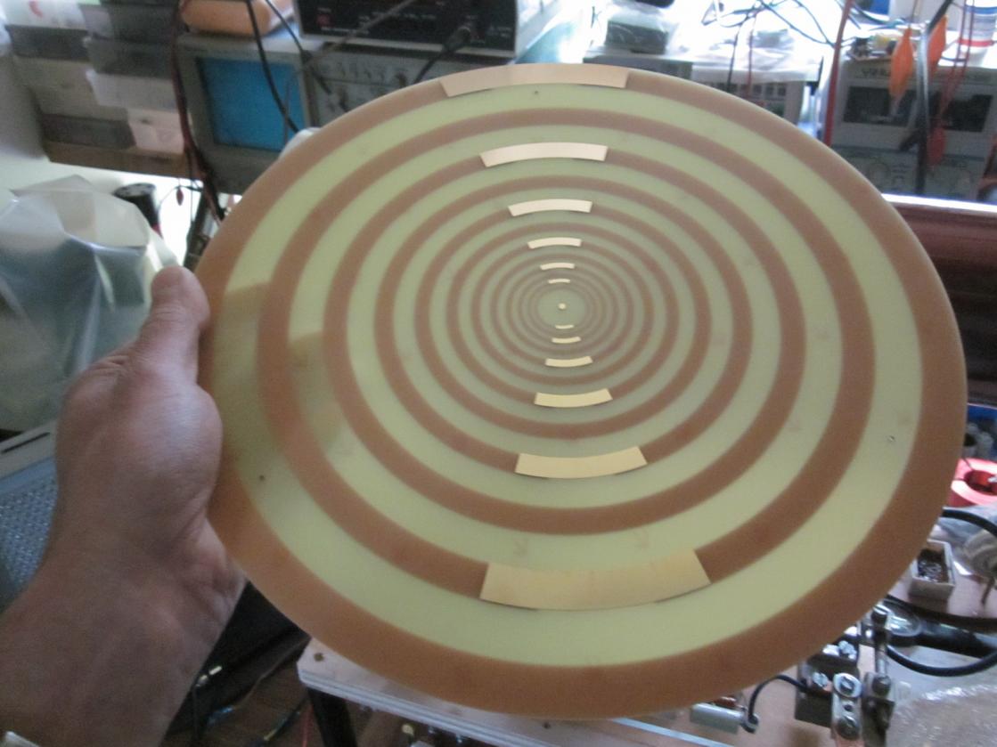

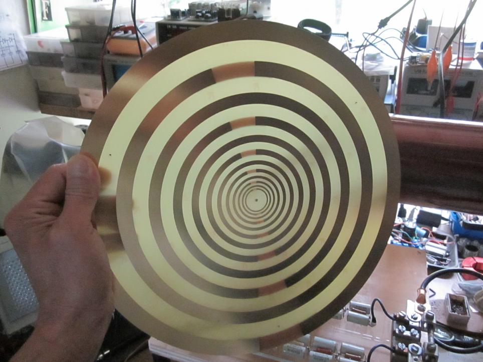

A log periodic antennas designed by Eric Dollard. They're based on Golden Ratio which can be found in living systems - plants, animals and humans. They're two sided where second side being capacitive loading. This is similar to spheres used by Lakhovsky on the end of antenna rings. They're gold plated, 12" in diameter. The term Golden Mean, Ratio or Section refers to the mathematics of life, which is logarithmic function and can be found everywhere in nature. Also being referred to as Sacred Geometry and been discovered by Wilhelm Reich to be the basic mathematical property of Orgone energy.
Log periodic antennas are capable of creating a virtual but functioning antenna which extends up to 4 times the actual one.
They're frequency independent and an excellent for HAM communication.
Pictures below are the actual antennas (just got them made) which I'm planning to use with my MWO.

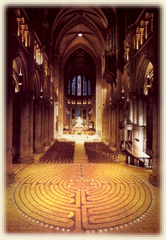

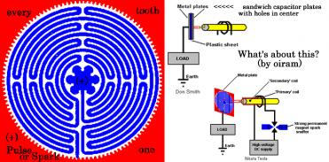

If you take a look at their printplate antennas and compare with the floor design labyrinth below you'll find interesting similarities. This design can be also found embedded in the structures built by ancient civilizations. Was this purely decorative motive or they knew more about waves and vibrations than we do

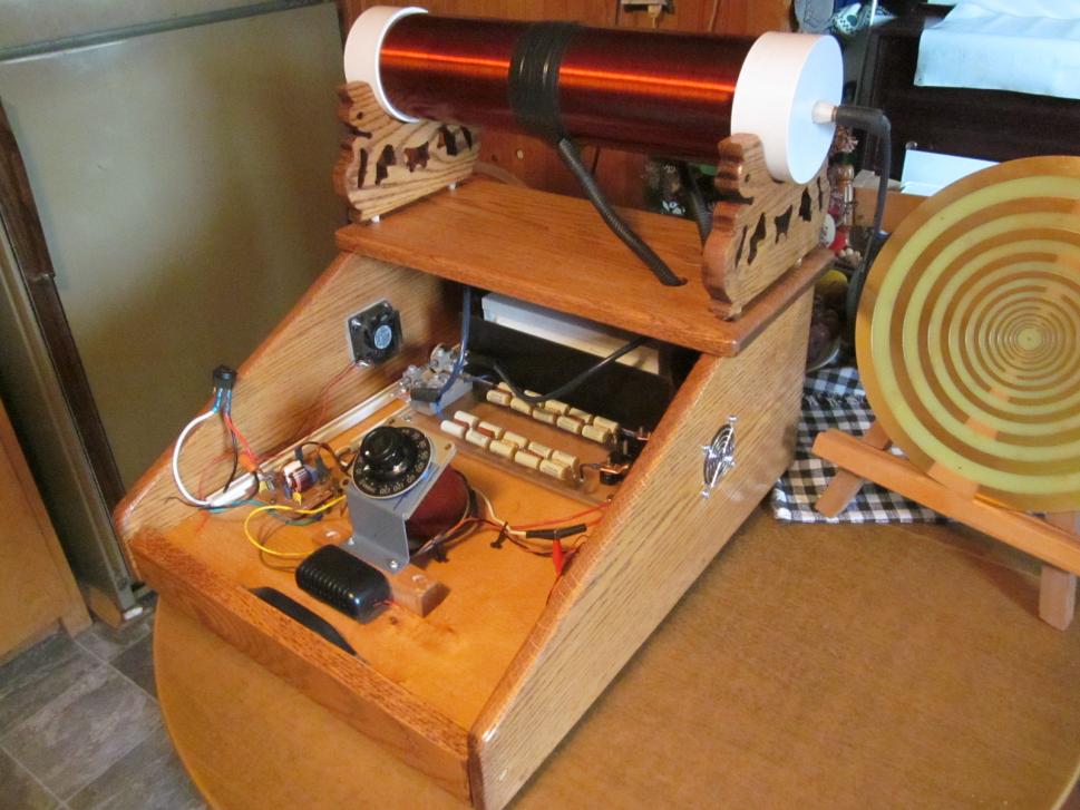

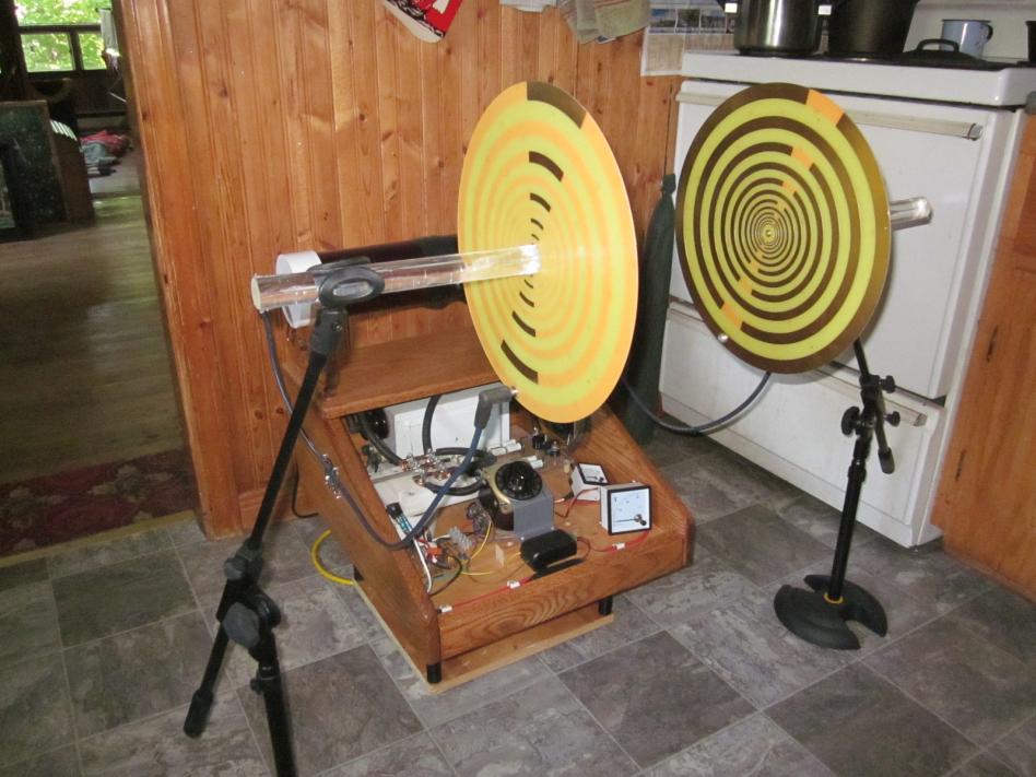

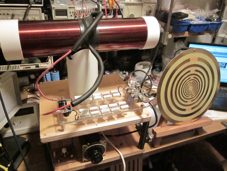

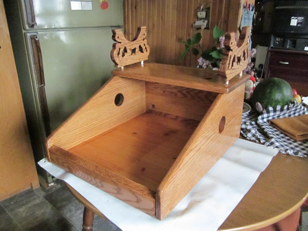

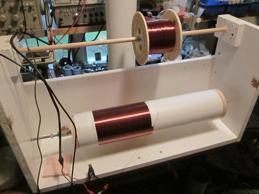

I'm continuing to work on my version of MWO and after a "woodworking day" back at the bench. Hopefully, I should have all wiring done today. Spark gap will be improved in time into multiple with micrometric screw allowing precise tuning and its electrodes replaced with either brass or tungsten rods, depending on $-factor.

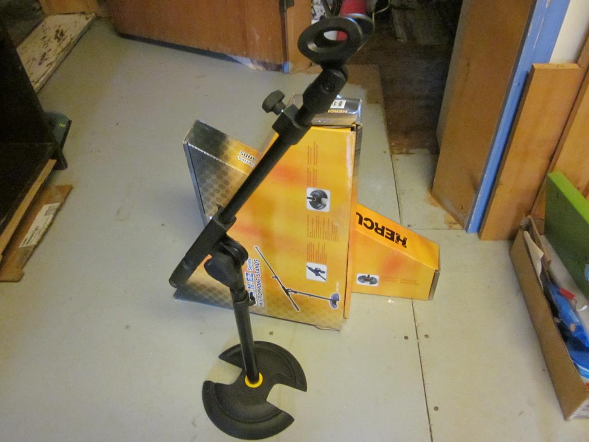

Below are pics of the main enclosure (first coat of varnish drying) and mic stand which will hold the antennas.
There will be another part between the antenna and mic holder made from dielectric material to separate further from the metal part (boom).
2B continued..
Vtech

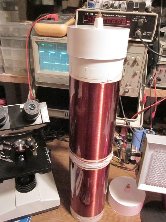

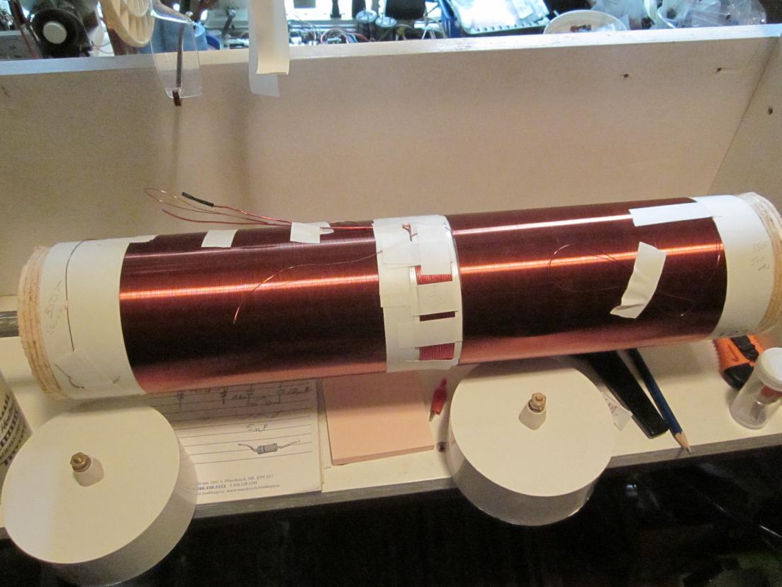

More from my bench progress on MWO. Still waiting for analog meters, top cover and redesigning spark gap from single to multi - point. TC could be made smaller than mine but I only had AWG 26 wire and had to calculate accordingly. Thicker secondary, such as AWG 23 will allow much less winding for the same resonant frequency.
2B continued

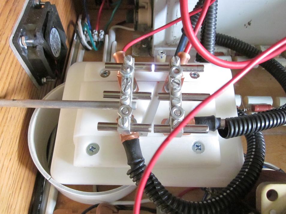

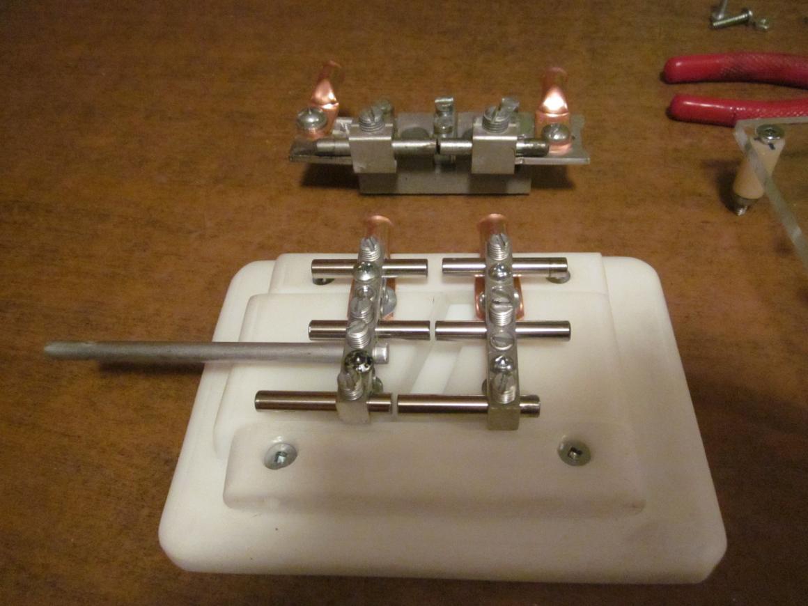

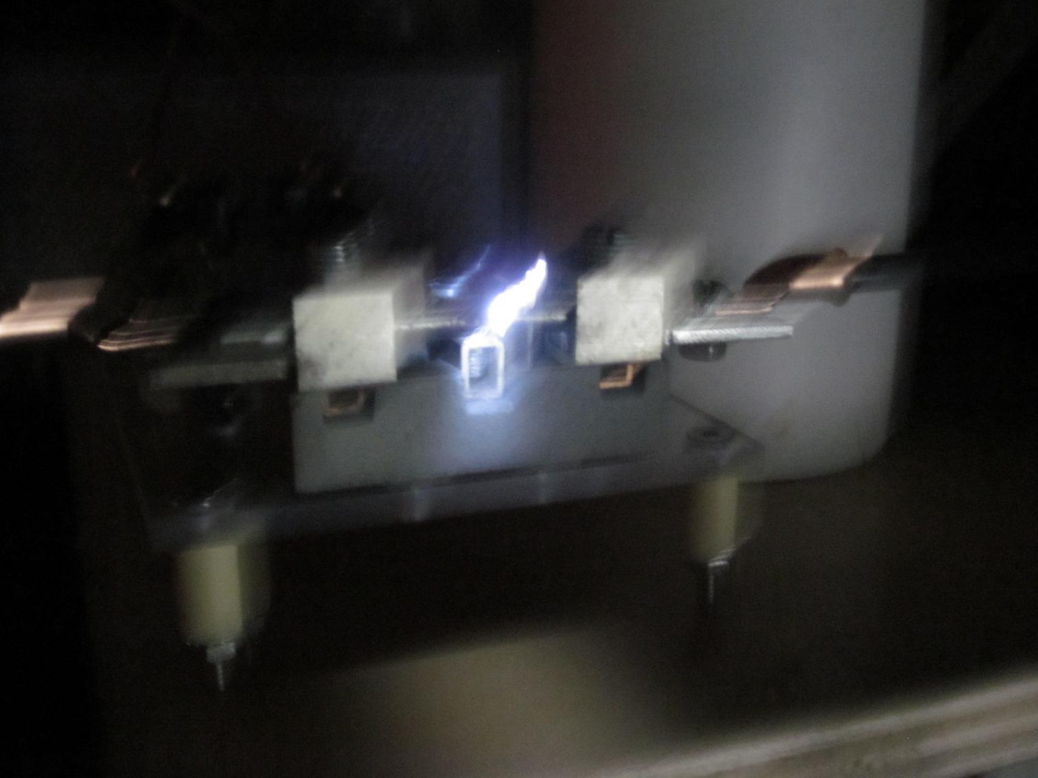

late evening update - new parallel spark gap. Third set of electrodes spaced further apart will serve as a safety gap to protect the transformer.

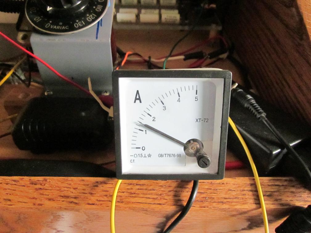

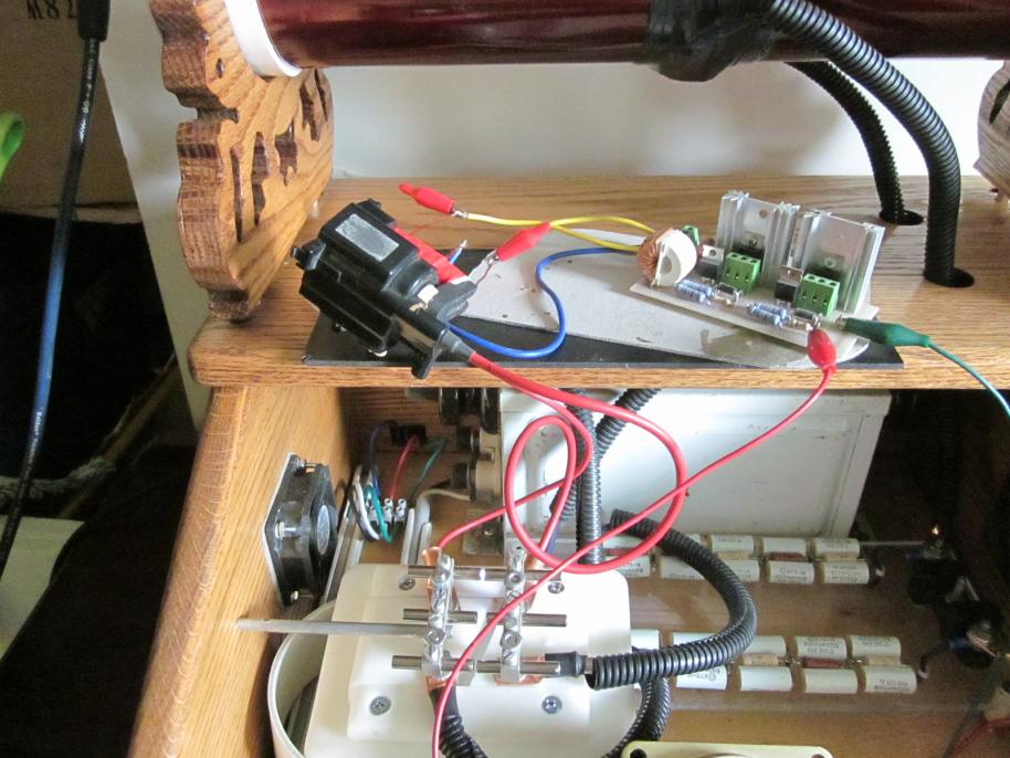

I've been experimenting today with different way of supplying high voltage to the capacitor bank. While NST works fine, it is quite expensive and costly in shipping. I decided to try ZVS circuit (same as used in Negative Ion device) and built one this morning. I modified salvaged flyback transformer from tv by winding primary of 10T of AWG#18 with center tap.
I had it running couple times at 15 -30 min sessions and everything seems to work fine. Mosfets are barely warmer than my hand. I'm powering ZVS from 12VDC adapter and power draw is about 1.25A.
Couple pictures below.
