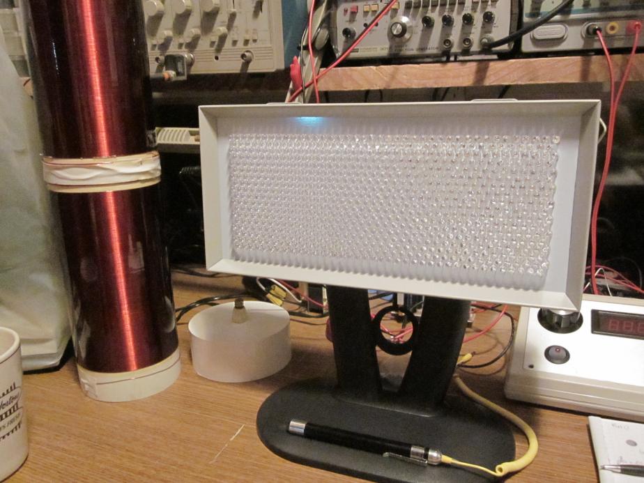

        I don't know if that's exactly what you're looking for. My main unit is switched by Mosfet off the oscillator 4047 and 16V DC source. Panel has internal limiting resistor so my only concern was not to exceed amp. draw for it. CC is only used for stylus (1W LED) and fed from the main Mosfet, not from DC positive.
        And one of planned setups for 711 LED panel - Click image for larger version
ID:	45609 Control box can be seen on the right. Big coil on the left is for MWO and doesn't belong to this device.

            Thanks nte, The case was suppose to be hand held and yellow so I got some yellow coiled cords. Since the idea has been changed I should also replace that cord with perhaps a black one as well as spray paint the panel frame to make it look better.
            Stand is from Dell computer monitor. I found it on FleeBay, brand new. It allows tilting approx. 15deg up which is enough to point towards face from table top.
            MWO is a Multiwave Oscillator, based on George Lakhovsky and Tesla work.

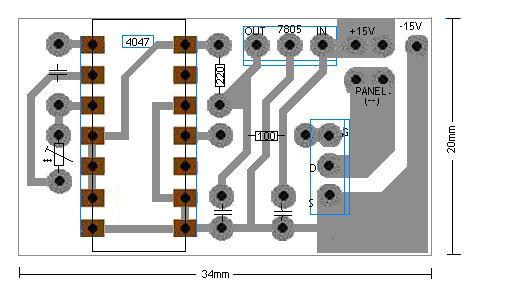

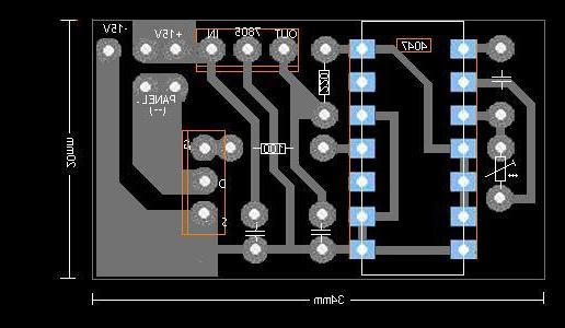

                  This is my basic pcb for RLT. It can be used with 12V LED panel and resistance adjusted to one particular frequency or with switch and multiple resistor/trimpot combination for all seven frequencies. Mosfet can be of any N-type, preferably low DSR.
                  Vtech
Name:	Single Freq. RLT copper.JPG
ID:	45622Click image for larger version
Name:	Single Freq. RLT Components.JPG

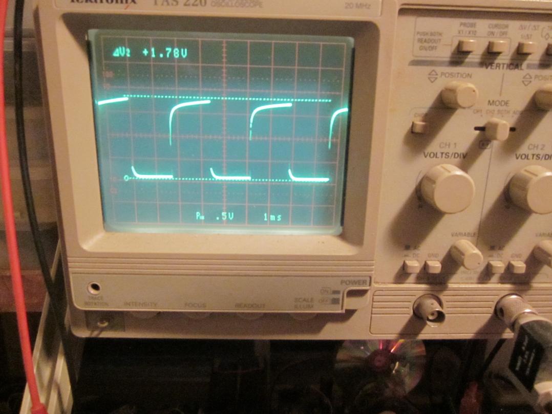

                    LED Driver - Variable Constant Current Source with Current Limiting
                    This is the Constant Current Source circuit from above with the addition of two components.
                    This circuit will allow you to adjust the current flow up to a set limit.
                    • 10k Potentiometer to adjust brightness
                    • 22k Resistor to prevent the MOSFET's gate from floating
                    I tested this circuit with the following parts. The current limit is 300ma @ 50% duty cycle
                    The frequency output still needs to be verified with a meter/scope.
                    • IRF540 MOSFET
                    • 2N3904 Transistor
                    • 10K Potentiometer
                    • 0.82ohm 2watt resistor (This is the resistor that limits the current draw)
                    • 150ohm 0.25 watt resistor - Potentiometer Wiper to Gate.
                    • 22k ohm 0.25 watt resistor (will probably replace with 10k) - Gate to ground.
                    The yellow wire connects to the frequency generator's output.

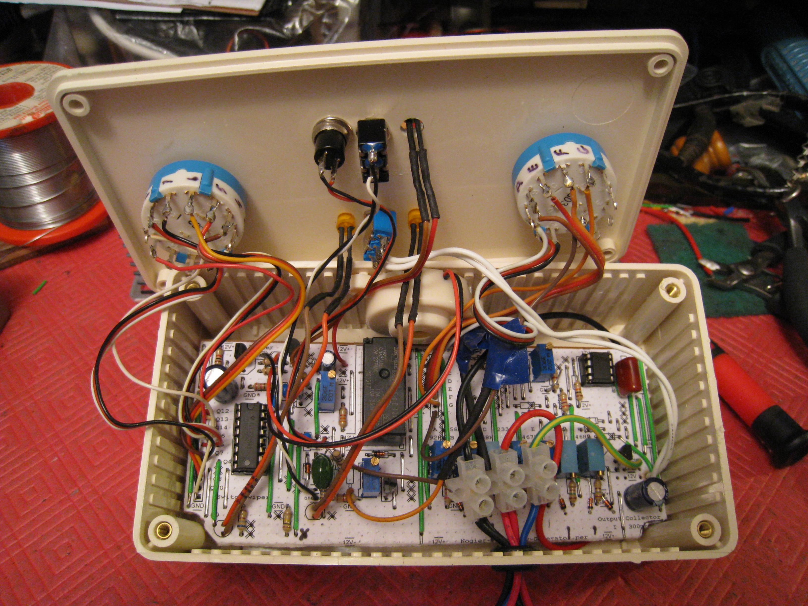

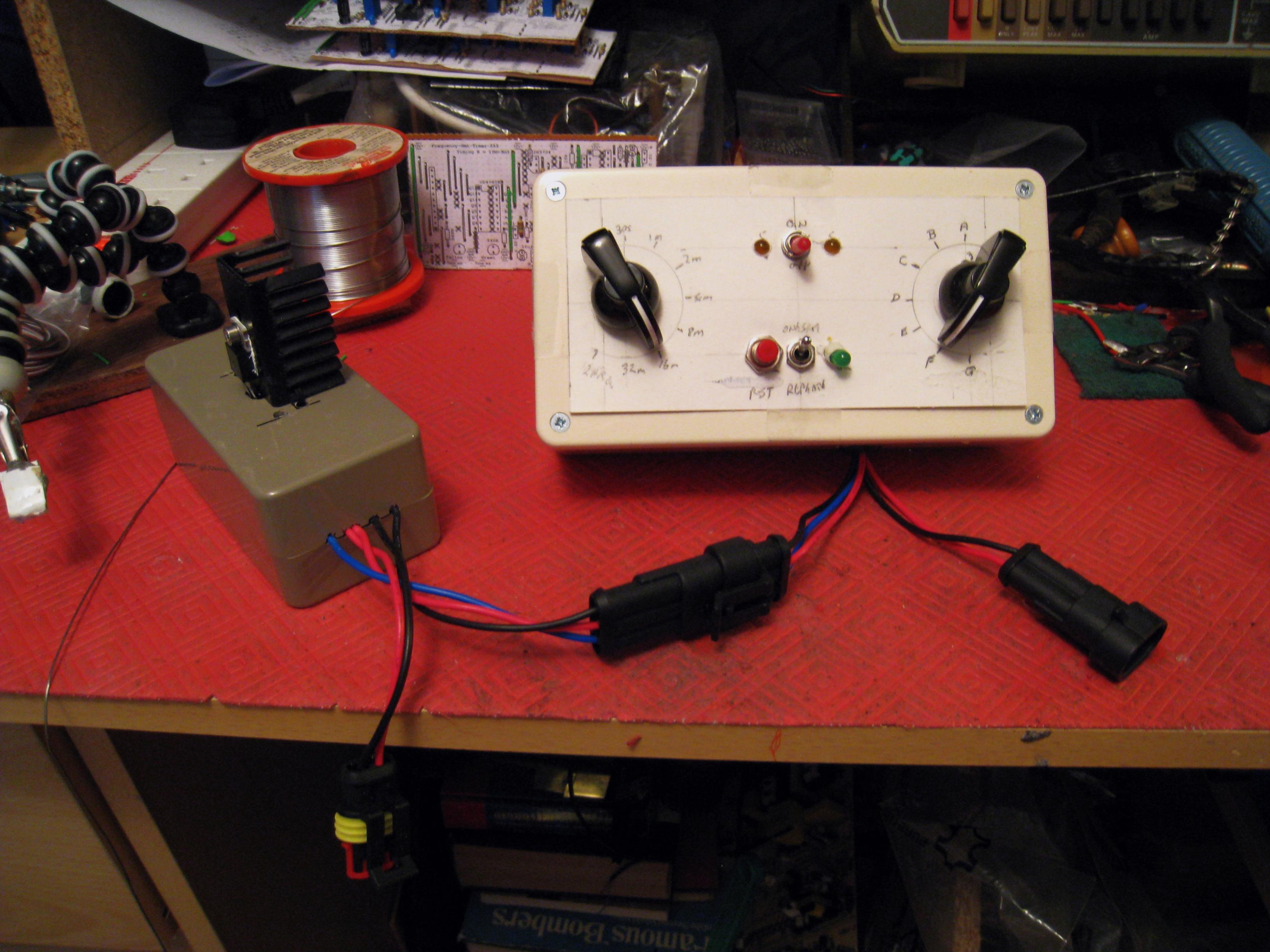

                              • Ok, lets see if we can get all this to work!
                                These first pics are the prototype I built with only the 7 Nogier frequencies. Everything was on one board and a lot of the circuit happened as I thought of it. (Nice way of saying "chicken crossing the road"
                                This all made it very difficult to overcome the faults that were certain to appear!
                                The plug on the right is power (12V) in and the plug from the driver box is the output to the LED device
                                Dave
