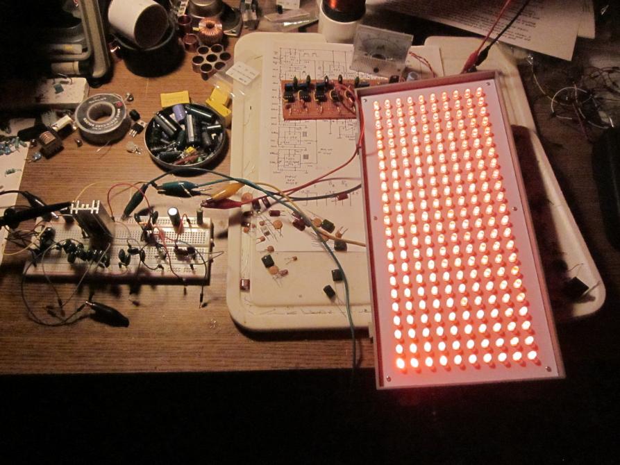

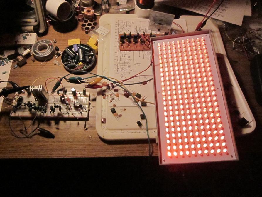

What I was thinking is to replace a field, say 6x8 LED in the center with IR's from other panel. If I could afford I would buy all these IR panels. He also has heatsinks, power supplies etc.
Vtech

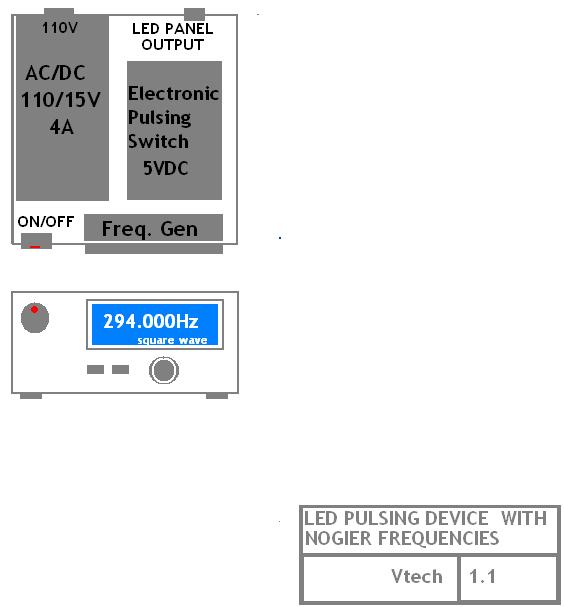

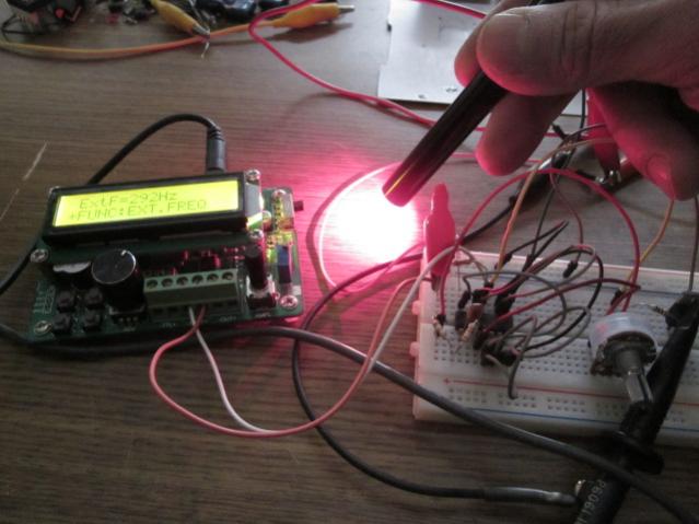

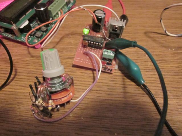

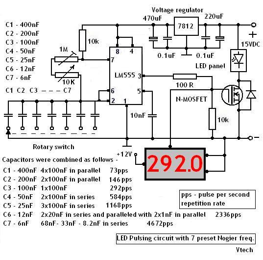

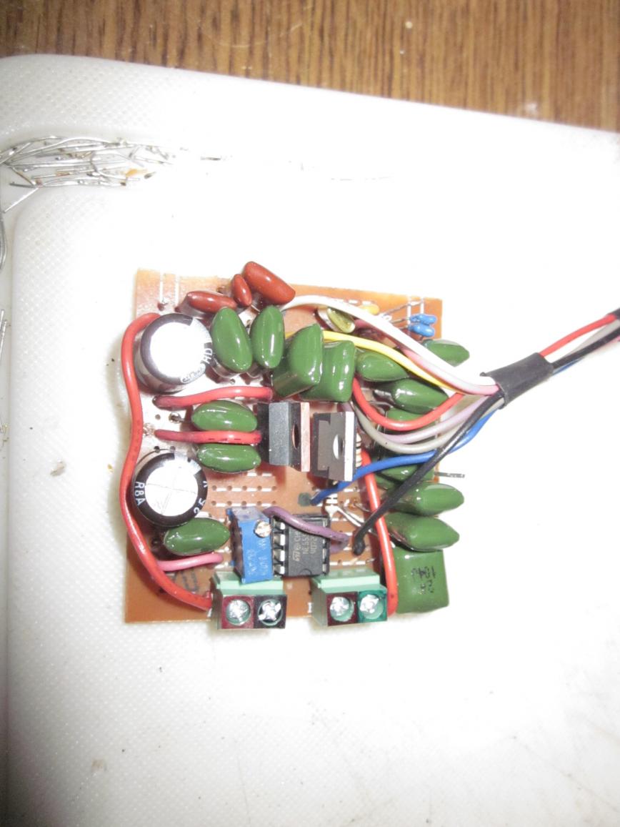

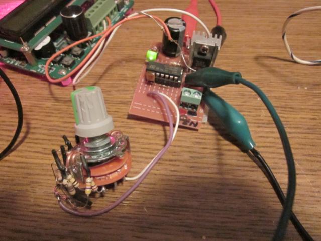

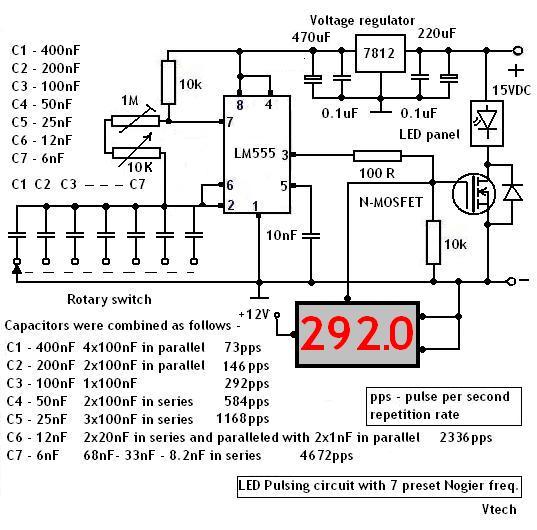

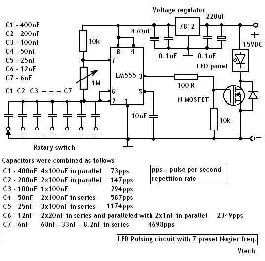

, just teasing. I've been testing my LED pulser and rehomed to pcb last night. Everything works fine. I ordered 15V4A Toshiba laptop power supply which has the same jack as my LED panel (6.3mmx3mm) and found small rotary 7 position switch which is in the mail. Everything should fit nicely inside the panel when done. -

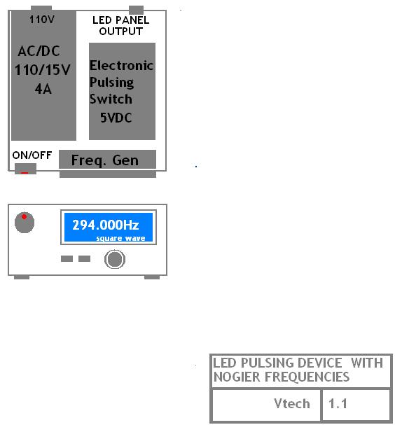

Photos below are IR 140 LED panel and my pulser idea.
If I could use 4017 decade counter with 4093 NAND gates......I could (perhaps) run the clock input from another slow astable multivibrator. Each pulse will cause to switch between seven outputs of 4017. There is also an option to leave it on one of them on by using EN/RESET inputs.
