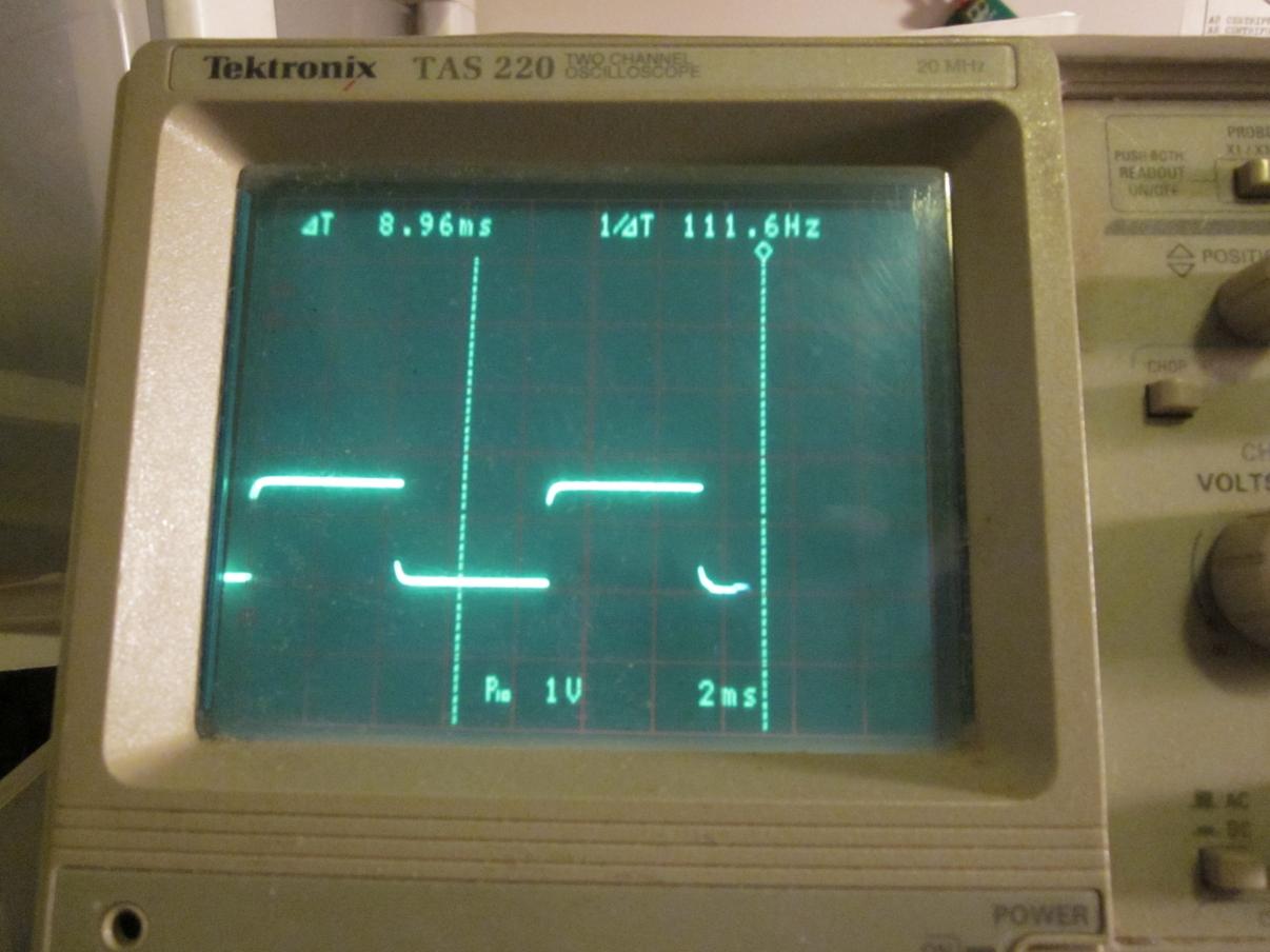

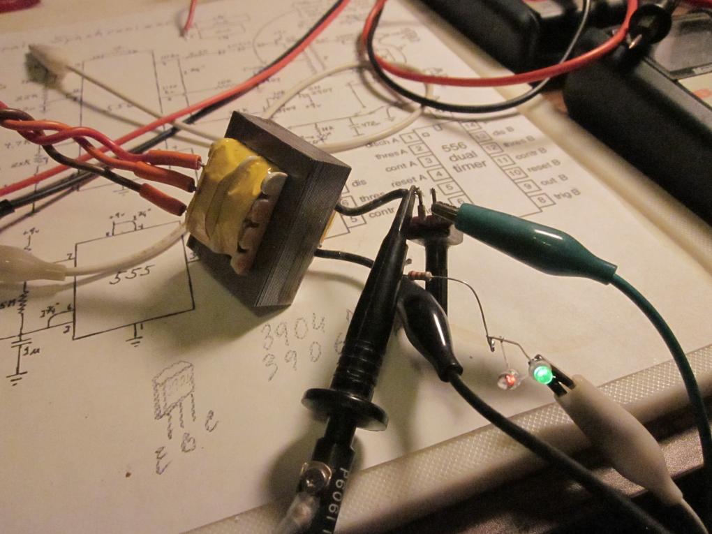

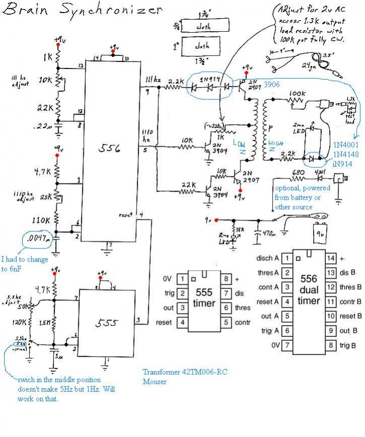

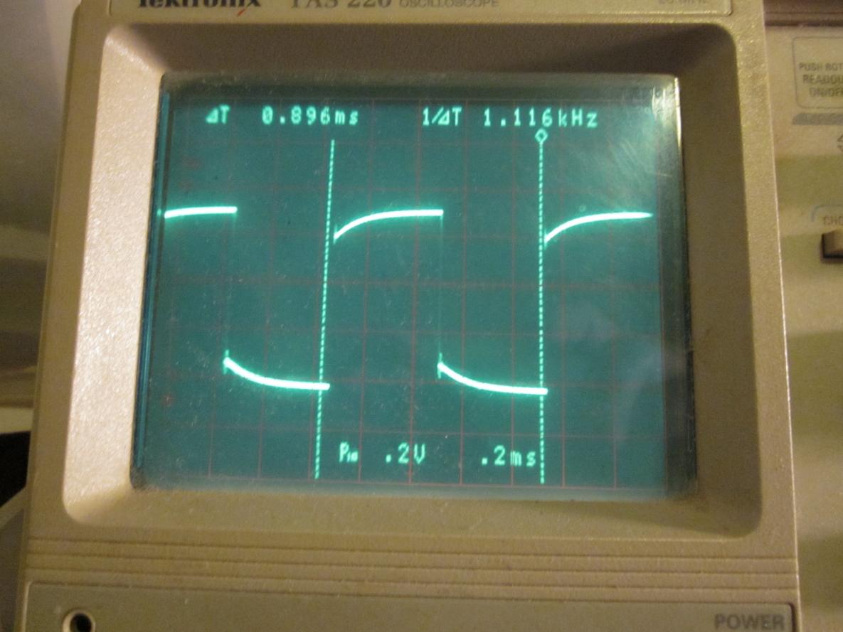

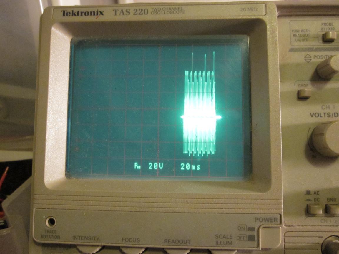

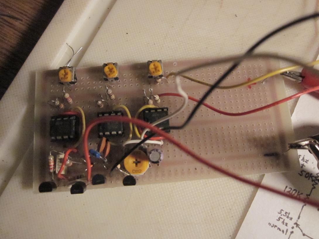

              It looks like I've got Brain Synchronizer running. I used three IC555 and had to change cap value from 47nF to 6nF in second oscillator to get 1.110kHz. It was going way too slow. I used 3904 and 3906 instead of 2907. For transformer I tried 12V-110V with center tap on low side from wall wart. I will test further tomorrow. I was able to adjust 2V AC over 1.2kOhm load as per diagram. Below are pics of scope shots. It was difficult to grab the one from output and it shows only one segment. I didn't figure out switching at third oscillator. Diagram says - 5 and 5.5Hz. I'm getting phased 5 but in the second position I'm getting 1Hz. Will check later.

              • #67
                Hi guys. I found out about the transformer - 42TM006-RC Xicon | Mouser
                It should also work with John Bedini circuit. Will order few next week. I also noticed in one pdf that one of the diodes going to the output is regular fast signal 4148 or 914, not LED as I was thinking. I'm talking the output from the transformer and two diodes with reversed polarity.
Name:	Brain Tuner.jpg

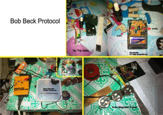

                                greeting everyone...sorry for the late response, i'm busy with my work... so this is my beck protocol that i promised to post... Click image for larger version
ID:	45055 (the finalizing device was awfull)
