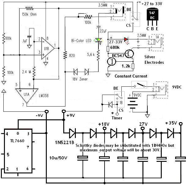

Mr.Algorythm the updated new schematic pic is very hazy. The previous one was much more clear.Please make the new updated schematic pic clear as the previous one .

Mr.blackchisel Sir,I am having problem with the transformer,since I can't buy from internet I try to buy it from local market but they don't have it .so I was thinking if I have the specifications of it I may able to buy an matching audio transformer of another company.please tell me what specifications the audio transformer should have for the BT.
Sunshiner, the original 42TM006-RC is a miniature audio/signal transformer http://ca.mouser.com/ProductDetail/X...BSQFx7adpkk%3d.Originally posted by sunshiner434 View PostMr.blackchisel Sir,I am having problem with the transformer,since I can't buy from internet I try to buy it from local market but they don't have it .so I was thinking if I have the specifications of it I may able to buy an matching audio transformer of another company.please tell me what specifications the audio transformer should have for the BT.
The specs are:
- Primary Resistance: 900 Ohms
- Secondary Resistance: 70 Ohms
- Primary Impedance: 20 kOhms
- Secondary Impedance: 1 kOhms
- Frequency Range: 300 Hz to 3.4 kHz
VtechLast edited by blackchisel97; 05-11-2013, 02:31 PM.
