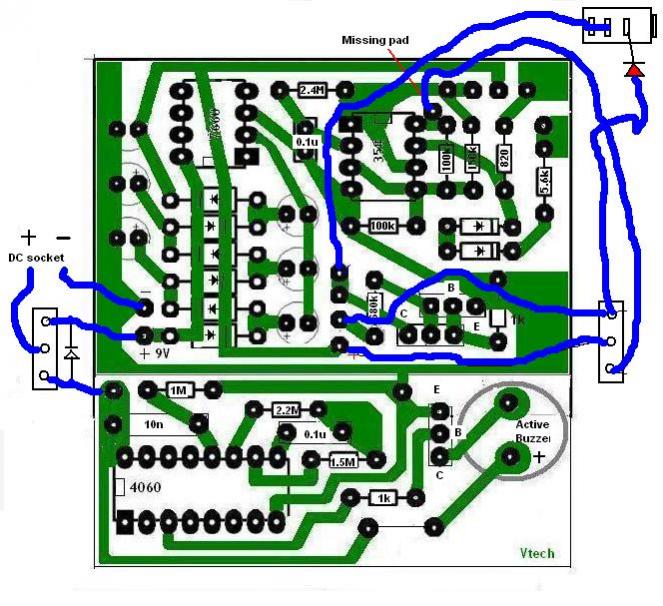

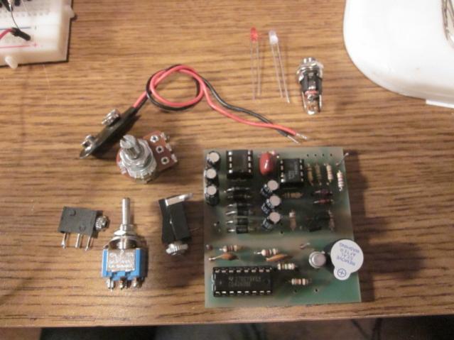

          • I assembled and tested couple boards and except one missing pad (for positive wire from switch to pin 8 of 358) everything works fine.
            Here is a parts list:
            IC's: - LM 358, TL7660, CD4060,
            Transistors: - 2x BC547, 1x 2N2222 or equivalent
            Zener Diodes: - 1N4746 (18V) x2
            Shottky Diodes: - 1N5819 x6
            LED's: bicolor x1, low power red x1. CD4060 has pin 7 for LED + 1k to "+" for timer monitor option but there is no pad on pcb.
            Optional diode 1N4001 for battery polarity reversal protection,
            There is also another 1N4001 diode which can be soldered on pcb or at the switch. It prevents timer from running when blood electrifier is selected - see the layout below.

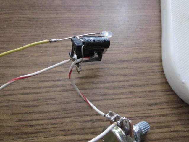

            Those sockets I got disconnect neg. and I had to change few of my first models. Later, I swapped output wires inside the adapter to have neg. in the center of a plug so the socket switch is disconnecting positive of a battery.
            22uF capacitor can be soldered directly at 3.5mm socket and connect to bicolor LED. This save running extra wires to the board. One terminal of potentiometer is also connected directly to the socket on the front panel.
            PCB below is the earlier version but layout of components is the same.

            I can provide either bare or populated and tested pcb's with remaining electronic components to be assembled. The cost of bare pcb is $25 (shipping included) and populated/tested pcb + pot, 22uF cap, led's and sockets $80.

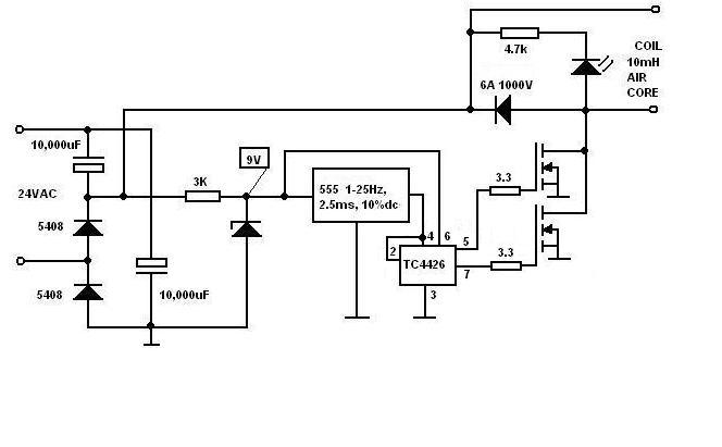

                I decide on different approach by stepping 110VAC mains down to 24VAC by means of transformer and using voltage doubler to step voltage up. I measured 67VDC on main storage bank (20,000uF). This way I was able to separate entirely from mains and operate in much safer range.
                My prototype pulse oscillator is based on LM555 with variable pulse (from 1-30pps) running at 10% duty cycle and the pulse width of 2.5ms.
                Challenging part appears to be the switch capable of discharging into 8-10mH aircoil. I got it running with SCR but he is latching even with snubber attached. Few hundred uF isn't a problem but increasing capacitor bank over 1000uF doesn't work.
                I will order some Mosfets and try to bridge 4 in parallel. I'm also thinking of using gate drivers to assure they're switching well. Seems like another delay and waiting for parts. I also need at least 150W toroidal transformer (the one I have is 40W and it gets warm at higher pulsing rate, even with small capacitors) and figure out how to wind such coil so it will fit inside the handset which I already have. They have beautiful air inductors at Allparts but they're about 3" in dia. Too much for me.
                Will update when I solve all of the above issues.

                    • This is a prototype of Magnetic Pulser I'm working on. Gate driver has two separate units which have joined inputs 2&4. The outputs 5,7 can drive two Mosfets. I'm thinking of adding one more driver so I can run 4 Mosfets in parallel. I got couple IRF640 running a.t.m but they need to be replaced for something better, perhaps STPNF10. I'm testing with 30V power supply without a voltage doubler but it should run from 24VAC as per schematics. LM555 based oscillator runs fine and provides what's needed. I have full range from 1 to 28Hz at my disposal but Mosfets will need heatsinks with faster pulse.
                      More testing ahead. Will post an update.
