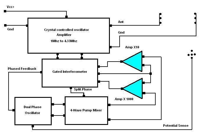

          Also, the interferometer oscillator diagram on johns website depicts "potential sense". can someone clarify what this does?

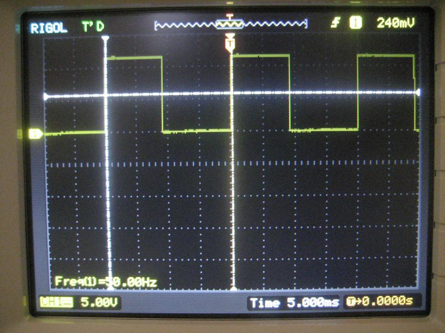

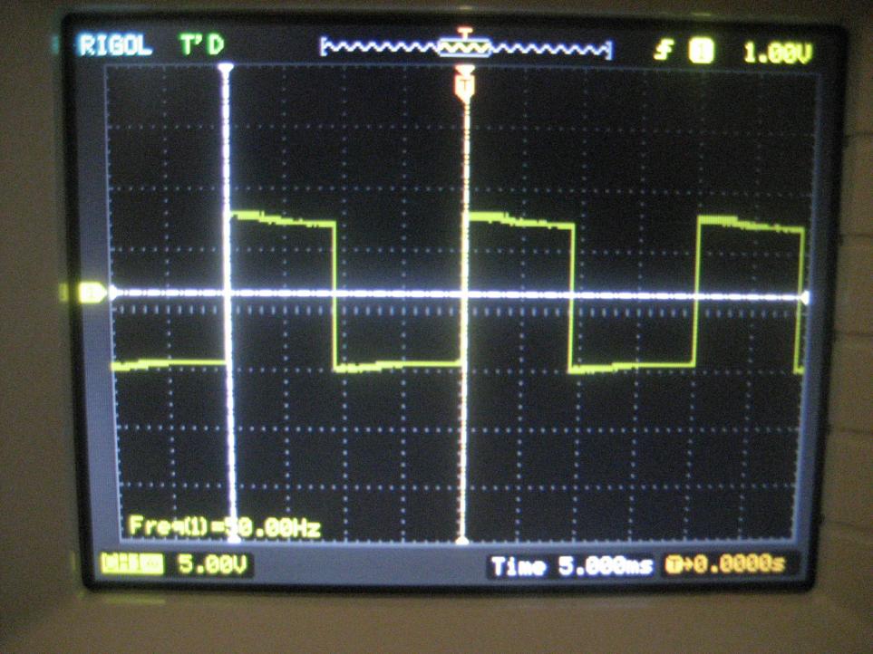

                      I set up the first 555 chip on a breadboard and tested it with the scope. I'm wondering if this square wave is bad. It's not perfectly square.
Name:	First 555 (150ohm, 22Kvr, 0.22uFcap - 50Hz)_small.jpg
                      If this square wave is bad, does anyone know what would cause it to look like this?
                      This is using the 150 ohm resistor, 220K variable resistor, .22uF cap and running at 50CPS (Hz) as per John's schematic and first post in this thread. Oh, and 8x AA batteries powering it.
                      I'm pretty new to electronics so please don't be too harsh.
                      Edit: I think it was because my scope had the "Coupling" set to AC. When I switched it to DC it looked more square:
Name:	First 555 (150ohm, 22Kvr, 0.22uFcap - 50Hz) Set Coupling to DC on scope_small.jpg
                      Mike
                      Last edited by TheGooch; 09-16-2012, 02:21 PM. Reason: I think I figured out the problem.

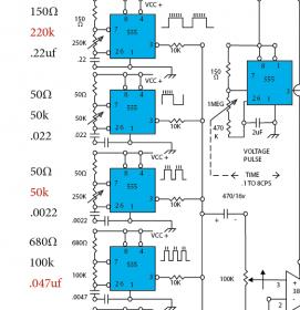

                            hello all and John,
                            I just wanted to verify the resistor values for the device, as the quotes above, and the circuit diagram have a few conflicting numbers. It may be that I transcribed them wrong, but a second opinion would be appreciated.
                            Jay
