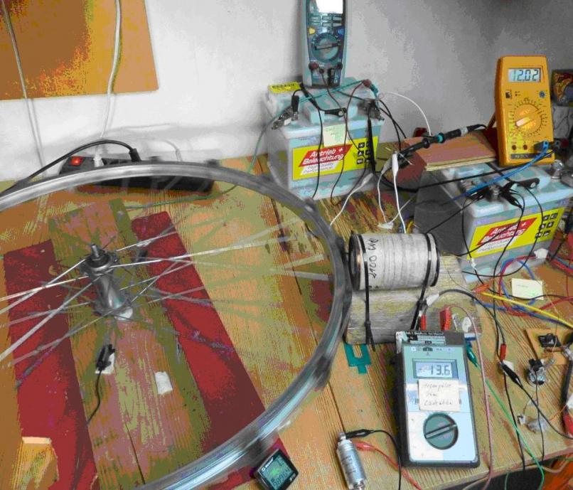

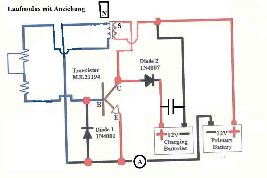

ID:	45502Click image for larger version
        your coil is too small for those batteries, and the resistance is too hi. 1.2 to 1.5 ohms max 130 to 150 feet of wire
        you need to make your wheel vertical, those bearings are not designed to run the way you have it configured
        use mjl 21194
        you cannot swap batteries back to front without a cap pulser circuit. a parallel capacitor is not the same thing.
        buy the SG book from here it will expalin everything and you will get much better charging, you have many things not correct. just because it spins does not mean it is working correctly.

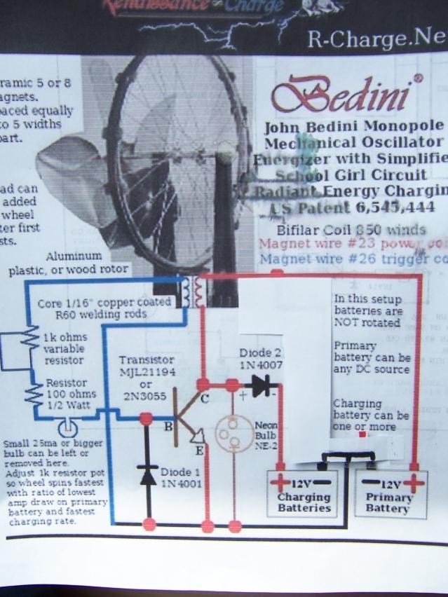

          Hello Tom,Click image for larger version
            Originally posted by Werner View Post
            Hello Tom,[ATTACH=CONFIG]1844[/ATTACH]
            I do not measure charge current going to the battery, I only measure the primary current draw. a 7 strand SG with 20 gauge power and a 23 trigger will pull around 125 milliamps per strand or around 1 amp on the primary.
            charging battery times vary, I cannot give you a number, I have seem 10 amp hour batteries charge in 3 hours with only 1 amp on the primary.
            always run a multi strand coil if you can.
            your charge current is controlled by your base resistance, not your coil length, increase the base resistance your primary current draw will go down. as your transistor will be on for a much shorter time.
