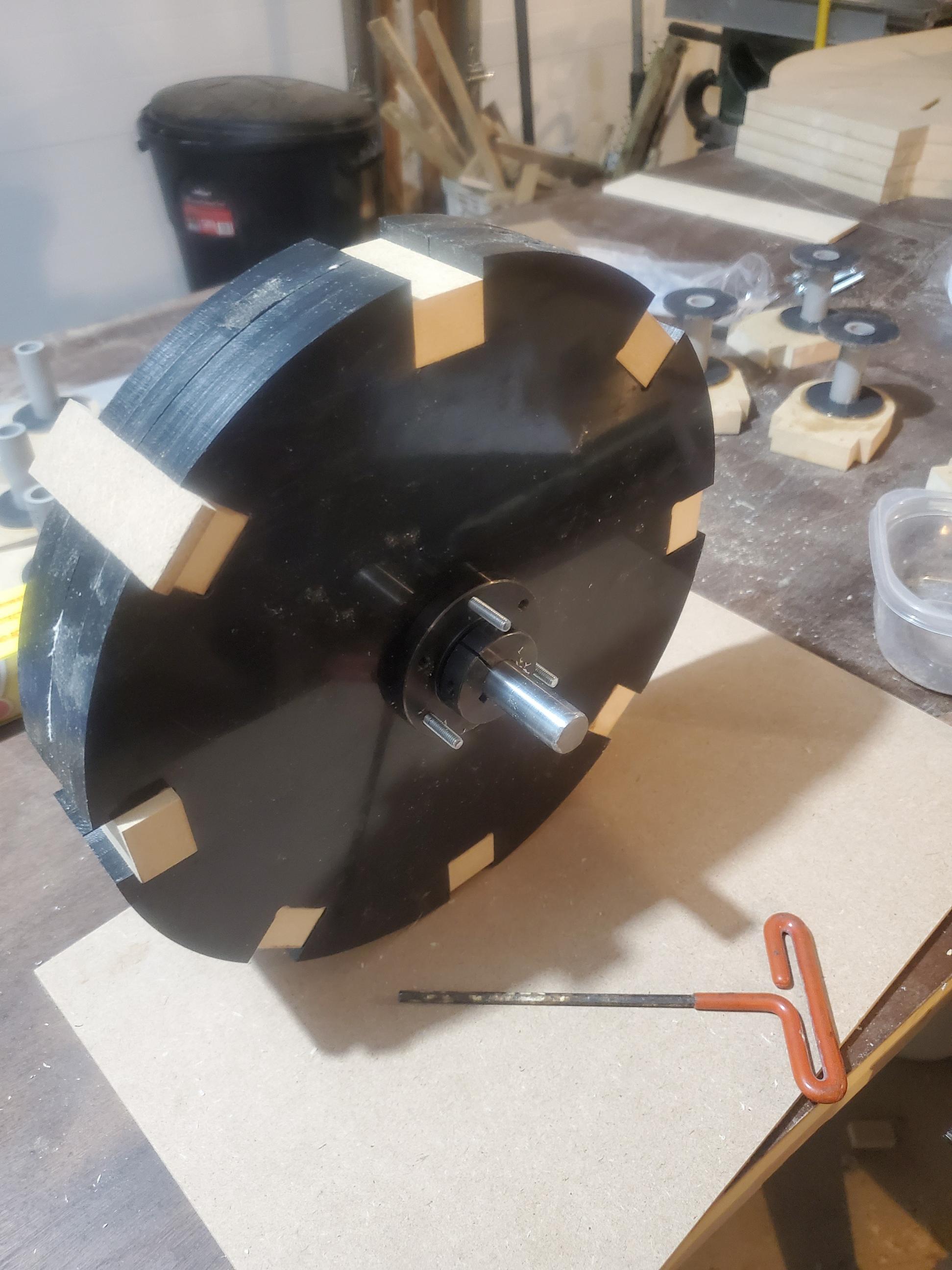

                  Got a lot done today. My 16yr old boy helped and we routed the second set of 4 piece rotor.
                  1/2" HDPE. Mock up pic attached.

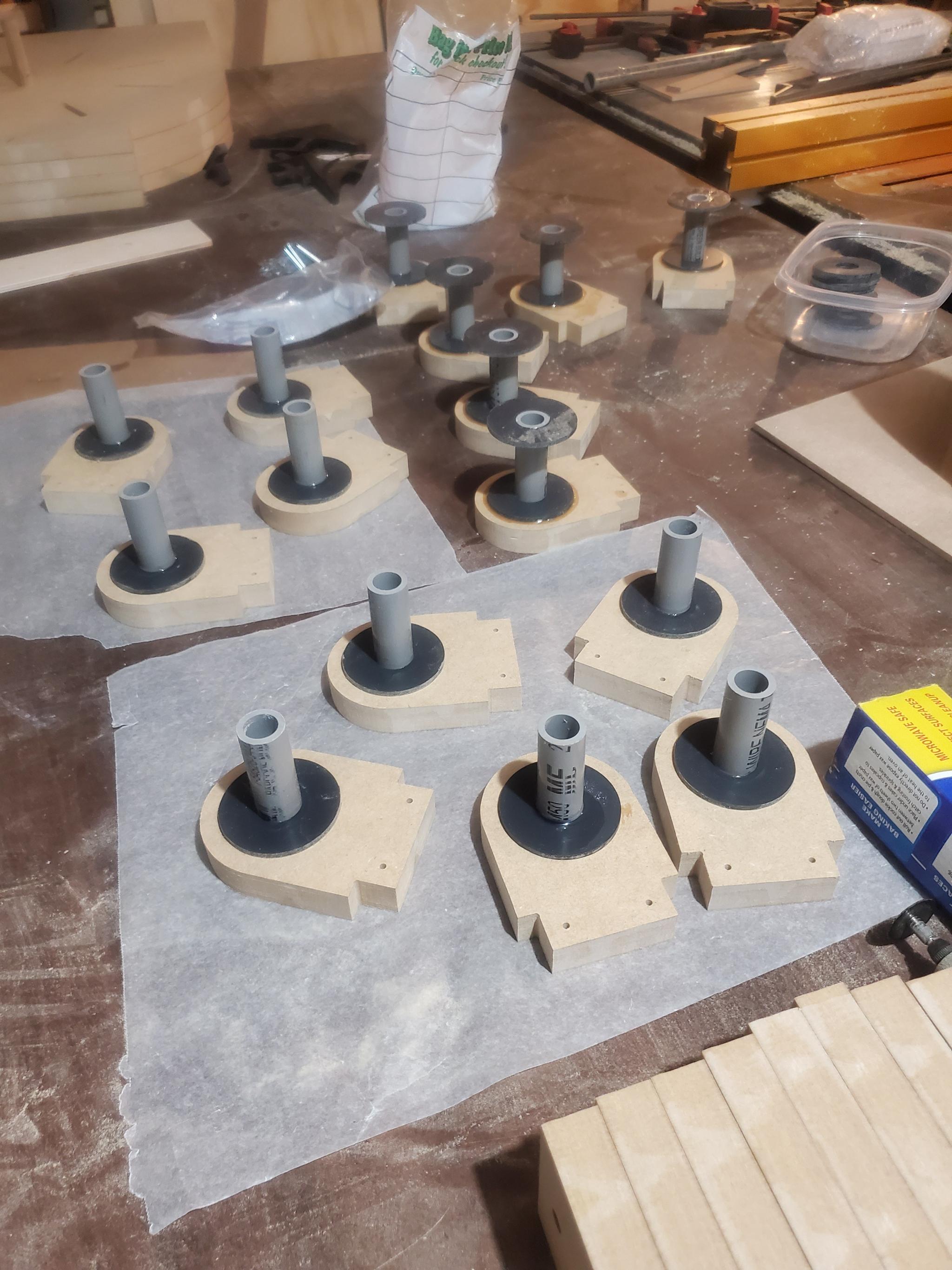

                  Have all the coil holder parts cut out and will have those done soon. Pic attached.
                  I made spools with pvc and super glue. The holders are similar to ones that TC made for sale, but these spools are smaller.
                  Single strand #22 wire.

                      I have glued the spacers and mags in the rotors with HDPE special glue.
                      Will assemble tomorrow.

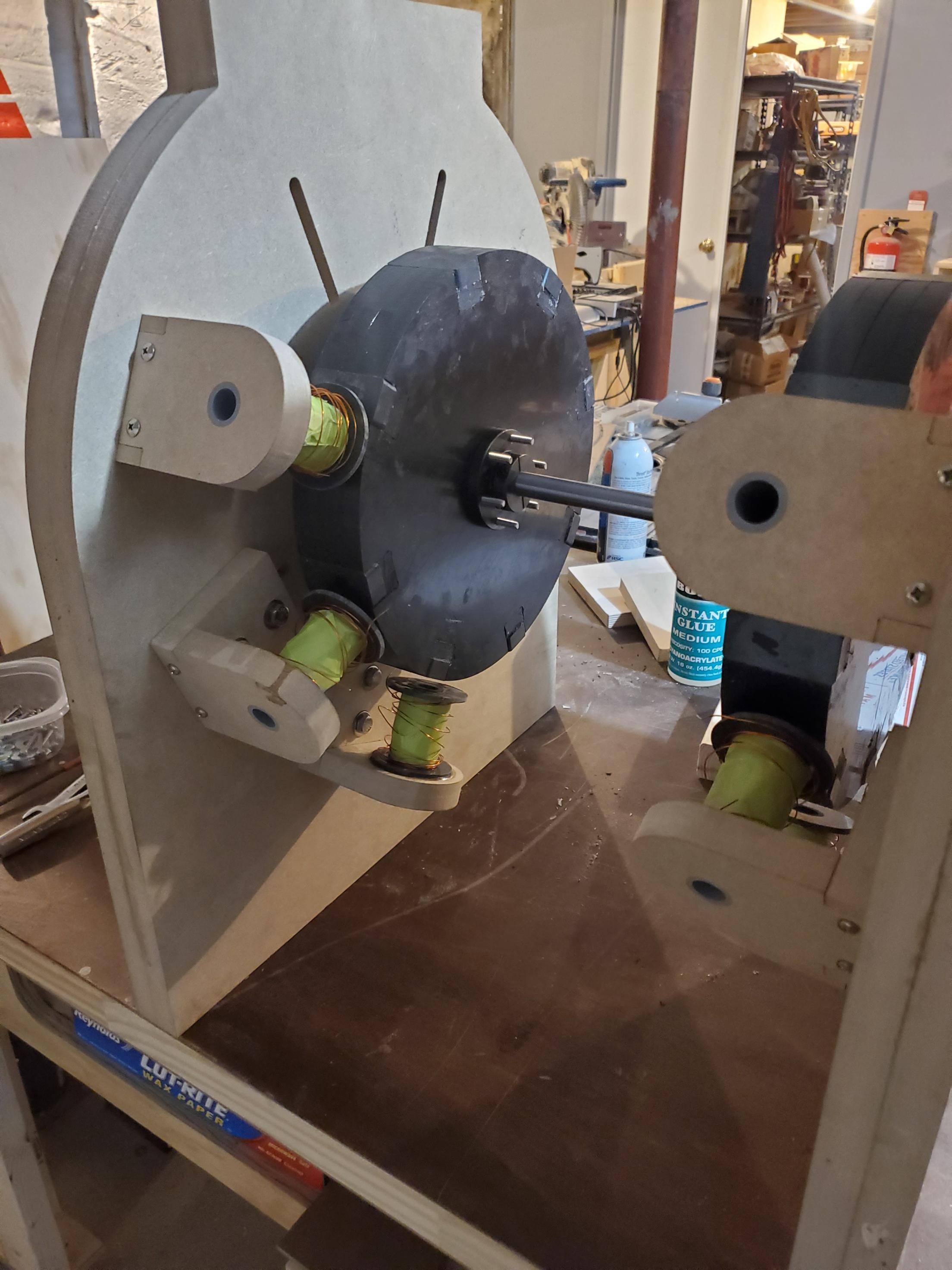

                        Rotors spin nice. 5/8" shaft, slight balance issues.
                        The big ears on top the frame ends will accommodate a 2 x 10 for bracing.
                        Plenty of room under the rotors for "electronical" stuff.
                        The coil holders are all done and ready to wind.
                        I have a 60A, arduino based, 2 bank battery swapper ready to hook up.
                        Plenty to do.

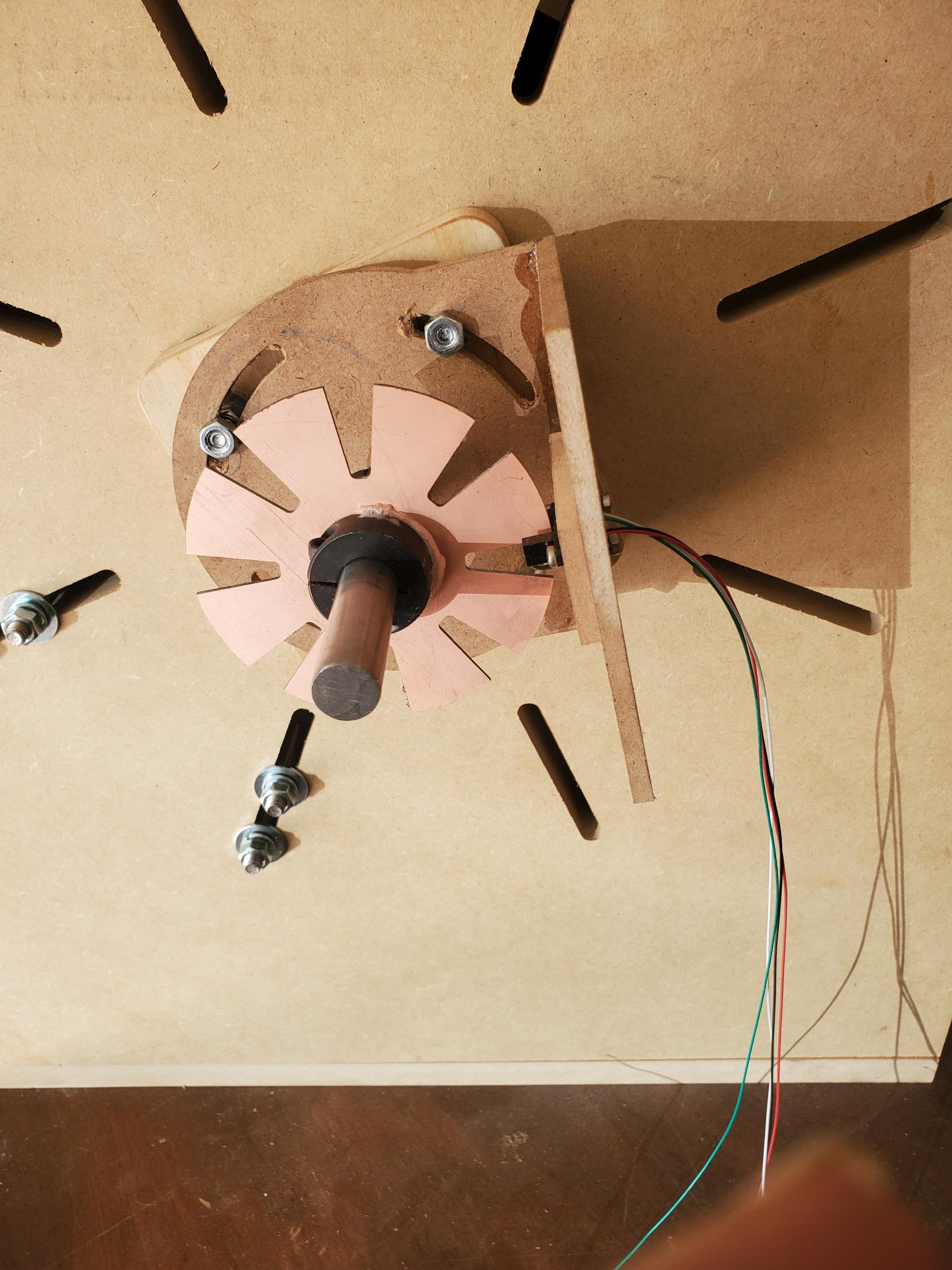

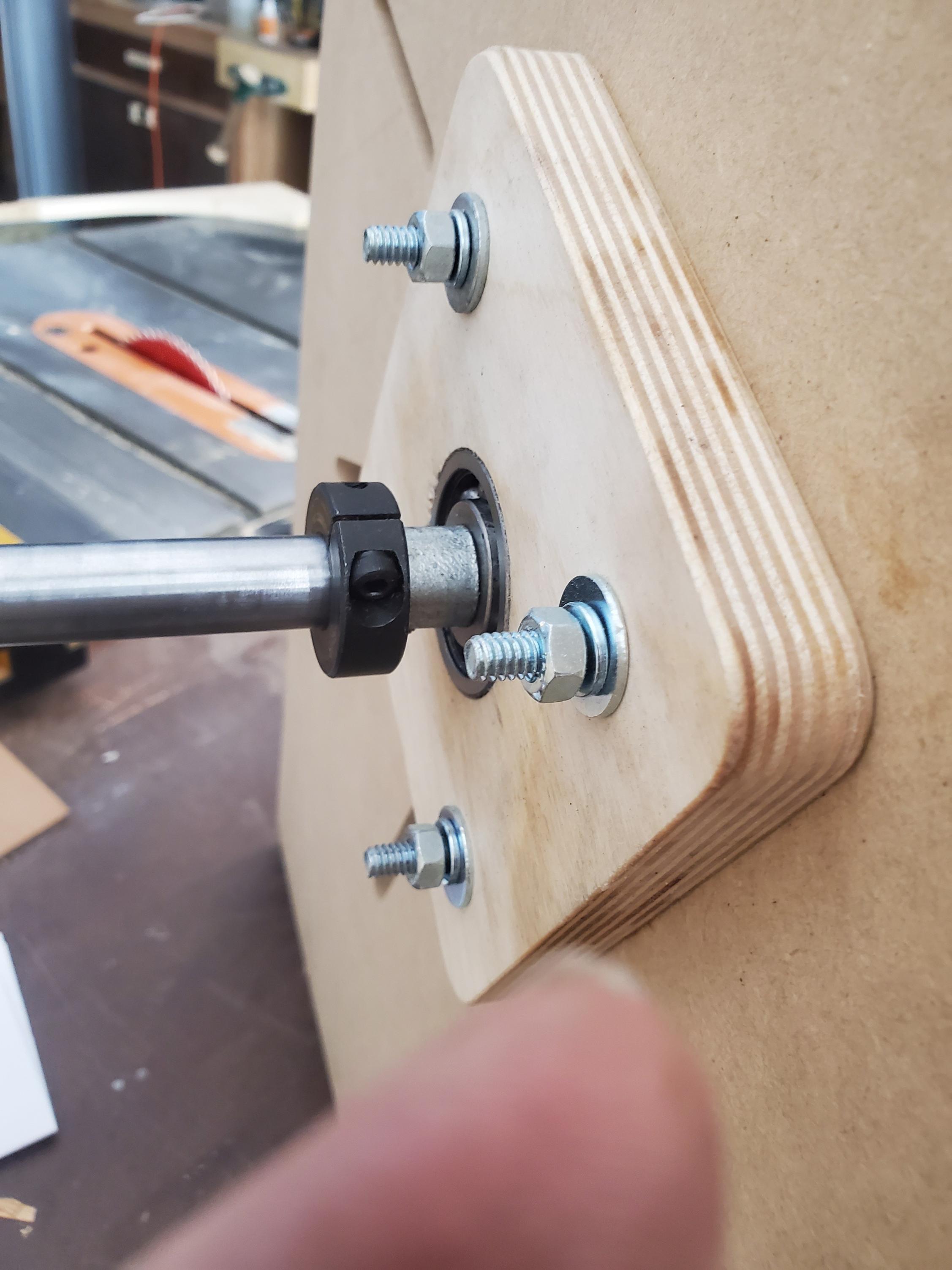

                              Made adjustable opto sw holder. Can adjust trg wheel with screw on collar and also opto sw location on the fly.
                              Made spacers to hold collars against bearings so shaft won't move horizontally.
                              Had to bore out a tube. Very grateful for for mill drill lathe.
                              Have opto cct that tests well on a board so time to wire it up and get the smoke out of it.
                              bro d
