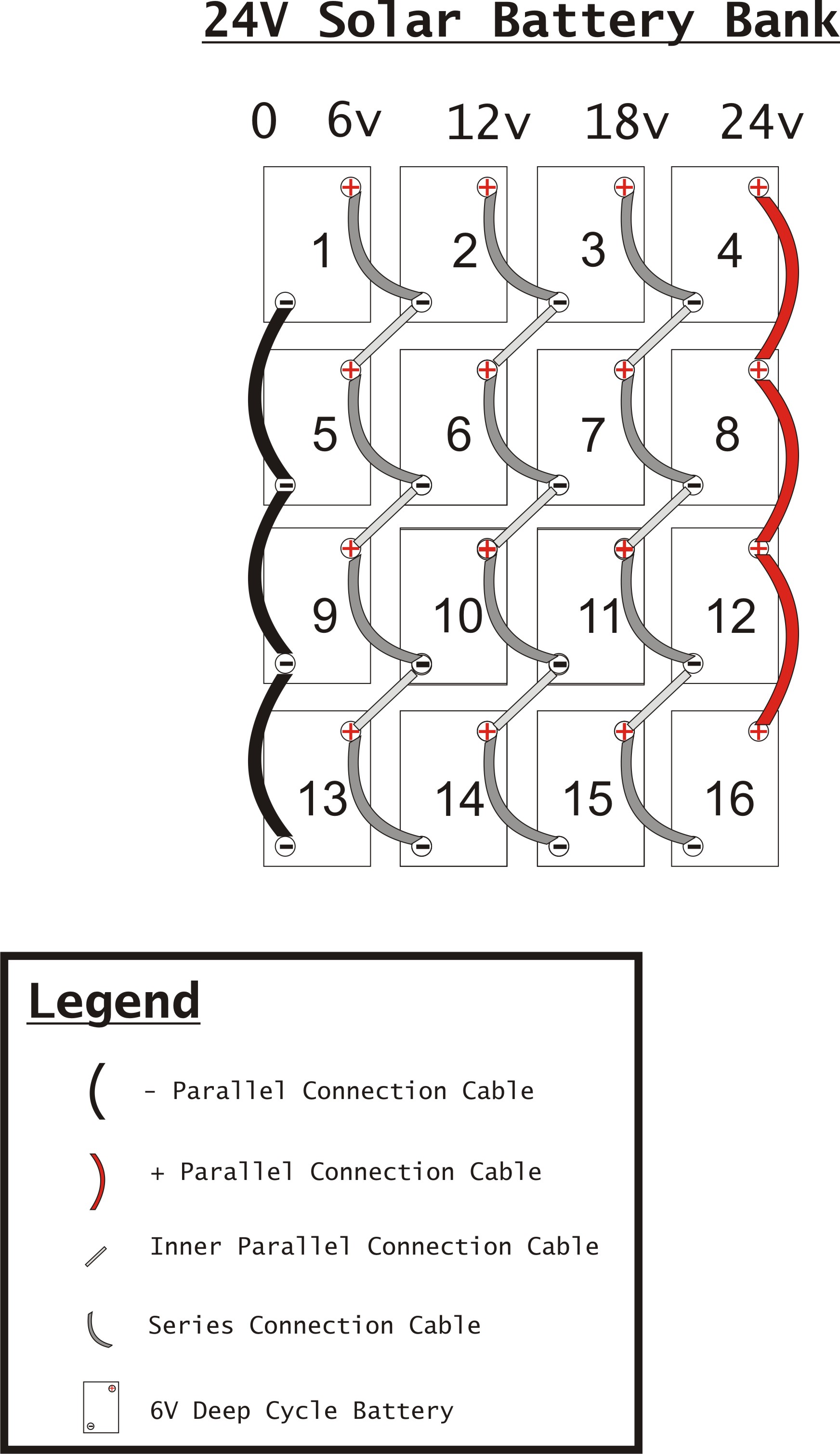

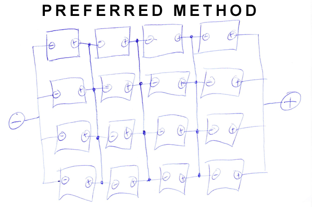

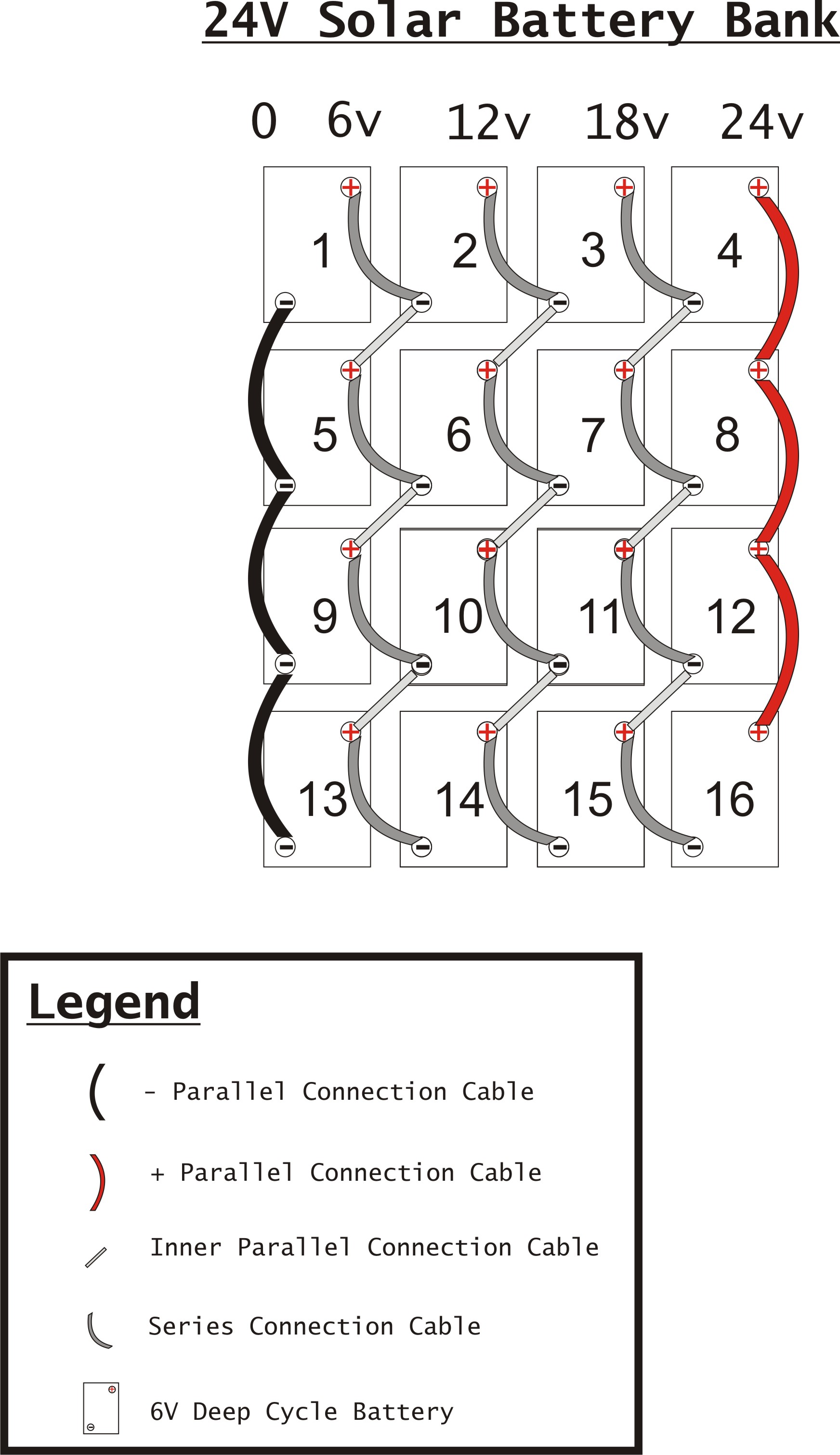

    Hello All,
    I am putting together our Off-Grid Cabin Solar Array System and wanted to reconfirm what I think I am reading in the "Solar Secretes" book.
    The book says to parallel connect the batteries at the 6v, 12v, and 18v, levels to build in battery equalization so none of the batteries fall behind or get ahead of the charging/discharging process.
    Please look at my diagram and tell me if I have this premiss correct.

    I only just saw this - that is not correct at first glance.
    Let me know if you see this and I'll show you.

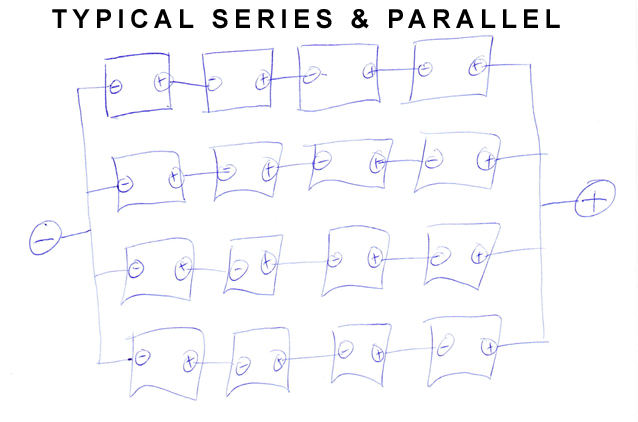

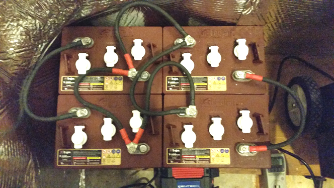

      In fact I remember reading on Hard wiring Equalization posted by you is it in one one the Bedini books series..?
        I apologize, you ARE correct! If you're tapping the neg and pos from the far left and right, then yes, that is it.

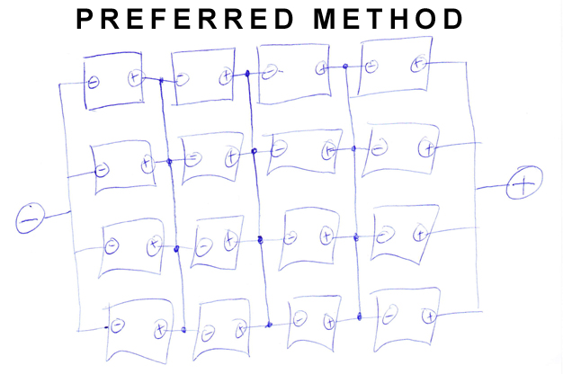

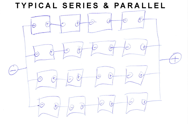

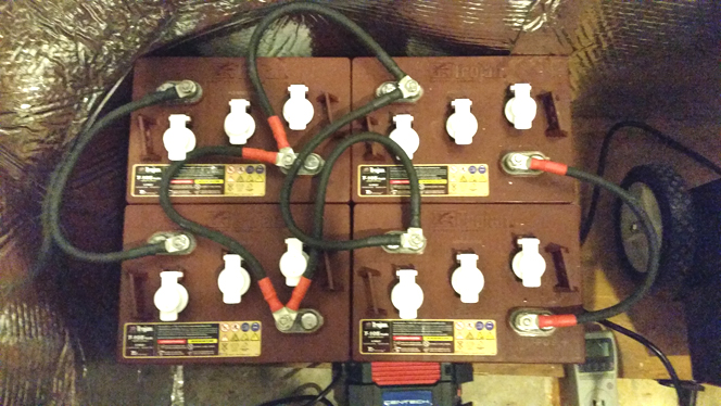

        The zig zagging got me confused for a moment. Here is a comparison with non-zig zagged terminals to show it - same thing but maybe easier to understand.
        That's a 450ah 12v bank of Trojan T105.
        Series and Parallel. Down the middle the cables might look confusing but is actually just common connecting the inner - and + of each series set. I did it redundant so resistance is same on each path since I didn't make a T. In any case, it's identical to the image directly above the photo with the common connection down the middle.
        I hope that helps.

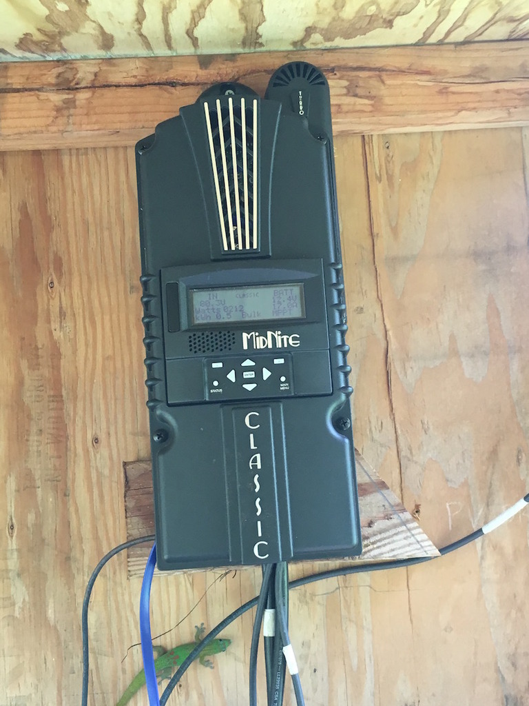

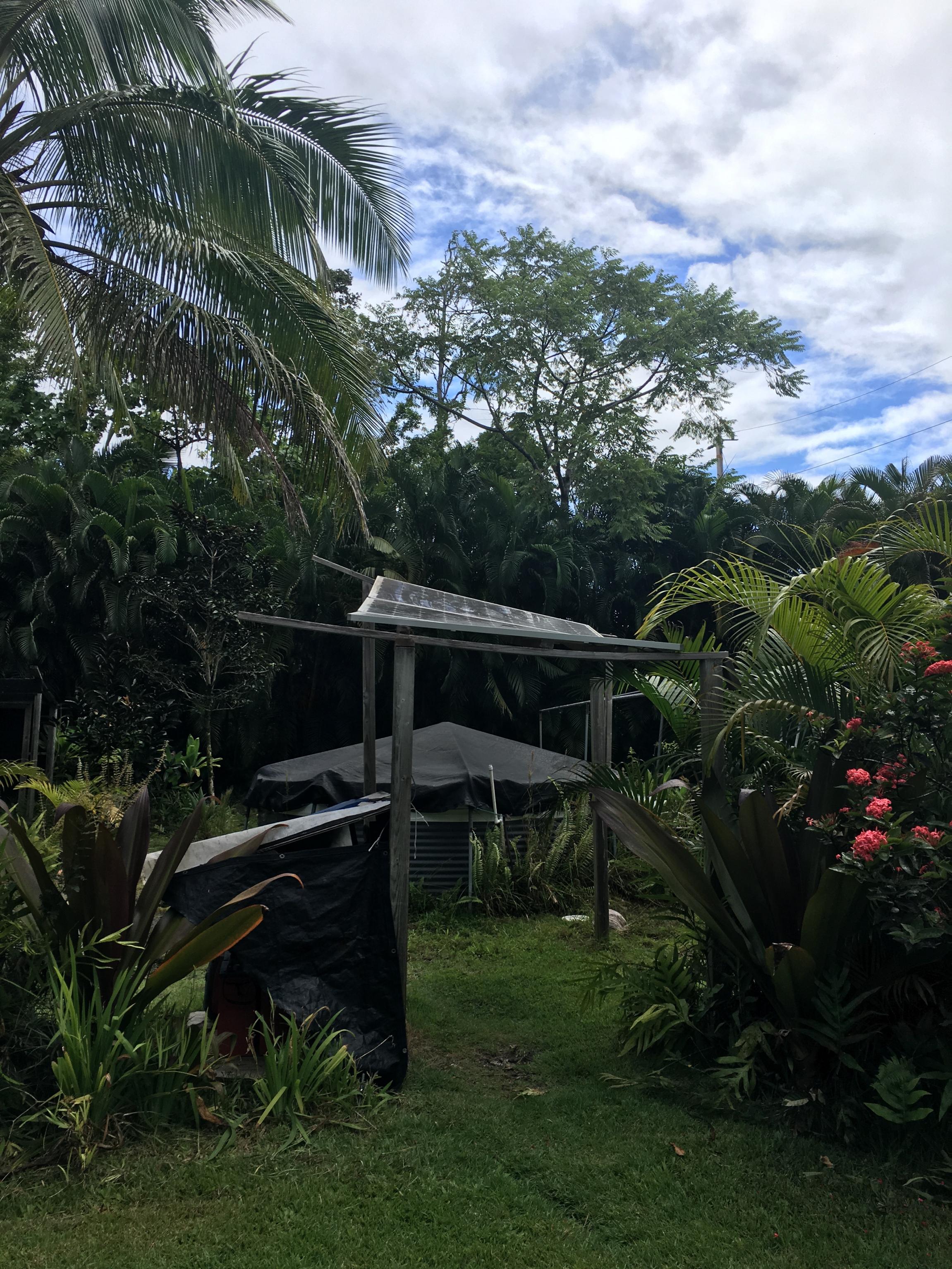

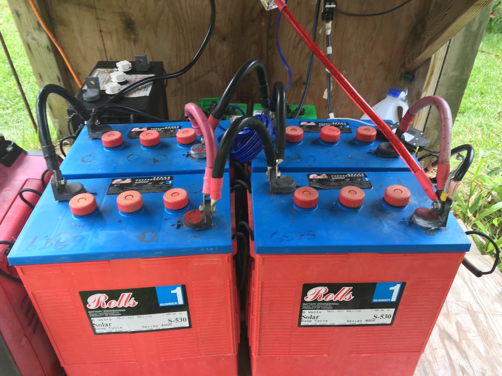

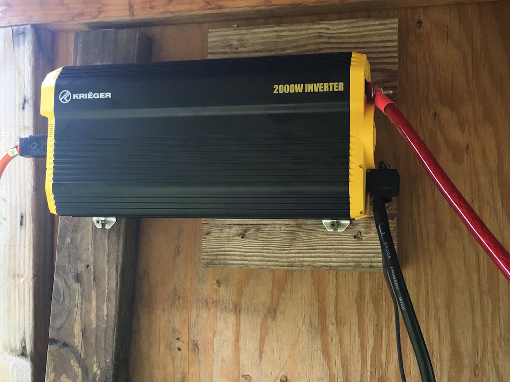

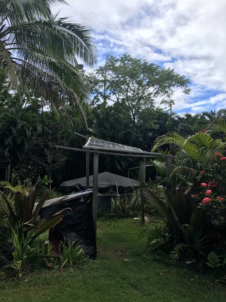

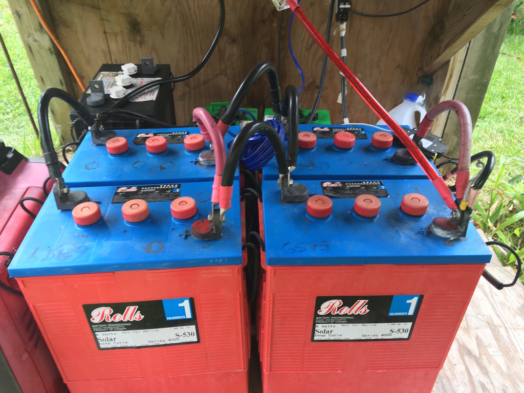

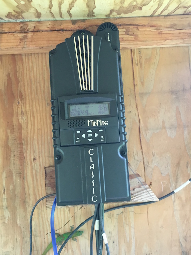

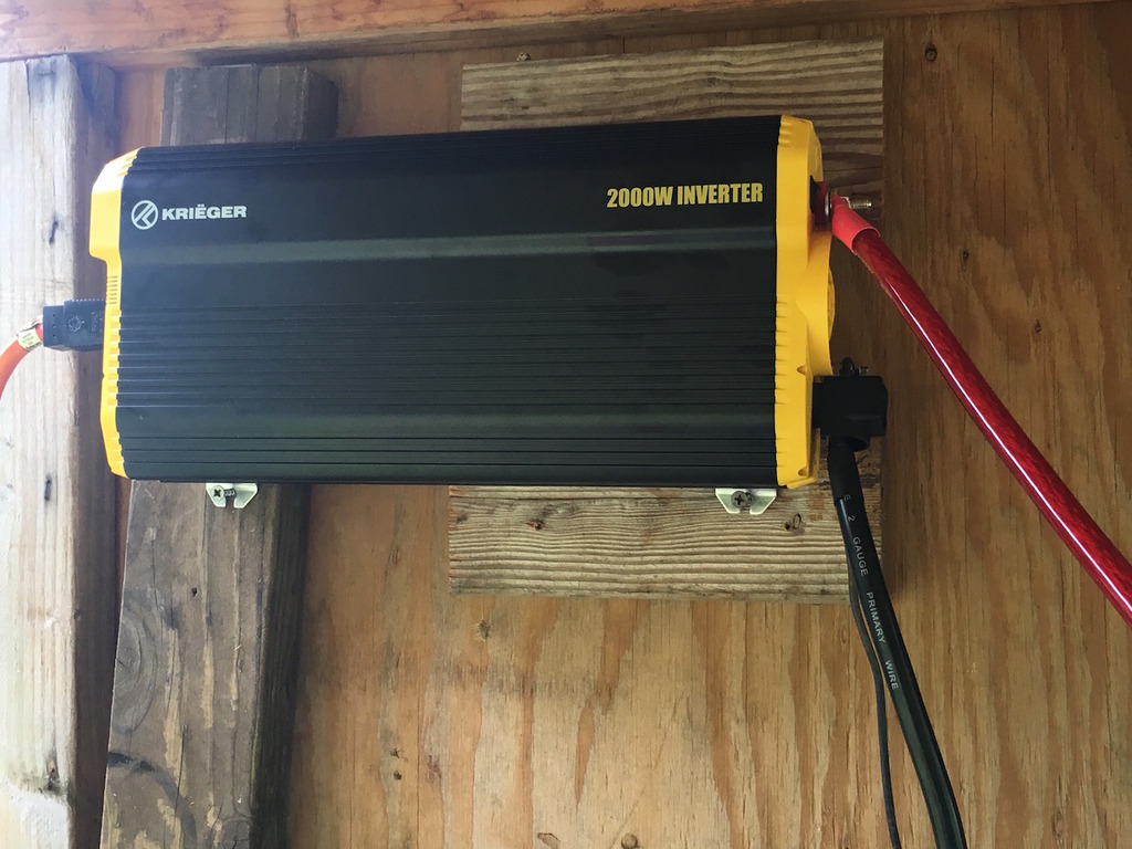

                            I'm going to post photos of my simple set up. It works, and I'm hoping to upgrade my system to utilize my Tesla Charger Solar Tracker 5 12v 40amp charge controller when I upgrade my solar panels.
                            Currently, I'm wondering if I should incorporate this Xantrex 12v 40amp battery charger via my EU2000 Honda generator to help get to an equalization event. The best I've seen on sunny days is a bit over 14 volts showing on my MidNite charge controller. I have not seen it get to 15 volts, thus no equalization at 15.2v. I have absorb, float and equalize set to 14.8, 15, and 15.2 respectively.
                            Here's a quick photo review of my system:

                            I'm looking forward to your replies and advice of best practices. I'm frustrated with current inability to get my 4 L-16s into equalization, even with the correct wiring configuration. It sure would be nice to have 15v topped up batteries!

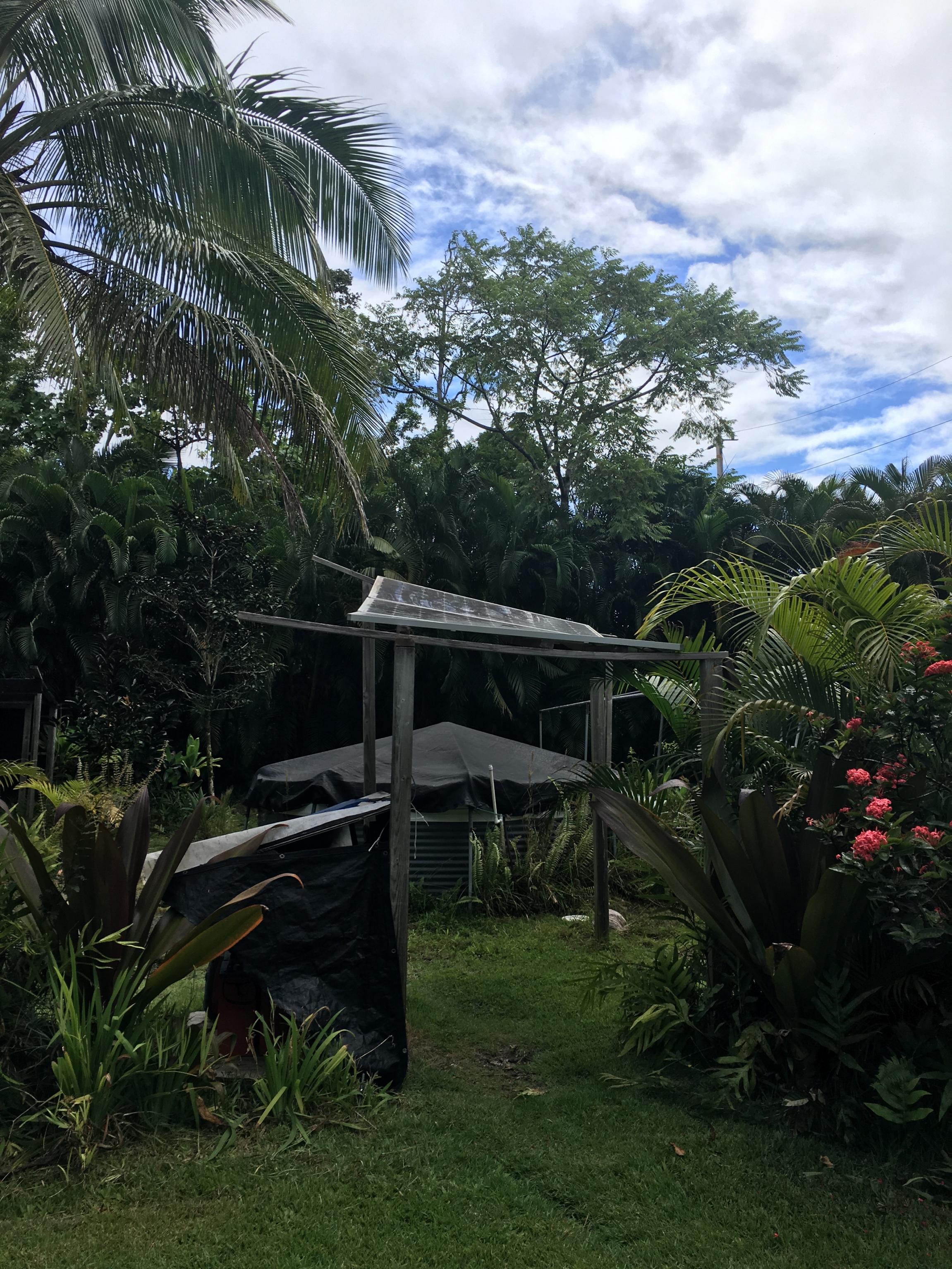

                              Hi Bryan,
                              Are you able to get those panels up higher? I see it's cloudy but seems they're a bit low and would be shaded by the trees - hard to tell in the pic.
