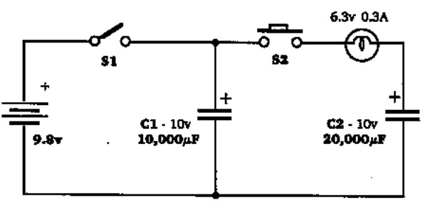

                Aaron,
                Have you tried this? I have and am not sure what is exactly going on with the high potential across the low potential side. It appears a percentage of the high potential is passed through the load into low potential side. What is your view on this?
                -Dave Wing
                  Aaron,
                  -Dave Wing
                  Hi Dave,
                  The Circuit arrangement is alternate Charge -Discharge-Charge-Discharge. But mind you it is not in the normal sense of Charge and Discharge, S1 and s2 must be/are in quadrature (180 phase shift), this arrangement evokes higher potential in the Circuit i.e. more than the source Dipole (battery)..again the process assumed running indefinite in switching wise..

                      Aaron,
                      -Dave Wing
                      Is the switching as Faraday mentions - 1 and 2 alternate? Or is 1 closed and 2 is just pushed intermittently?

                          All caps start out empty S1 is closed until C1 equalizes, S1 is now opened then S2 is closed. Voltage will equalize between caps, even though the light is lit until equalization. The thing is there is no difference if I use a light bulb or just a heavy gauge wire in place of the bulb, the finished voltage result will be the same regardless, which in itself is interesting.
                          To me it appears to be the same thing as John's splitting the positive. Do you have any ideas what is really going on here?
                          -Dave Wing
                            I spent a few hours with that circuit today and a stop watch. I removed the bulb and put in a 470 ohm resistor in place of the bulb and timed the discharges of C1 directly to ground through the resistor until 1 volt was reached. This took roughly 33 seconds to do.
                            With the second test I discharged C-1 through the resistor and directly across the C-2 capacitor until the voltage nearly equalized, then I switched, on the fly both C-1 and C-2 in parallel across the load. This took almost 35 seconds to discharge down to 1volt.
                            After these tests there seems to be no difference or conservation of energy in this setup at all. It took 2 seconds longer on the second test because of the voltage ( pressure loss) while the two capacitors were trying to equalize in the first half of the test before I switched on the fly to discharge C-1 and C-2 in parallel across the load.
                            So in splitting the positve as it stands, with manual switches has no benefit at all. There may be benefit to using a transistor to switch at a high frequency in this system... I don't know and will have to perform this test next.
                            Another test that will have to be done is to rotate the batteries either at a low or at a high speed as John's diagram suggests one needs to do. With the 3 battery set up, it is half of a Tesla Switch so I am not sure if the batteries still need to be rotated within the Tesla Switch as well but it may need to be done there as well? Time will tell as this experiment advances onward.
                            Any comments welcome.
                            -Dave Wing
