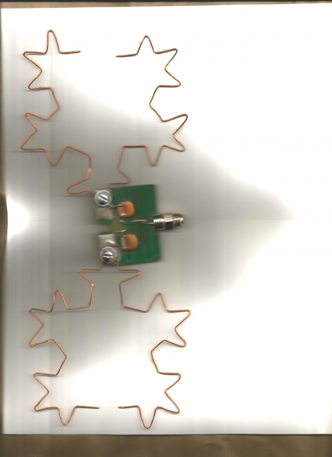

This simple antenna is a fractal and using two will bring in your local and sometimes distant free over the air TV signals.
Yes, I am the creator of this design and I offer it freely to the public. It is made of copper wire that I got out of a 75 ohm cable.

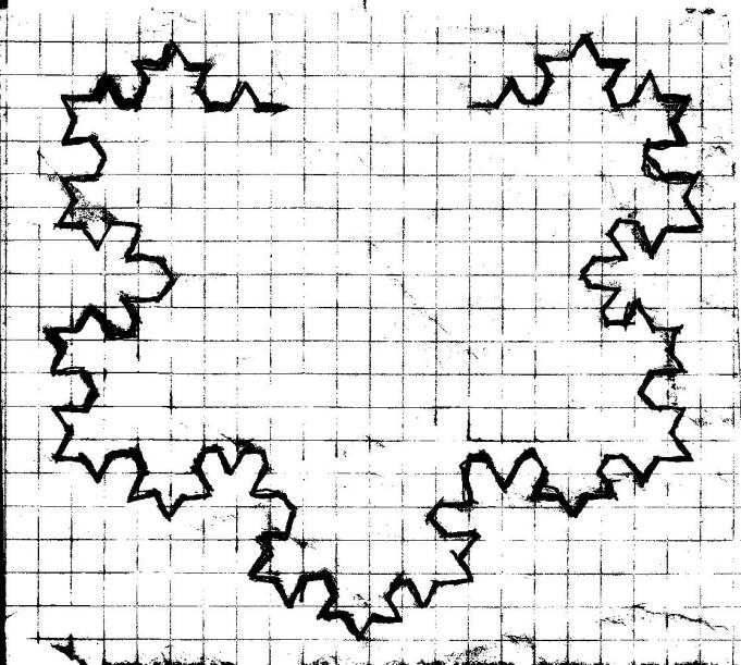

I included the grid paper background for others to scale it on their own. The pointed middle is where you would hook up the 75 ohm transformer.
I have also used conductive pen ink (such as Chemtronics) on firm plastic and I am positive it can be used on glass, such as windows, to hide any antenna from the public.
So, this design can be made from copper or printed on glass or plastic. Plastic is easier to drill holes into.
Multiple pairs increase the signal and if you have multiple windows on your house, you can have a compass of free tv stations.
