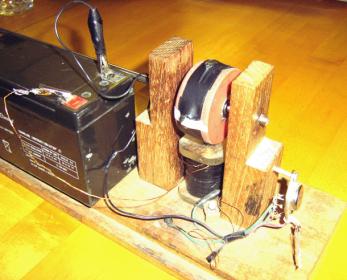

    21194 should work...do you have core in coil??? those magnets might be a little on small side, whats your resistance on your base? you might need to start pretty low like 50 ohms at first just to make sure , and giver a good quick spin just to make sure... coil will probably have to be pretty close to wheel on it(2-4mm).... you should hear it starting to fire when its working, although with small magnets like that it might not continue to run
      Yes my core is 13mm diameter and packed with 1/16 " wires. My base resistance is according to the Handbook at 680 ohms. I can try bigger ceramic magnets, or I can switch to neo magnets. I understand that neo mags might overwhelm the system. What does the system sound like when it starts to "fire"?
        like a humming or buzzing.... bigger ceramics or lower base resistance should work.... I would lower it to 50-100 ohms just to get started. .. it should run easier at that, and you can later tune or higher the base resistance once you got it working
          your build does not sound like a standard build per the SG beginners book. your magnets are too small and weak for the core. wrong size wire and no Bike wheel. what makes the SG run is induced current in the trigger winding. so your magnets arenot creating a change in flux in the core. you will be happy with the SG if built exactly as JB describes it, otherwise it may just bring frustration, like you are experiencing now...... get yourself some bigger magnets and a bike wheel.... and build a coil with 20 and 23 wire, 470 ohm resistors, mjl21194 transistors....

              I am starting with the school-girl size then will elevate to the bicycle size. I am the guy living in the middle east and the components and right size wire are a little of a challenge to obtain, but I am slowly finding resources. Once I get this running then I will work on the larger one. I like your idea of larger magnets. That plus lower base resistance ought to get me there. thanks.
                Thanks Aaron. Yes I am working on the original basic school girl model and using a 9V Duracell Alkaline. I will try 6v and 12V batteries.
                  it will be easier to get running if you start with a 12v on primary side forsure, but higher ya go on primary the more chance you have for blowing transistors up if no charge battery is hooked up

                      Thank you to those who helped me find success on my skate wheel size model. It runs pretty good.
