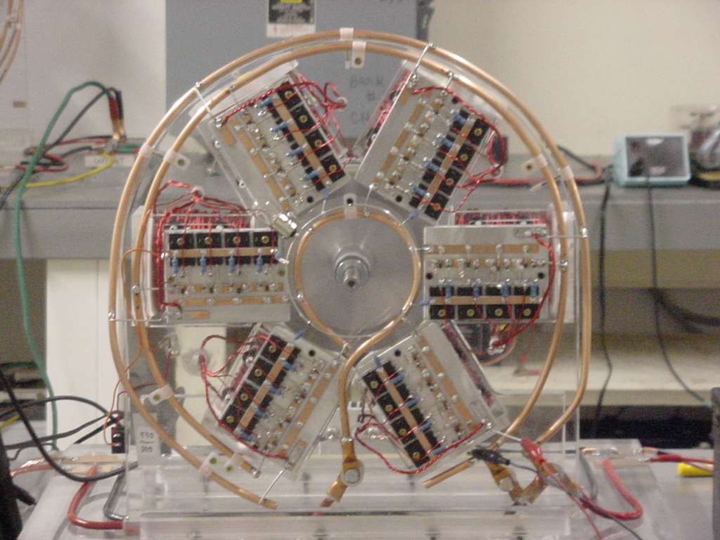

        • here is a pic of the 6 coil SSG that i now own, and was featured in my 2017 conference presentation.......
          I used 8 Gage or larger High Strand count Audio wire for any connections that are not 1/4in soft copper pipe, and not original to the 6 coil SSG unit it's self.....

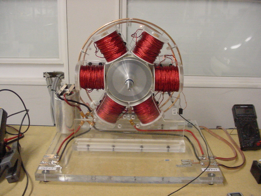

          • Thanks for the pic RS which I found last night, saved it and have supplies to implement it now. There was another view of this setup from the front where it looks like the setup is being powered from two large e-caps. And you can clearly see the output cables going to output battery from the output of unit which looks like standard speaker wire using both strands as one wire; I did this early on myself with my setup and replaced with 10 gauge wire. Right now from what I see in the pic you posted, any other connection I need I will use two, 10 gauge wires for one connection where needed on the frame since I have plenty of it. For the battery connections from unit, maybe use 8 gauge wire but also depends how for the batteries are from the unit. Right now they will be sitting right next to unit for now.

              Nice RS_, a piece of history in your own garage

                Why did you change two of the coils from the original coils? What was the magnet wire used on the new Teslagenx coils? They both look like they are loaded with wire as compared with the other coils. I thought something looked familiar with this setup.
                Another question that I asked before, why have the two large e-caps connected to the input? The last picture I posted was a pic of the setup from the front, running off the two e-caps and nothing else. I have never seen anything on this and wonder using this setup with batteries. I know for the physical size of the e-caps that they can provide drive energy for quite a while if the current draw is low. I do not care what the capacitance is because e-caps that size will hold a lot of energy. I've done this in the past with my audio equipment because you want a flat DC line on the scope and the power supply clean for audio work, otherwise you get noise and other things if the DC is not filtered properly.

                • The ECaps are Stiffener Caps only, across the Pos and Neg of the 24V battery supply, like a big Car Audio system, or the UPS 4Battery swapper system that PL showed in 2016 and i showed in 2017.....
                  I Added 2 18ga 5 strand coils and a 2nd rotor to JB's 6 Coil SSG for the 2017 presentation.....
                  my added Coil 1 is a advanced 5 strand PL charge battery back popper circuit, that adds a back popping SPIKE to the Voltage/Current that is flowing through the charging battery in a 4 battery swapping system, kicking the charging process up a notch, per PL's 2016 presentation...... I showed how to run a Bedini SSG battery charger from a 4 battery PL swapper UPS, and then Charge a 3 battery swapper system from the 6 coil SSG, to run loads to power your life.....
                  my added Coil 2 is a 5 strand Genny coil hooked up in a series adding config powering LED arrays during part of my presentation
                  at 24V+ the system pulls 8+ amps at 2400 RPM......
                  slower bike wheel systems pull less amps

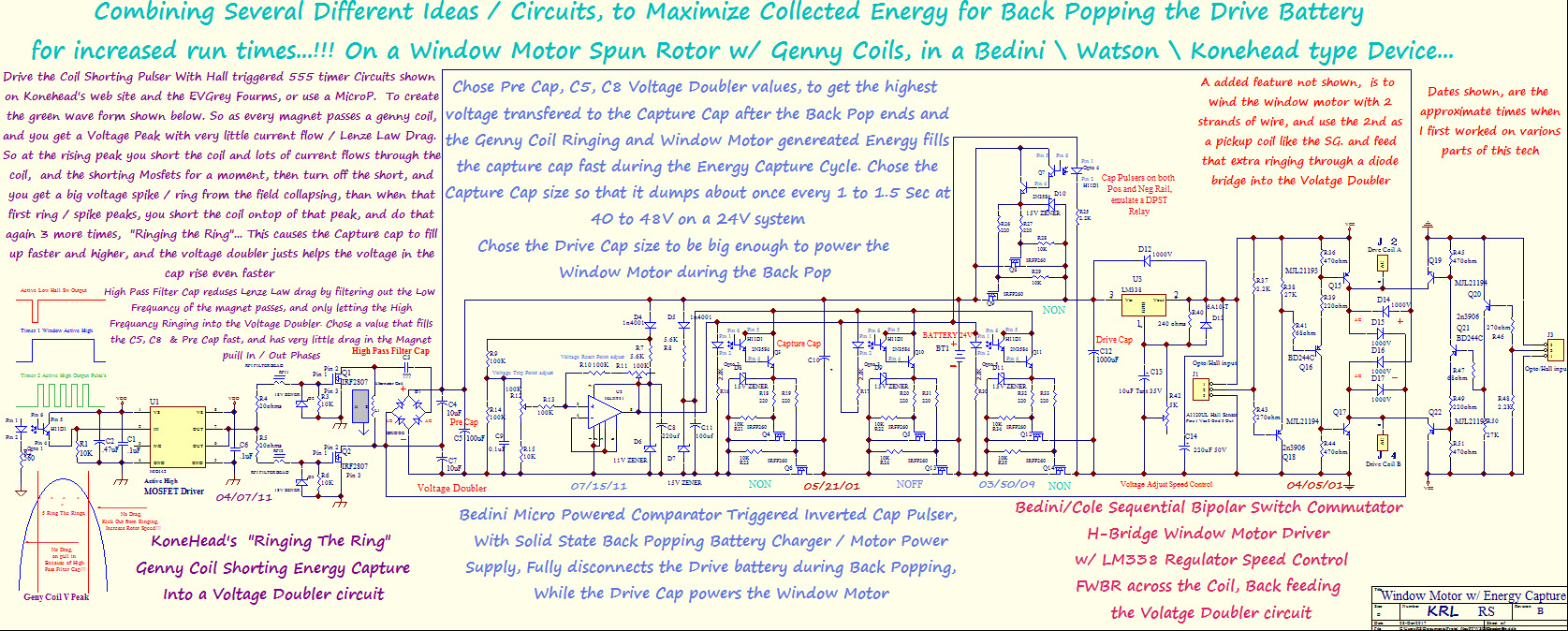

                        • That's Not quite what is meant by back popping the primary battery. The Watson machine uses 1 version of back popping, by filling up a cap with the generator rotor / coils, then disconnecting motor/driver from the battery and then dumping the cap into the drive battery, and then reconnecting the motor/driver while the cap builds back up voltage....
                          I've use a mosfet between the pos of the battery and the pos of a motor driver circuit, and a 2nd mosfet between the neg of the battery and the neg of the motor driver circuit. this lets you completely disconnect the motor driver circuit from the battery and the motor driver circuit can continue running from a cap on it's side of the 2 mosfets
                          so if you have a genny coil filling a big cap/ cap pulser, and pop the drive battery while it is completely disconnected from the motor driver circuit then reconnecting it back to the motor driver circuit with the mosfets, after the Cap dump......
                          PL's 2016 presentation shows how to back pop a charging battery with a modified SG and I did the same thing in my 2017presentation
                          Here is the Schematic that I shared with some of the People at the 2016 conference
                          • Thanks RS_ for sharing the schematic which is rather complex by looking at it and you like to squeeze as much as you can onto one page and not easy to read.
                            Now your explanation of back popping the drive battery reminded me of what I read about back in 2013 and trying it with my bike wheel SSG version then; using an extra coil to capture energy from the magnets charging a cap, that are arranged N-S-N-S on the bike wheel according to Rick was-his-face schematic back then before JB broke ties with him. The one thing about charging of the drive battery was to disconnect the drive battery to give it a charge and then connect back to ckt to keep going. I have to watch PL's 2016 presentation again to see what I missed. I think that Daftman also posted a pic of his ckt using a relay to disconnect the primary battery to give it a pulse.
                            I found my folder of everything JB related from 2013 and also includes from then, Bedini Monopole 3 Group Experiment I downloaded and was following it back then and using a Spreadsheet to record the charge/discharge of the charge battery from my bike wheel experiment. I'm sure that there are some members that remember that time...
