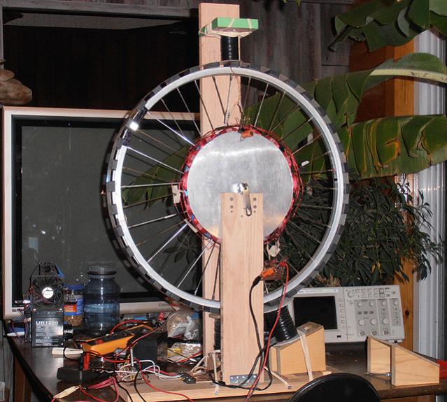

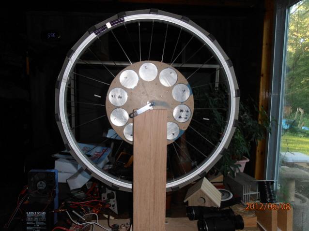

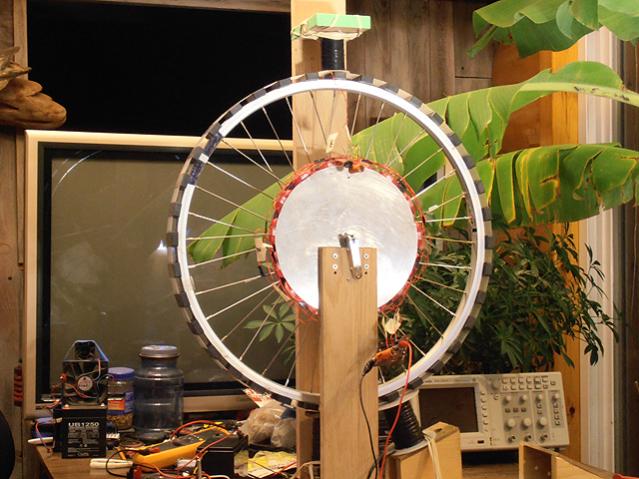

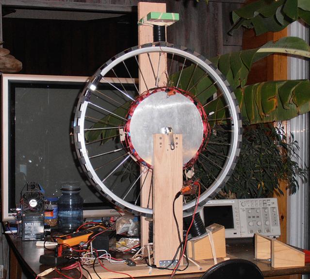

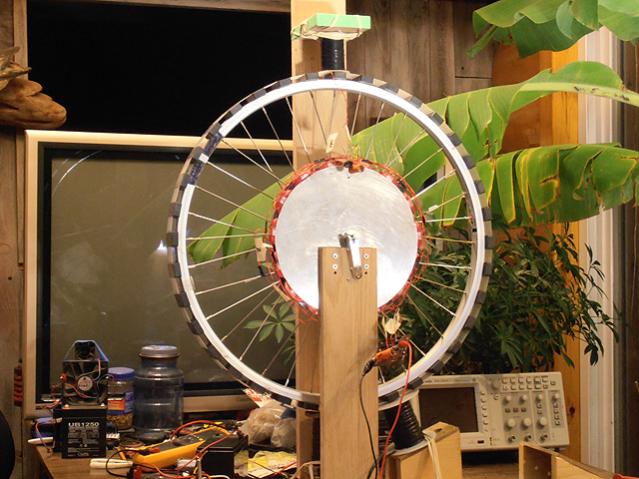

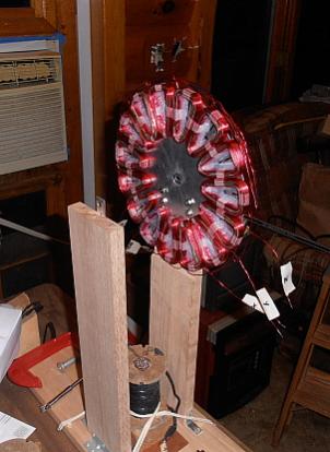

ID:	46289 Great. I like what I have been seeing and reading and look forward to the third book because I have tried adding a rotor and stator to my SSG and it right now easily gives out 6 v DC at low RPM's because of the Lenz effect, something that I missed and maybe I have the magnets too close to the stator. I am using 10 Neo magnets (2" x 1/4" round) and 15 coils (18 gauge) on the stator wired for 3-phase. I like experimenting to see what happens that I think what I started will work some day with more RPM's to generate more power to use else where. You do not know if it will work if you don't try. My house is all electric and my electric rate starting June 1st will increase by 38%. What a rip off that is since ComEd charges the most in my area and there is nothing you can do about the increase. I like to find the cheapest way to go off grid because I have a small river that cuts my backyard in half and finding ways of using it for extra power creating using an old washing machine. And yes, I know what can be done with solar energy because of your great free eBook clarifying the myths out there. Now I have something to tell my nephew that took a class on setting up a solar system the wrong way. Keep up the good work that you, Peter and John have been doing.

                  the magnet spacing[on wheel rim] is kinda close i cant remember what min spacing is its kinda important
                  there is no room for the south pole to form[ if more were good i;d fill rim]

                      I agree with Guy about the spacing of your magnets around the wheel are too close together. If you took a couple out and re-spaced them all, it should run faster. I'd use the same number as specified in the first SG book. It is kind of counter intuitive but with a little more space, you will actually get a faster rpm. If found this out way back with the small roller skate wheel I did. With 2 identical wheels, one had 4 magnets all the way around and one had 3... the one with 3 went significantly faster so you do have to give it some breathing room.
                        Yes the dead zone, there has to be a zone with no magnetism at all. So you get the maximum difference between magnesium and no magnesium. The rate of change is most as possible.
                        If the magnetic cores (from the coils) are blades rather than circle shape, then this makes it better still. I am taking from experiments here.
                        So if you take the core out from a coil, and spread it out to be the same width of the magnet.
                        This increases the magnetic attraction to the core, because we have increased the surface area between the magnet and the core.
