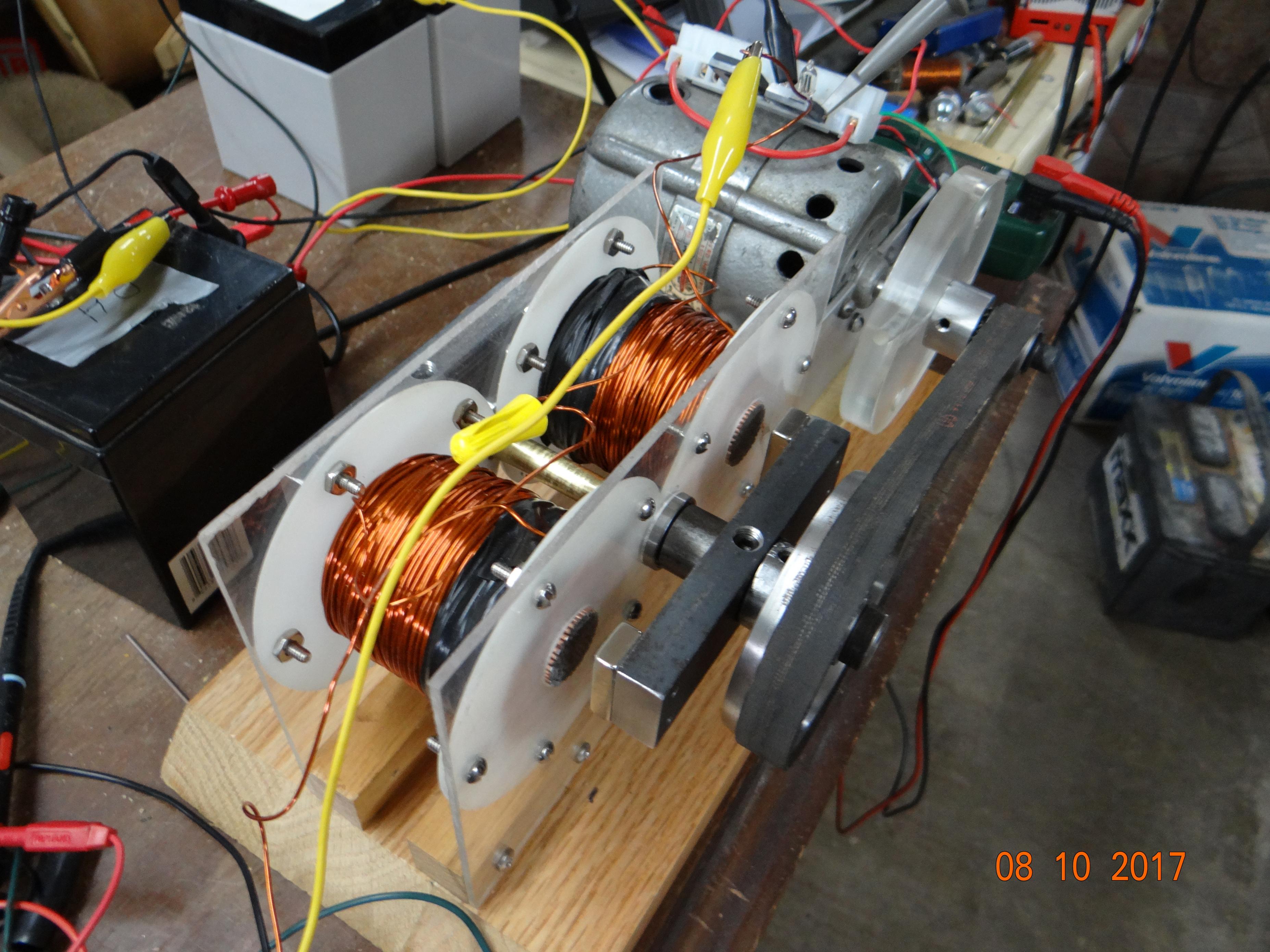

Finally got the flux gate generator built and belted it up to the rotary attraction motor. The motor is under-powered for this generator but will spin it at about 650 RPM with no load and about 550 RPM with a 500 ma load. The motor is loaded down to about 1800 RPM pulling 1 amp from the 12 volt battery with no output load, and pulling about 1.1 amps when the generator is loaded. And when the generator output is shorted, it nearly stalls the motor while pulling 1.5 amps.
The generator will charge a battery pretty quickly and the radiant from the motor will charge another battery pretty quickly at the same time. And either or both batteries will light up 100ma LED strips while still charging.

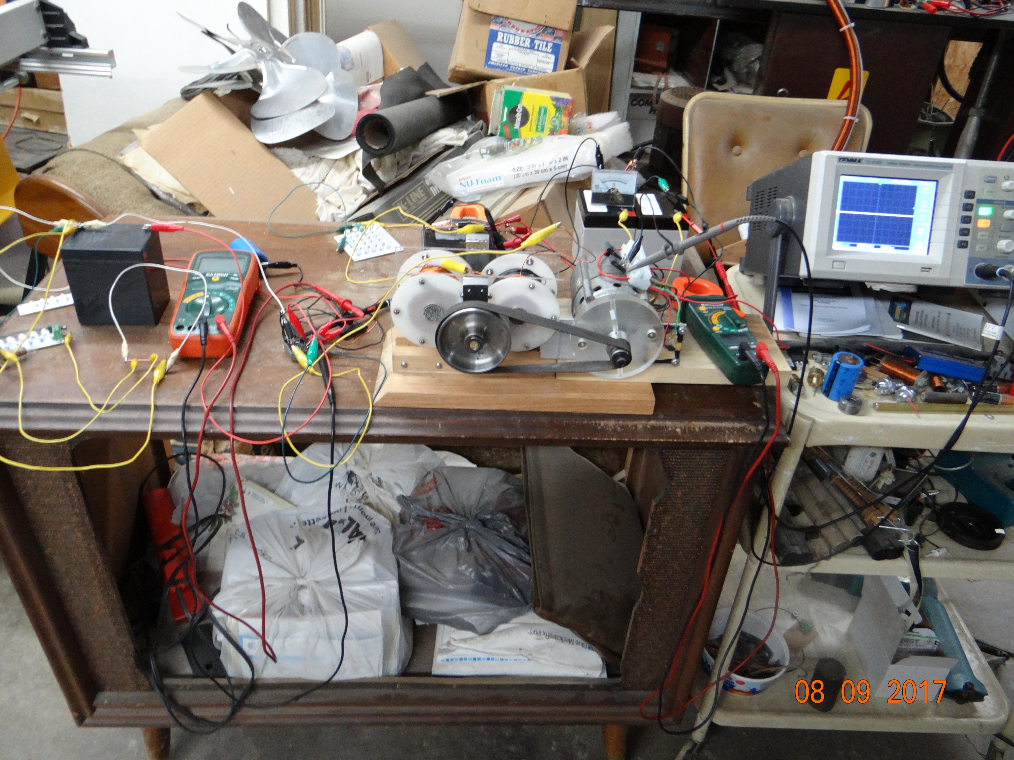

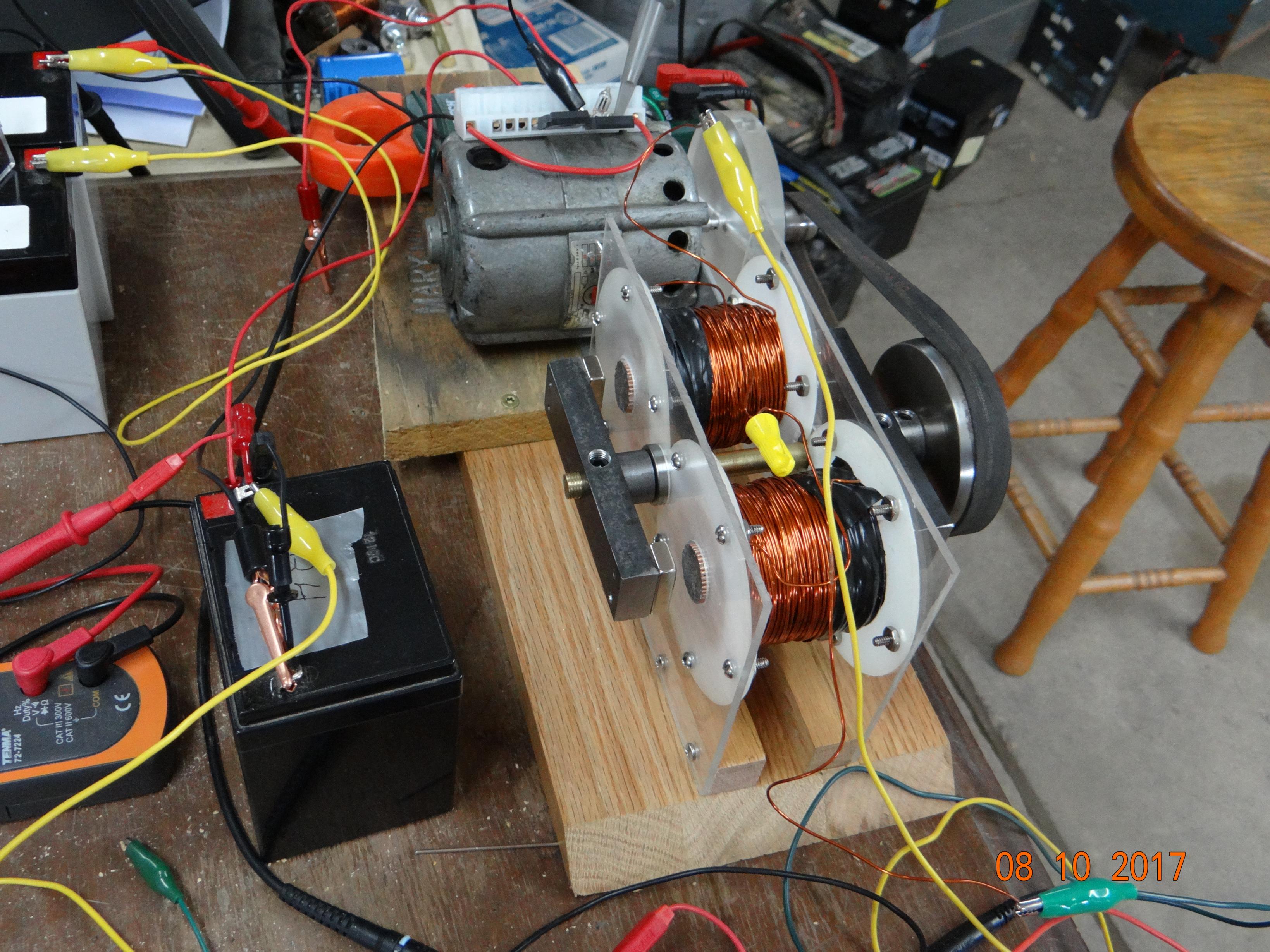

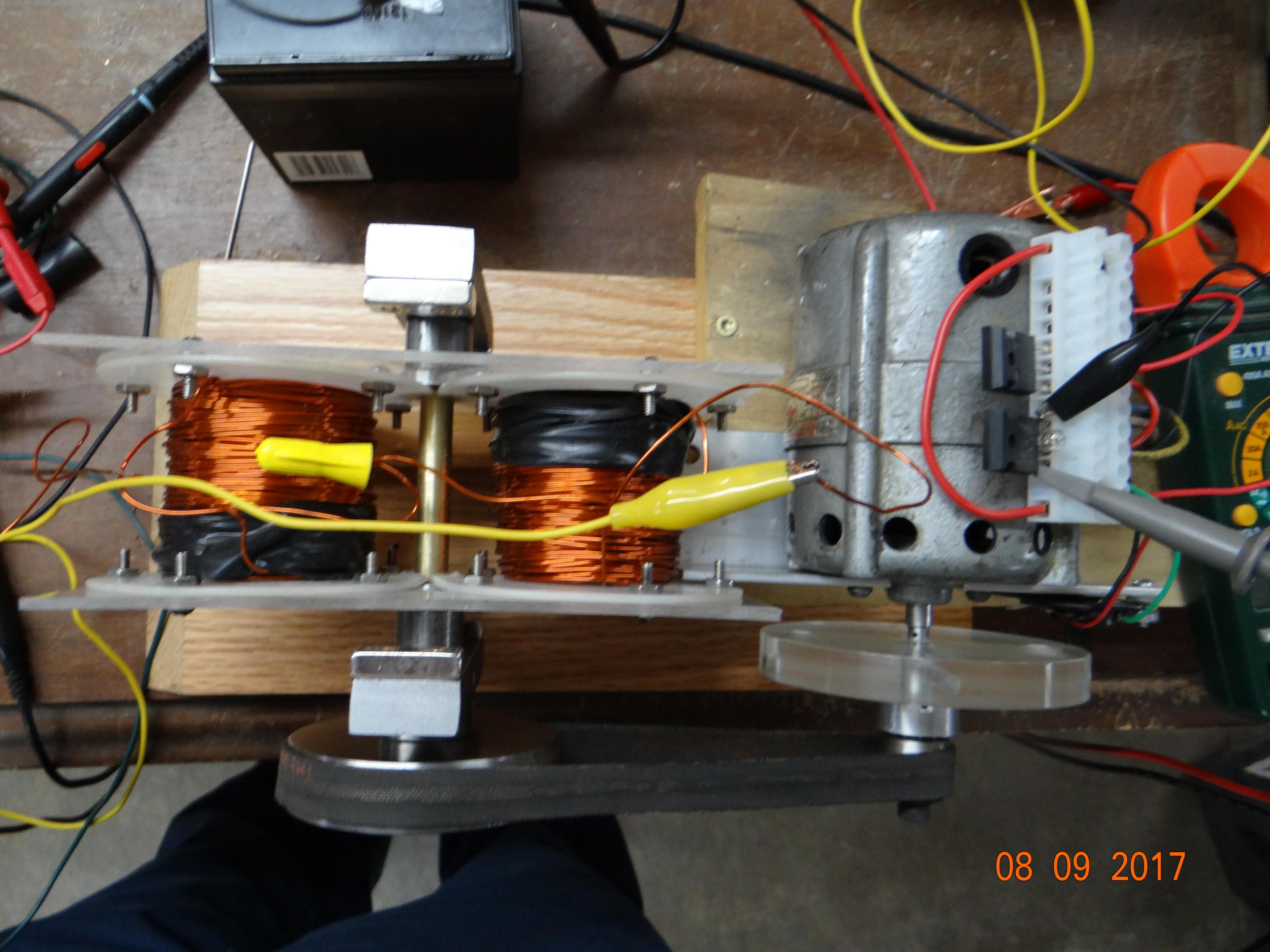

Finally got some pictures and a short video.
Since opening up the air gaps helped so much while running at 24 volts, I decided to try it again at 12 volts last night. I used the same loads as when it was running on the higher voltage. 500 ma on the radiant recovery battery and 400 ma on the battery being charged by the flux gate generator.
These loads were a little too much as the batteries both lost voltage while being resupplied, but the motor and generator both ran much faster than with the narrower gap, and didn't slow down much under load. The motor current draw was only 900 ma and changed very little when the generator was under load. The radiant recovery battery produces no drag or run current load at all on the motor. This energy recovery is basically a freebee!
So instead of pulling the generator at 550 RPM under load like before with 12 volts input, it now pulls it at 850 RPM with about the same load applied. According to my calculations, the two charge batteries averaged supplying 11.3 watts together while the motor was being fed with an average of 10.625 watts over the two hour run period. This is still probably under-unity because the charge batteries lost some charge. The load was greater than the recharging current to each battery. But I still found the results pretty interesting. With a better, more efficient motor and faster generator speed, it should do much better!
