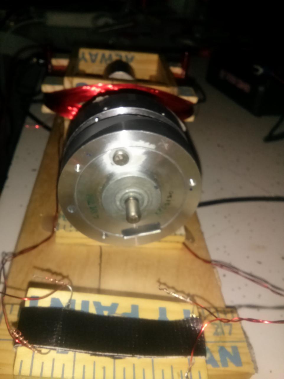

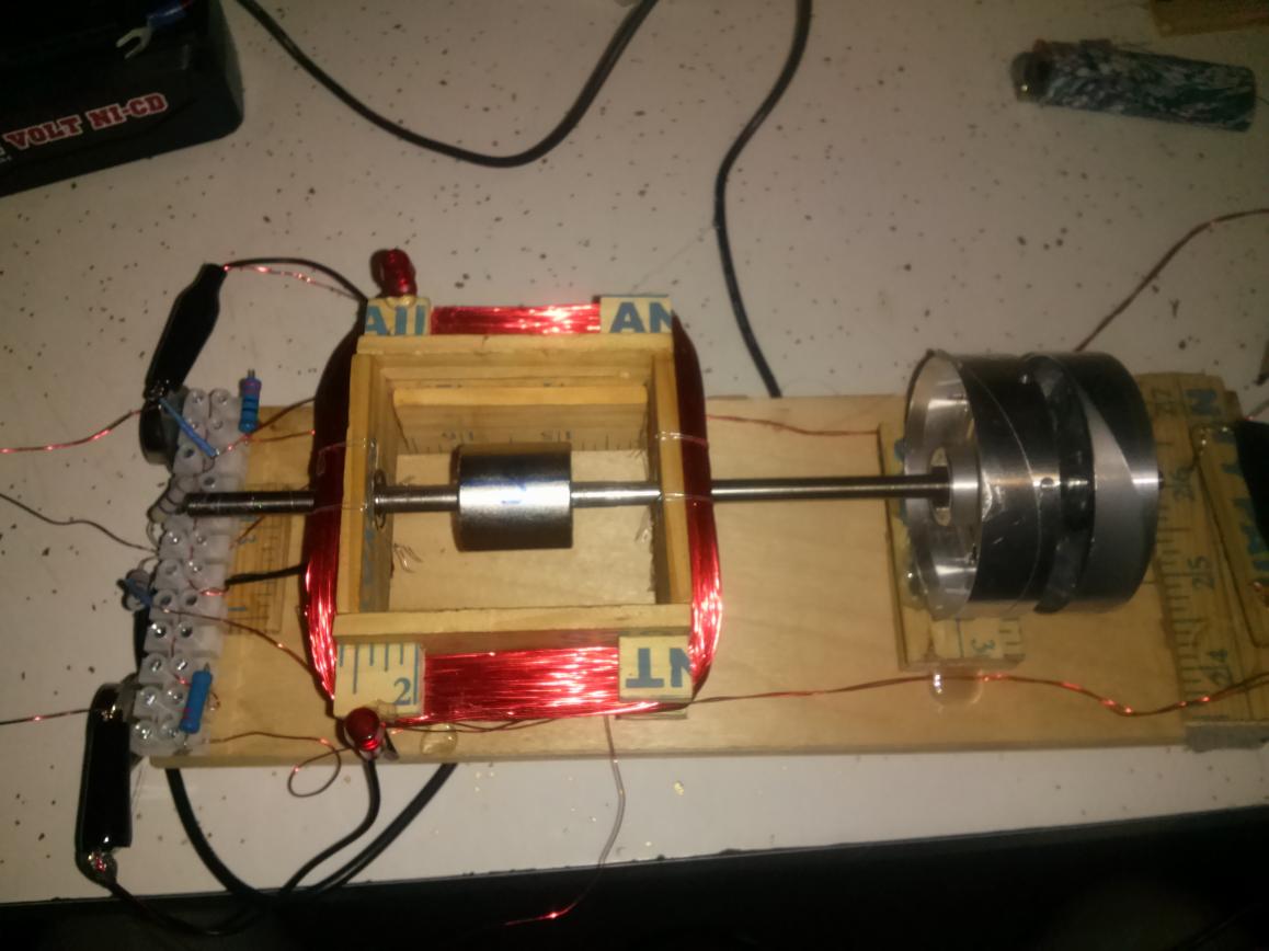

don't have any hard readings...everything is to unstable at full speed because of the wobble from the magnet being off center. but it seems to pull somewhere around half an amp untill it gets up to speed then it levels off slightly below that but i was using a 10 amp panel meter so not very accurate. That's running on 12 volts. it got up to about 1000 rpm and it just shook to much for me to want to push it. so back to the bench to figure out a way to balance this thing. the way i built it i had to slide the shaft through the coil and the magnet and glued the magnet in place. So now i can't just pull the shaft out to balance it i have to do it while its in the coil. Pain in the neck but its all a lesson. on one hand though the torque on this thing seems to match what i have heard about window motors. for drawing as little as it does it has got quite some force behind it.
Double window motor/generator build journal
Well today has been better. after fighting with the thing for about 4-5 hours this morning, I got everything balanced. spun the thing up and it hit 30,000 rpm if my math is correct. I used a small coil hooked up to my multimeter which has a Hz setting. it climbed to a peak just over 500 Hz which using a normal 2 pole magnet that is 500 revolutions a second multiplied by 60 seconds in a minute equals 30,000 rpm! Also I have the diode from the collector through a neon and if i spin it up then hold the reed in different locations sometimes I can get the purple flash I have seen in coil shorting videos.
EDIT; math was right but the measurement wasn't...my trigger magnet was adding extra pulses to the readings. i put an isolated magnet on the shaft away from the others and it read around 200 hz which adds up to about 12,000 which i am still happy with seeing as i am only using 1 pulse per revolution untill i get my bedini/cole circuit running. back to the bench!Last edited by Bradley Malone; 03-20-2015, 12:54 PM.

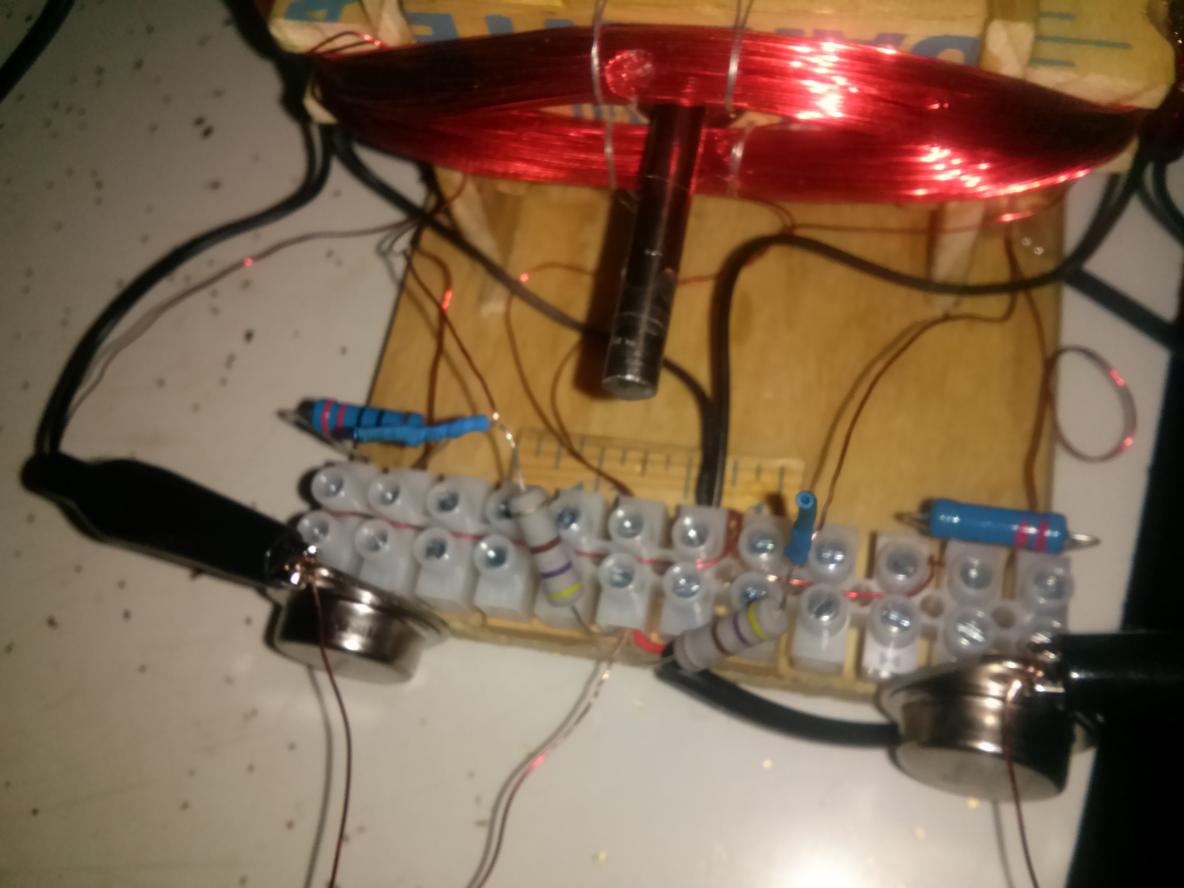

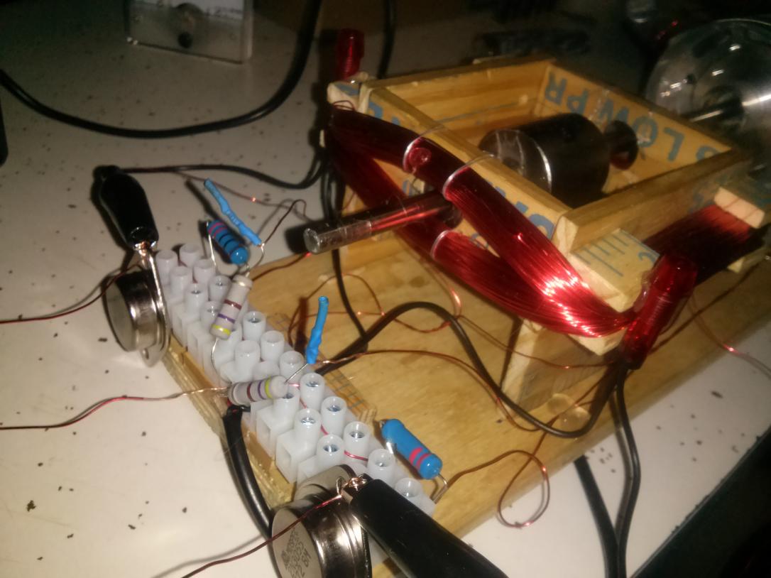

Tidied up a bit...still looks like wires everywhere, but everything is in its place. I used the connector strip along with the alligator clips so that if I burn out a transistor I just unscrew it and put in a new one. Another thing I change is I separated the bi-filar coil into its separate coils and hooked one up reversed to its own transistor so that I could use 2 reeds and have a bipolar circuit. When I measure the current draw though my digital multi-meter it reads steady at 39 miliamps running from a 12 volt drill battery. If I change the timing to close to the zero point (I mean the point where the poles 90 degrees from the coil plane) the speed is much greater with less torque and draws around 28 miliamps. When I run it at the high speed point the caps stop charging at 12 volts, But when I run it at the higher torque lower speed timing the cap (880uf 250v bank of 3 caps in parallel) charges to 30 volts in a second maybe two and just keeps going. That's my next step is to time the charge rates at the different timing points until I find the best location. I also plan on making something to accurately read the speed. No cash to get a tach at the moment.
