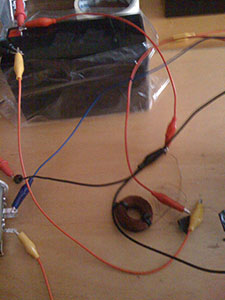

The coil I've wounded in picture

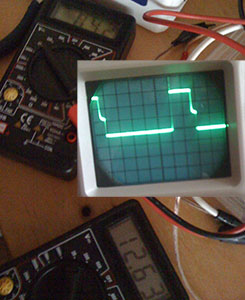

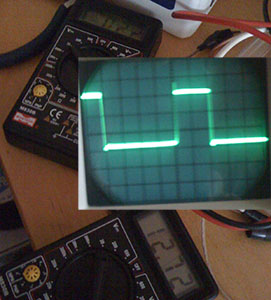

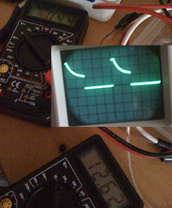

I use npn 2n3055 transistor, 3A diode on output, base-emiter 1A diode, ~5k variable resistor. All oscilosolographs measurements on emiter-collector. Im charging 7Ah batteries from 7Ah primary battery too. Coil parameters is 34m of three wires. Two (both) on power wires and third on base. Base wire ~18 omhs, powerwires ~9 omhs.
This is the first point of my charge primary current:
Current is 0,22A ant oscilograms are straight square.
This is the second point of my charge current:
Current is 0,42A and there some soft shape of straight square.
This is the third point of my charge current:
Current is 0,44A and there line down.
Coud You help me understand what I see on oscilograms? Whitch one of charging points are better?

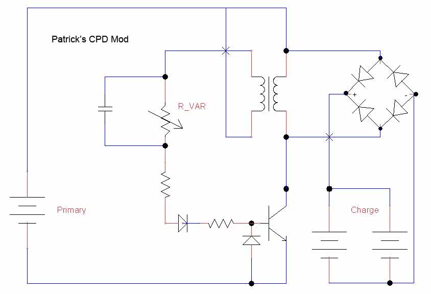

give this a try. We did it years ago so I have no problem sharing it:
we talked about it on the old yahoo forum, and I've talked about it at EF as well.
by itself it is not "the" answer. you still have to build to spec or find the right balance with your own stuff.

Thank you for the tips. Here's the circuit, I erased the "one wire".Originally posted by John_Bedini View PostOk,
