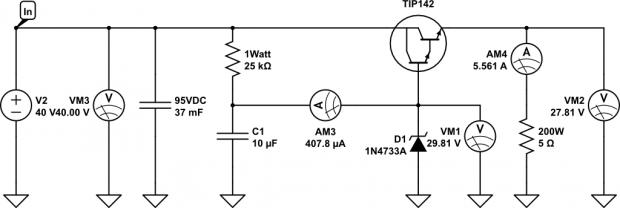

                Lman, ok here is a zener controlled beta multiplier delivering about 5.5 Amps to a load. Seems to be working pretty well and I am alot more clear on the importance of Ib, Iz, and Ir1. I think its the simulation that goes wonky when I reduce the load impedance down to 23mOhms. When I do that, I have to increase R1 so much that its not enough to put the zener into reverse breakdown.
                Anyway...I think I'm getting the hang of it...now just need to get the amplifier part of it in there...it needs to adjust to that crazy low impedance some how...to be continued....

                  R1 is the 1W 25kOhm resister

                    Joster,
                    Yes, it starts to get slowly clearer. Now get the datasheet of the darlington you are simulating with and check the SOA. What happens when at 30 volts you try to pass 5 amps DC ??
                    It will be safe at 3 Amps.
                    I think this is what John means by saying that it should be chosen for the correct voltage and current.

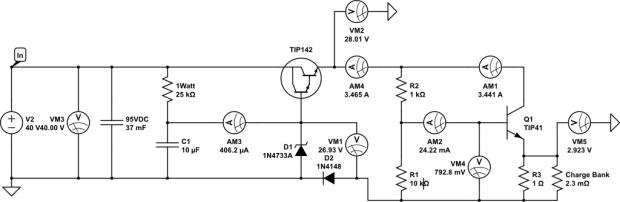

                        thought i'd share this..got this reply from some poking around i did on an electronics forum...pretty interesting...they don't know anything about the context of the radiant energy and what not i just ask electronics based questions..this reponsClick image for larger version

                        Any way my new simulated circuit with emitter follower added is attached

                          Joster,
                          The formulas and what they told you about a current limiting is not wrong. A discharged battery is really hungry for current and it indeed can blow a charger. This is why most of the chargers have fuses.
                          A 3A charger can charge a 240AH battery if it is current limited but sooo slow that you will grow beard several times. That is why John has build chargers in different current and voltage ranges. You would not put a S3A12 on a 240AH battery, would you?
                          You can see thousands of battery charging circuits on the net mostly copies of one another. And not even one is close to what John is doing.
                          Looking at the circuit you posted you did not get it about the diodes. The diode to ground must be connected in series with the zener but opposite to each other. The anode of the silicone diode connected to the anode of the zener.
