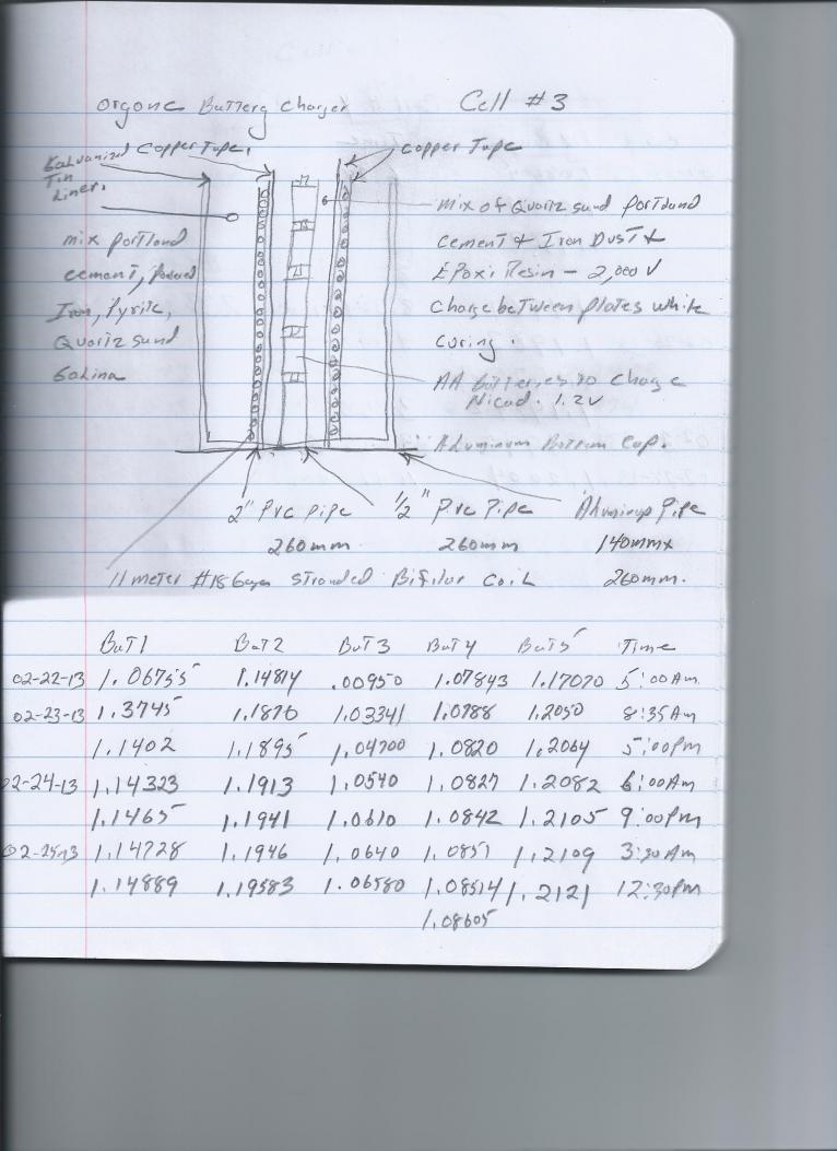

Cell #1 Constructed from 2 inch plexiglass pipe by 2.5 inches long. I glued on an end cap with 5 minute epoxy made from a circuit board material. Made two electrodes from copper tape 2 inches wide 2 inches long cut from copper flashing material with plastic backing that can be removed and is sticky on one side. Picked up at Manards. Expensive but it is what I had and i can solder leads easily. You can use something else for electrodes if you want doesn't matter. Install electrodes 180 degrees from each other, not touching inside tube. Mixed quartz sand, with epoxi resin. The kind you use for auto body work. Picked up at wall mart. Not cheap either! Picked up sand at swimming pool supply bought 50 lbs for about 8.00. It is a lot of sand but you can use it in other ambient projects. Mixed about two table spoons per oz. You want to be able to pore it so don't make it so thick you can't. Don't have to be real precise in this case. You won't short out cell like you can if you mix too much iron or metal filings of some sort. I then mixed enough to fill tube. While curing I applied 2000 volts DC with 20 ma current limit until cured then removed voltage. After cured I drilled a hole for a AA size nicad battery in center. I started with a AA but you can use a C cell or what ever fits without removing too much matrix material. I have just discovered this anomaly so there is a lot more work to be done to see if it can be improved. Such a the thickness of the walls of the charger. Will greater thickness improve cell or does it matter? Don't know at this time. Thought with more people working at same time mabe might find a better process.
I also found that if you hook up a battery by the leads to the electrodes in the same polarity as it was conditioned it will charge battery. If you hook up backwards it will discharge it. With the hole in center just drop in a battery that needs charged and wait a couple days. If you have a voltage meter that goes out to .ooooo places you will see the process. If you don't have one it will take a day or two before you notice a difference with.000 accuracy. I bought a HP meter second hand on line and it is a must if you are going to work with this. It doesn't happen very fast but it does happen. Would have missed it if I was using a basic meter. I will share the rest of my cells as I get the data transferred from my notes. This was an unexpected event so my notes are a little messy to share directly. Started out not taking notes just using up some time untill next project and had to go back and write every thing down after the fact. At least on first cell.
This will get you started with the cheapest build so have fun.

For now I will share the basics of the other two cells just to get you started. The cells all basically use the same idea. They are variations on the organite compound that is being used for cloud busting. You can read about it on the internet. I have made several cloud busters several years ago, like about 10 years. So I am familiar with that process. I have for a long time wondered if you could use the energy that is being collected and directed for tower busting and cloud busting to make some type of electrical generator. So these cells are my first proof of concept. Until I figure out how to get an attachment to work I will just at this time give you the basics of what I am doing. Cell 2 is constructed similar to cell one but it has a cardboard tube in the center to fit a C cell battery. On the outside of the tube is the copper tape. I use a 2 inch by 2.5 inch long pvc pipe. Cheaper than the plexiglass. second Electrode goes all the way round the inside of the pvc pipe. The positive electrode is the inside one and the negative the outside electrode. The matrix material is a mixture of Iron filings from a local machine shop, Portland cement, and quartz sand. Equal parts of the matrix material mixed in Epoxy resin. Mixed all matrix material first. Then mixed resin with hardener then added the matrix material. If you add too much metallic material you will draw over current when you apply 2000 volts. If this happens there is still a chance the cell will work. I just realized as I am writing this I need to check this theory out. I was trying to make an Electret at the time and I have never not uset the voltage. I think it does make a difference but at this time there needs to be more tests and more proof of concept by others.
Cell #3 is same matrix mix except on the inner cardboard tube I installed a galvanized steel liner on the inside and rapped the outside with a layer of fine steel wool then a complete rap of Black electrical tape then another layer of steel wool then tape. Repeat 5 times in this case then glued the inside tube to a piece of cardboard in the center. Glued a 3 inch cardboard tube around this at same height 2.5 inches. Installed 2 copper tape electrodes 180 degrees from each other, attached leads, filled with matrix material, applied 2000 volts until cured. Ok. These are the first variations of the cells that work. Will post pictures when I get the attachment thing figured out. I hope, with your help. LOL.
Data: for cell #1
02-22-13 8:00 AM 1.15320 V : 8:50 PM 1.17860 V
02-23-13 4:35 AM 1.18310 V : 5:00 PM 1.18840 V
02-24-13 5:00 AM 1.19030 V : 9:00 PM 1.19402 V
02-25-13 3:30 AM 1.19450 V : 3:40 Pm 1.19870 V
02-26-13 9:40 AM 1.19940 V : 9:00 PM 1.20060 V
Stopped test but left in cell and checked just before writing this and it is 1.20140 and still rising.
all other batteries in the other cells were similar. I can provide exact data if requested. Noticed newer
batteries charged faster that older nicads.
P.S. Look up Orgone generators and accumulators for more information on the matrix material.

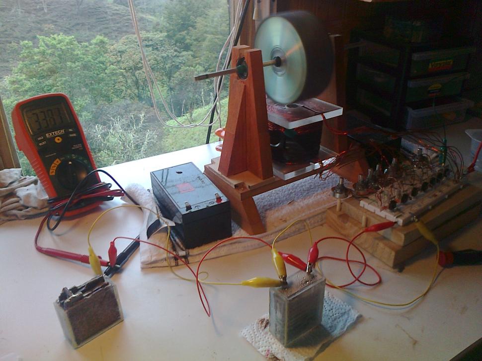

Hello all, i just had success with my build, it's a lead-Alum battery, using the mix described by john (Alum, H2O, So4, Hydrate#9, Sodium Silicate), the build is as exact as i could make it to the video on how to make the cell, where he pasted the plates with lead oxide... so far i'm forming it with the SSG machine, at 500Ma, its holding a charge of 1.85V, and drawing 60Ma from the oscillator. I don't have a way to chart the curve yet, but the program is on the way.... I'm noticing the same effect described by Fausto and john, its holding a steady charge of 0.5V on the sg oscillator, pretty amazing, has only been cycled 2 times, we'll see how it goes after a few more charges... heres some pics
Hello all, whats going on? where is everybody? the cell is doing great, forming and charging with the sg... every time the capacity grows, it settels at 1.91V after 15min rest, the discharge is taking around 2 hours to reach 0.4V, and stays there, running the oscillator, keep in mind its a very small 3 plate cell. the discharge time also keeps growing as the oxide forms. I built a new cell to run an experiment, in this one i'm not using lead oxide, just to see if i can form the oxide from just putting charge on it, and have it perform as well as the one with the oxide built in. it's going well, but the discharge is much faster, so far it takes like 10 minutes to reach 0.6V, i guess, like John B. said, it takes a longer time to form the oxide, so the difference in the plates takes longer to grow. the cell has a very small ammount of SO4, its resistance is averaging 1.6 ohms.
I have a question for Mr. Bedini... i've seen that with the charging, the crystallization happens much faster, theres crystals growing everywhere, so im wondering if it would be beneficial to use a little cream of tartar in the mix, wich has been found to reduce the growth of the crystalls.... thanks!

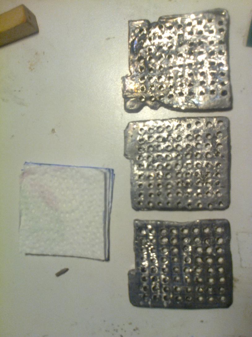

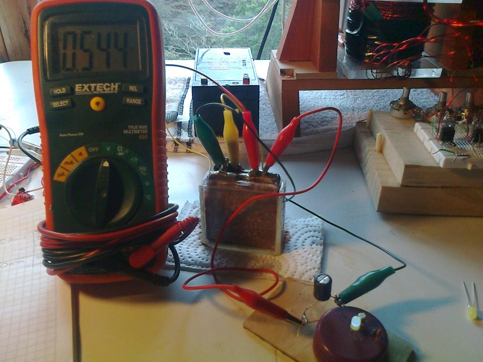

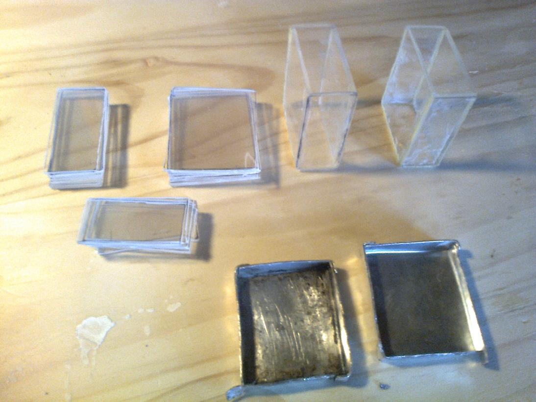

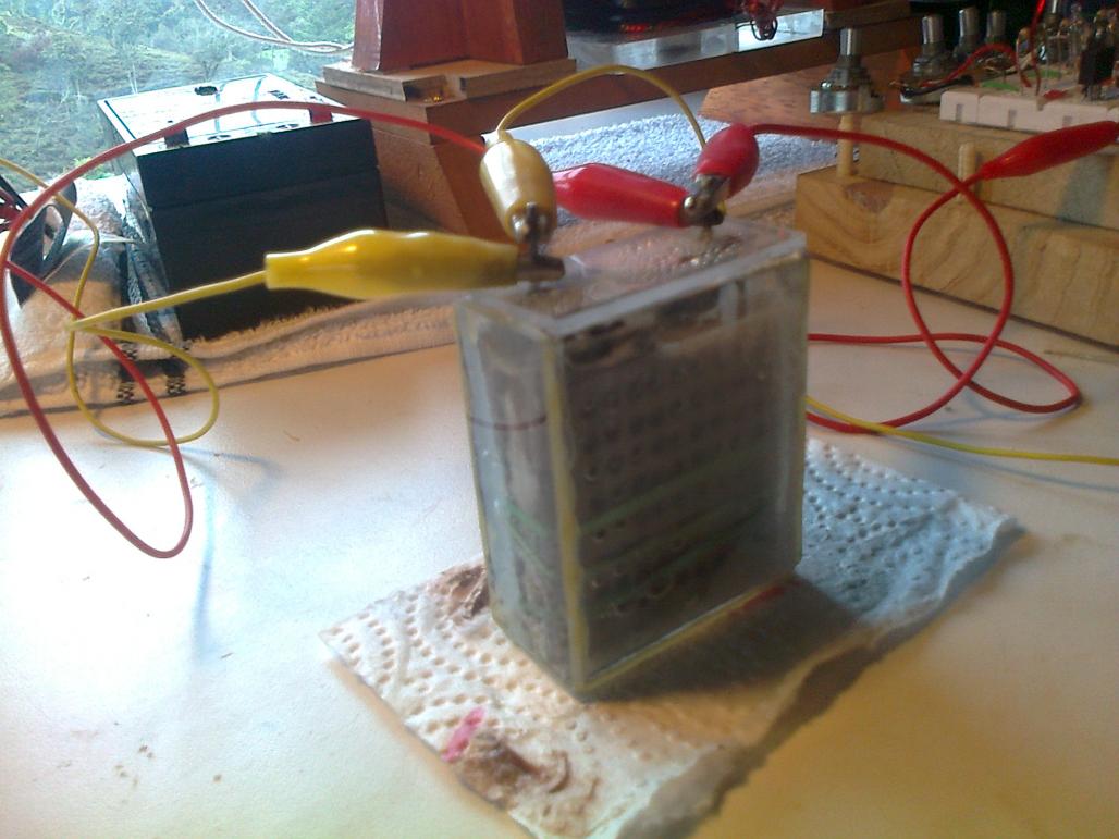

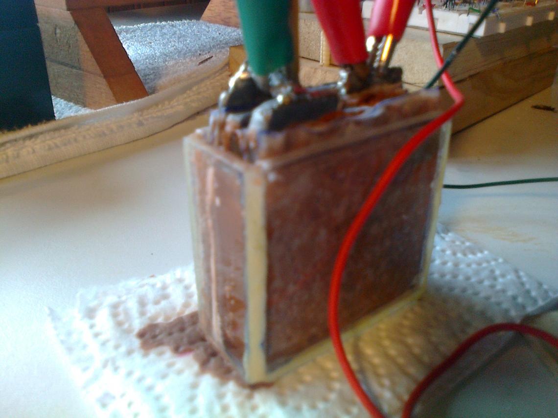

I Have had some success in building crystal alum/acid batteries
I am just using lead sheet from x-ray devices, cut to about 2" x 3" 1pos 1 neg sandwiched together with heavy paper towel and alum paste. Nothing else
electrolyte is the mixture John had mentioned a while back.
I have 2 so far I've been experimenting with that seem to keep getting better with each cycle.
I charge for 5 minutes with 3 used AA batteries, after charging it settles in around 1.87 to 1.92 V
I discharge using Lidmotor's Penny circuit running 5 bright white LED's (7Ma) after it discharges for awhile the amperage draw drops off slowly.
I've been taking the batteries down to .500 during discharge, it takes 115 minutes and it keeps getting longer each cycle.
Mine also are growing the little BB size crystals all over the plates and in the bottom of the container.
The first one I made I conditioned it with the SG and it did just as well if not better.
I have let that one dry out completely, then put it back in the alum/mild acid solution, charge it up for a couple of minutes and it would also take all but 2 hours to discharge to .500 V
At this point I just keep cycling them to improve their performance. If I can figure out how to post pictures I'll do so.
I think I am going to build a case to hold seven of these individual cells which should give me something close to a real strong 12V battery.
Brian
