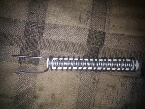

    The inner core is the zinc and is the negative pole of the cell. The lead is on the outer portion of the core. In the picture below you can see what the core looked like but I did change it. Originally I had a separator cut out of 1/2 inch PVC with windows cut out but I found that the Lead would not stay put with that design. Later I wrapped the inner core in a few coffee filters and electrolyte then wrapped the Lead tightly around; which I think improved the cells operation and kept the Lead evenly distributed around the inner core.

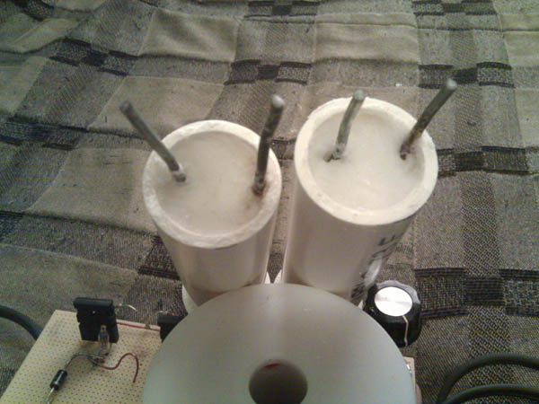

    The housing for the cell is 1 1/4 inch PVC pipe. I constructed the core and put it down into the tube. Then I pored electrolyte down in there until it was about 1/4 inch from the top.

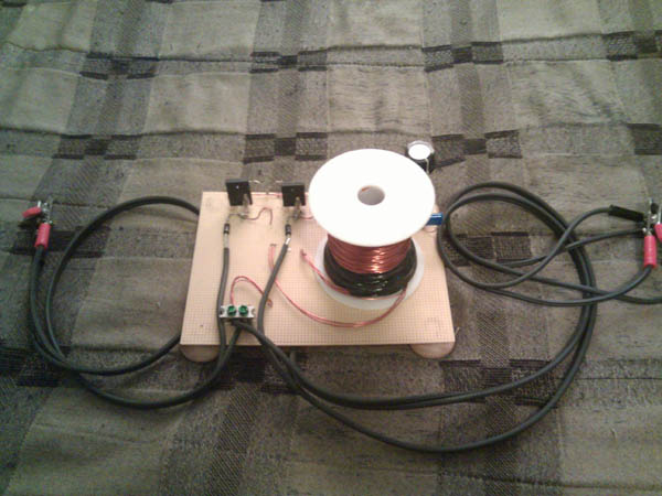

    Now the really cool part of this is that I am charging them from a Solid state energizer I built. These cells were formed, charged, everything with radiant energy. They have never seen normal DC power. They also have never had any acid, not even while forming.
    This charger is not the focus of this thread but here is a shot of it. It is wired up basically how Patrick does with his cap-diode mod and moving the bottom side of the trigger coil.

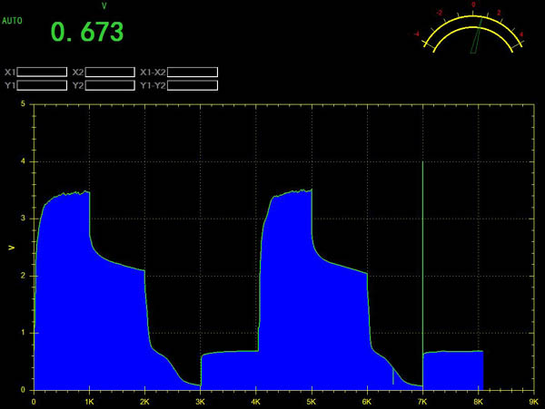

    Here is a chart of one cell charging, resting, under load, and resting, then repeated. I did that twice in a row on this chart to show that the cell operates consistently. These were also short tests. The scale on the bottom is seconds and on the left is volts. I did a 1000 sec count for each portion of the cycle.
    The load is a 2.5 volt 150ma bulb which is a very heavy load for just one cell. I am still conditioning these cells but soon I will start putting them in series which should be closer to the voltage that that bulb wants to see. I can say that these cells are getting better (more capacity) with each cycle i put them through and I expect them to be very useful once they get broke in.
    Another thing worth noting is that I am dragging these things down to like 40 mv under load and they bounce right back with no problem, just amazing!

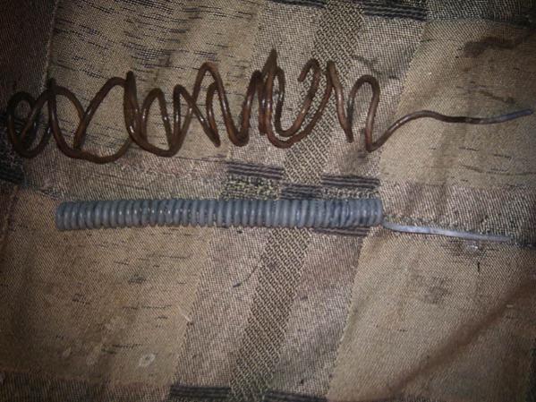

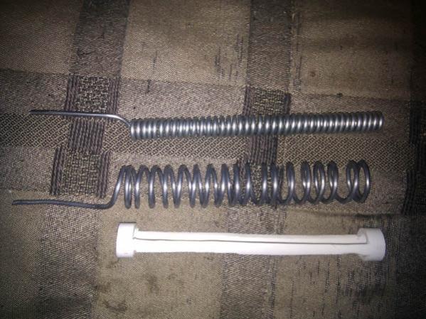

    I decided to take a cell apart to have a good look at what is happening inside. From what I see there is no damage to the metals: only a film forming over the surface.
    Here is the cell core removed, dissembled and rinsed off. You can clearly see brown and grey colors I mentioned before.

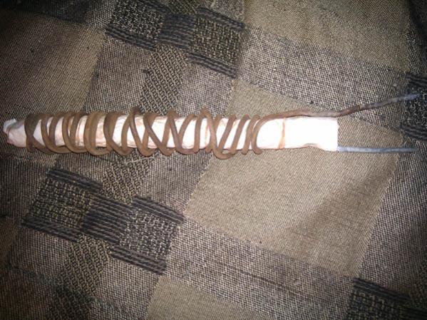

    And this is a shot of it after I re-wrapped it. I used four coffee filters stacked on top of each other for thickness and then rolled the inner (Zinc) core inside. I added rubber bands this time to help hold the insulator in place. I'm not sure if this will cause problems by adding substances to the cell but if it does I can always re do it. The Lead wire is re-wrapped around the coffee filters tightly.

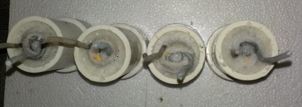

      They had dried up completely when I got them back out. They looked only half full now because the foamy electrolyte had all settled down and lost all of the fluff. I added distilled water mixed with Alum to the cells, up to about 1/4 inch from the top and charged them back up. They performed pretty much as well as they had when I made them. I ran charge and discharge cycles just as before and as I said they worked perfect.
      Now I wanted to see how they looked on the inside so I took them apart and that is really why I am posting with a follow up. They seem to be in pretty much the same shape as when they were built. They had started growing some very interesting crystals in the bottom. These were long very clear looking crystals, almost like quartz on appearance but very soft. (see picture below). I think these formed from the sodium carbonate and the Alum mixing. I have seen similar crystals form in mixing jars of just sodium carbonate but not quite like these.

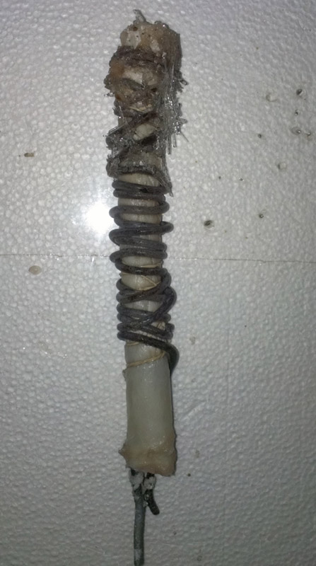

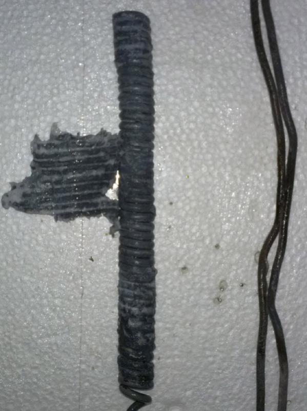

      This next picture is from when I unwrapped the lead and took off the insulator. The Zinc core did sort of fuse with the coffee filter. There was a gritty feel to it when peeling it off and you can see a section I laid next to the core to show the bonding that formed between the two. I would not say that there is any real damage or deterioration of the material though.

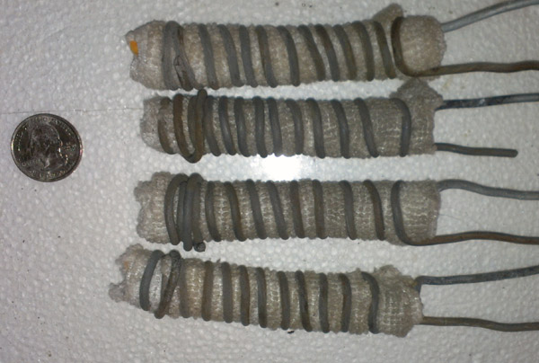

        I have constructed the new cells out of the old.
        Basically I cut everything in half so that I could make four cells from the original two. I have also changed a few things in the design but not majorly.

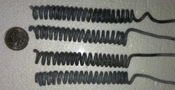

        Here is a shot of the zinc cores after cutting them. It shows their condition pretty well after having been broken in for so long in the old cell. They are half the length of the old cores and I stretched them out a bit so that it is more like a spring than a pipe. I think this will allow for better coverage of the electrolyte between all of the turns.
        I changed out the coffee filters as insulators and used a washcloth instead. It was a thin cloth and I wrapped the core three times with it. Again I think this may allow for better coverage of electrolyte. The Lead is now half the original length and is wrapped tightly around the cloth and Zinc core.
        This time I changed how these are filled and the consistency of the electrolyte. What I did was layer Alum powder, about a teaspoon at a time and moistened it with a mix I made of distilled water and sodium carbonate. The mix is 1/2 cup water and two teaspoons of sodium carbonate. I wanted these to be more like a solid crystal than a wet cell. Similar to a copper magnesium cell.
        I would added some alum then put an eye dropper full of the mix on that. It bubbles up and reacts like before but I am intentionally not saturating it. After a few minites I would tamp it down with a stick and add another teaspoon of alum and repeat the process. I did that in layers until the cells were full.

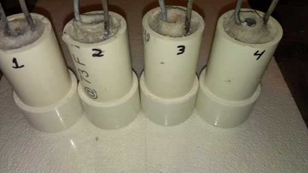

        Here is a picture of the finished cell.
        Now I will be doing some charge/discharge cycles with the new cells. I will post back some results for those later. ---Bob

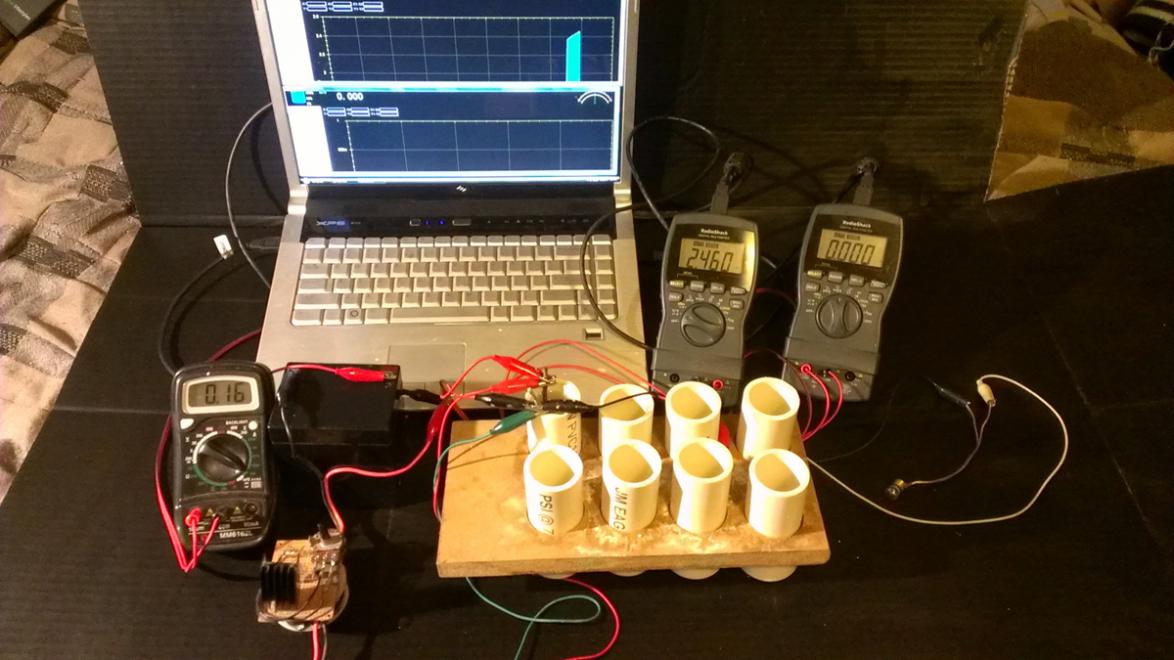

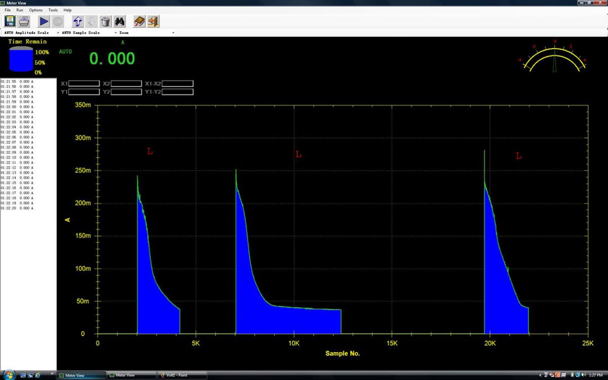

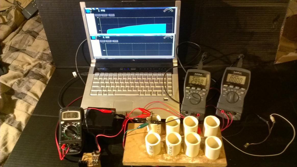

          Last night I ran some charts on one cell to share. I have 8 of these built now that I can hook up parallel or series, whatever and they are pretty strong but I thought it would be best to first show just one cell.
          Here is a picture of the setup. I am using a small solid state charger and set the draw to 150ma. It is capable of much more but if I cranked it up to much the charts would not look very progresive so I went with a somewhat slow charge.
          I setup one meter on the cell voltage and the other is connected in series with the load so that we can see the interaction between both charts when I load the cell. The load is a small light bulb which was rated at 1.5 volt but had no current rating. The black meter on the other side is measuring the current on the charge input. As I said I initially set it to 150ma but I noticed as the cell charges it pulls up a bit more, at max it was pulling 190ma.

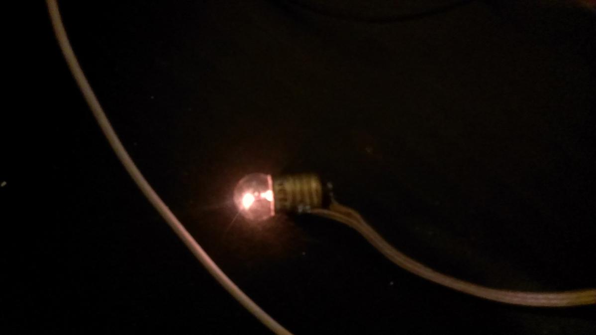

          Here is the bulb when the load was first connected. It does not stay lit brightly for long as you can imagine but the current this cell puts out is pretty impressive.

          So here are the charts. They auto scale so they do not match each other in scale but they are both running in the same time. The amp chart is only to show the load when it is connected. I did three cycles on the same chart which I marked. the "R" is for rest, "C" is charge ,"L" is when the load was connected. What is very interesting is if you look at the difference between the first charge and the second it looks very different. See how the voltage jumps up and then falls down before the cell starts charging again. I think it must be an impedance within the cell but i'm not sure what to make of it. These cells love to be charged high and drawn low. If you don't let them sit around between charges they respond very well to it. I am thinking about using these in a cap popper type of situation where I can keep them high and pulse a little in and out, but the idea is keeping them full. The light bulb is a bit much of a load for just one cell but actually when it gets down around 1/2 volt it is still delivering 40ma .
