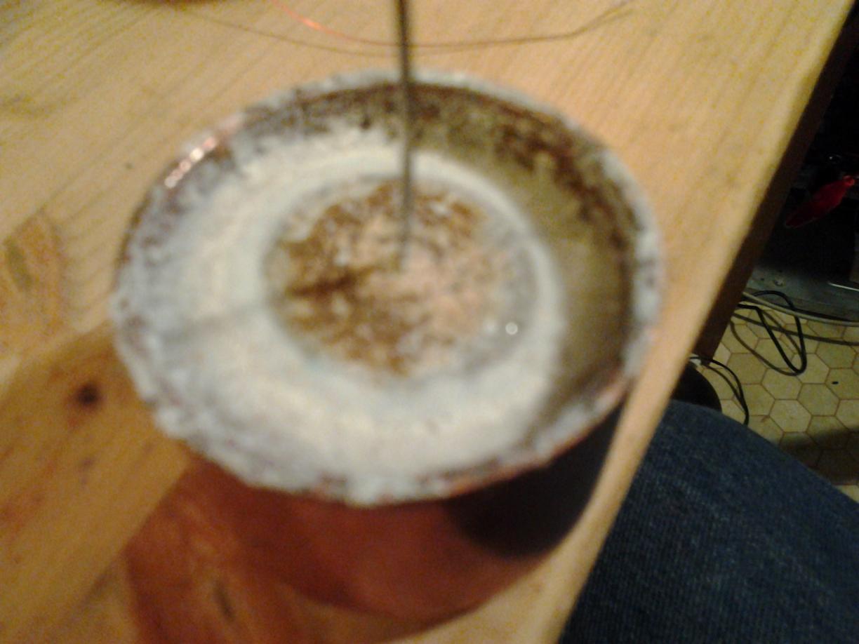

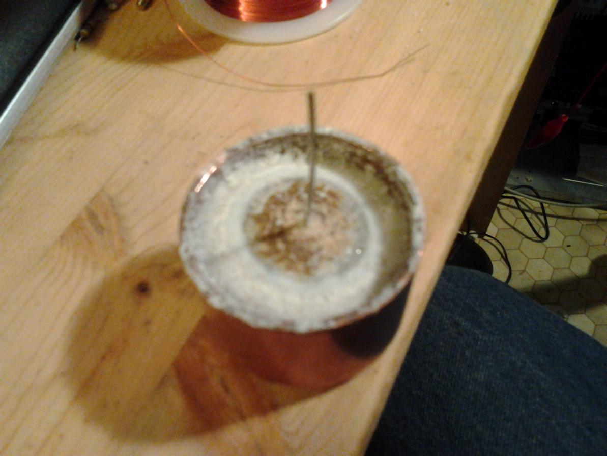

Okay, taking a cell apart ... this is one that was made at the same time and running under load ... the other cells are still up and running the led bank with no loss. I also would like to add, I do not add water to keep the cells energized. It needs to pull it out of the air if it is using H20, I will be running them in a vacuum soon to observe what happens and will post the results.

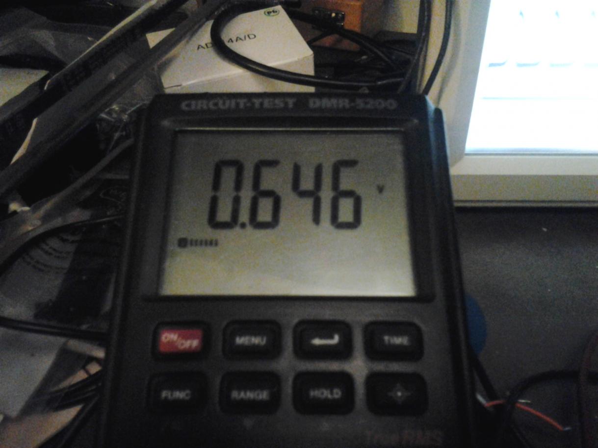

As you can see some very interesting things as I was hoping. The dark ring is iron oxide from the steel core, this is a by product and it is not what is coating the Mg. I will leave you in suspence for now. When applying the voltage meter you can see the volts coming through the on the cell, it will go up beyond .5 volts ... it is hard not the scratch the surface and break through though and when that happens nothing. I will update more as it continues.

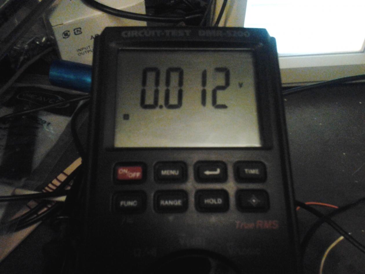

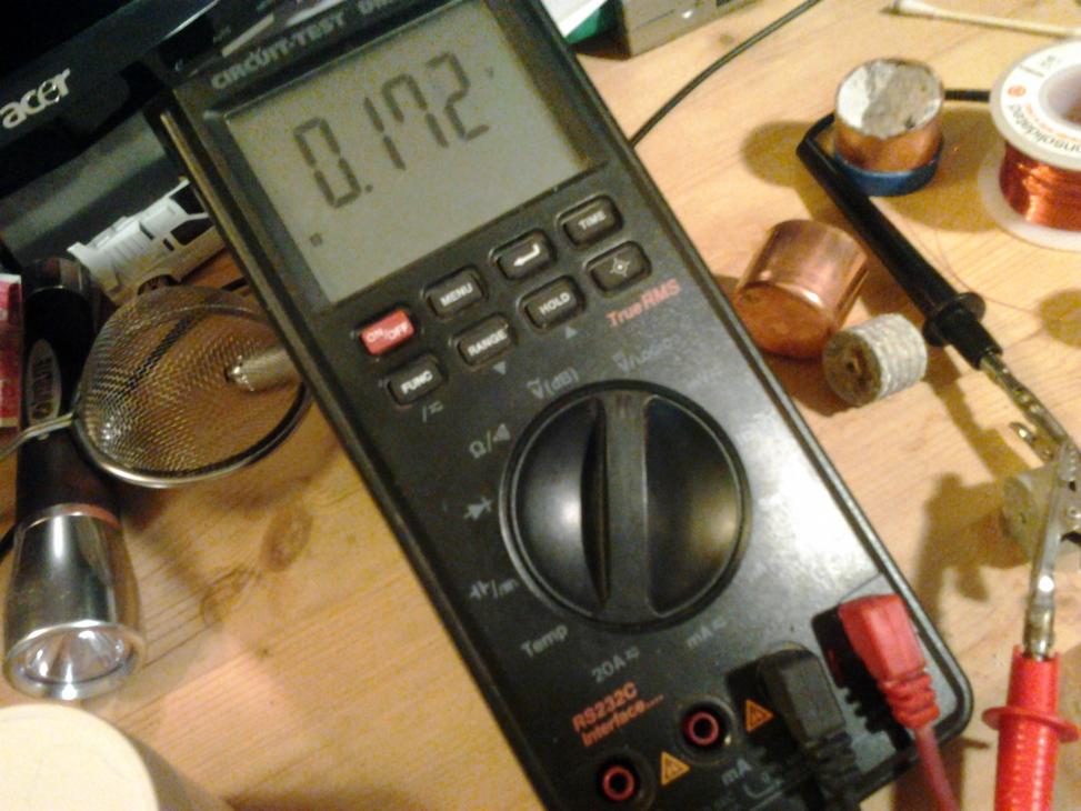

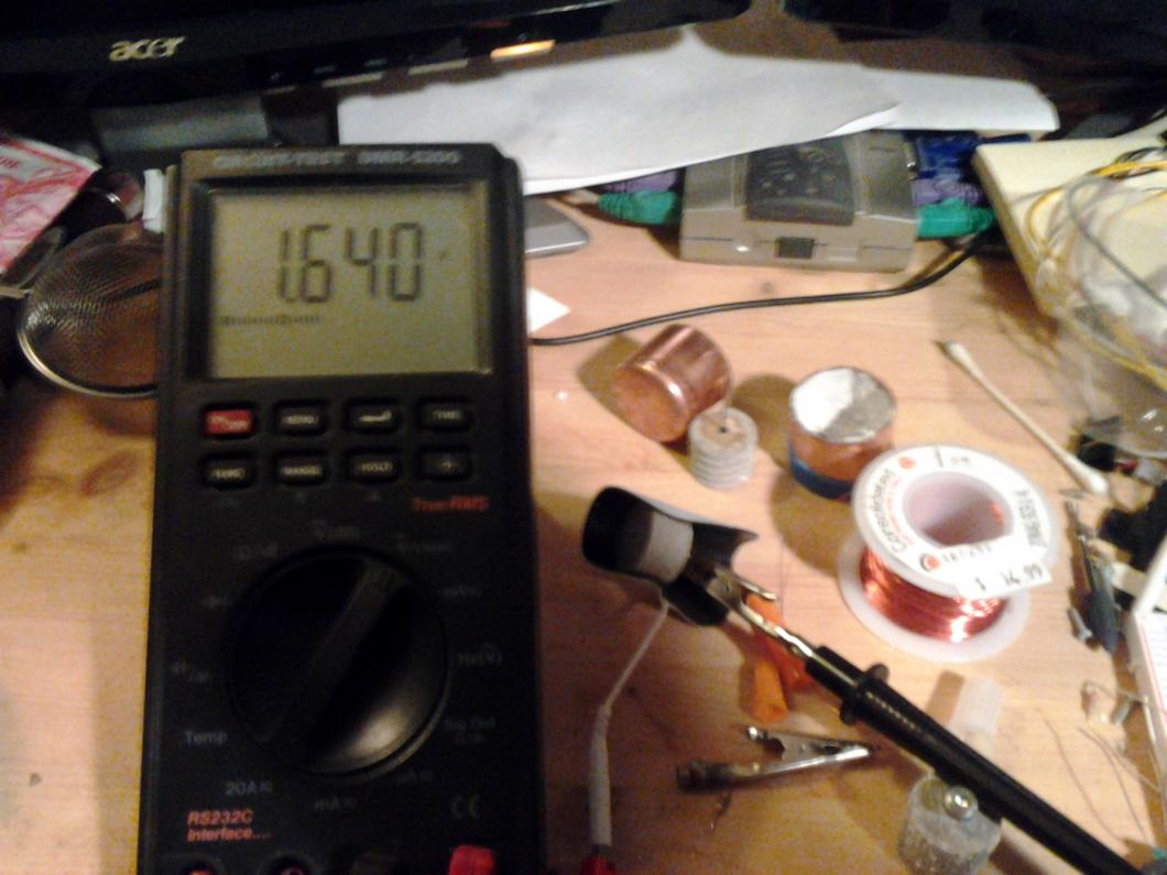

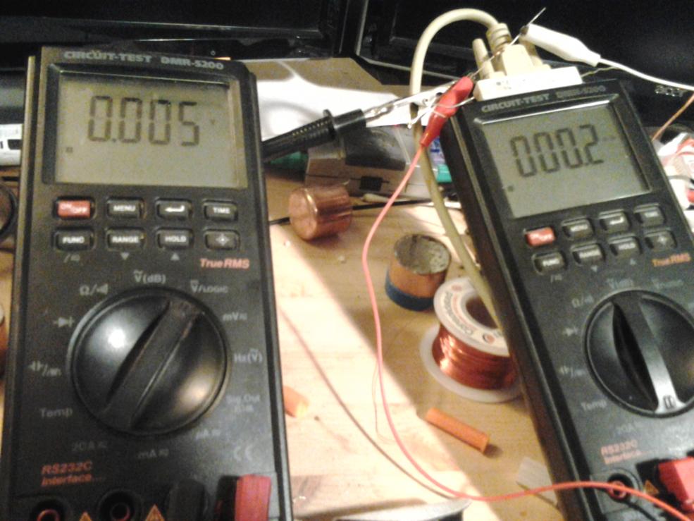

Here are the cells taken apart. As you can see the voltage coming accross is at 1.64 volts. I then load it with a 100 ohm resistor and a 20 ohm resistor (not at the same time) the voltage is 0.005 volts and the 0.2 millamps ... it is the same with both resistors. And it will just stay there. If you take the load off the voltage jumps back in about 1 - 2 secs.

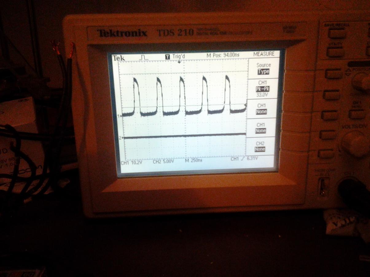

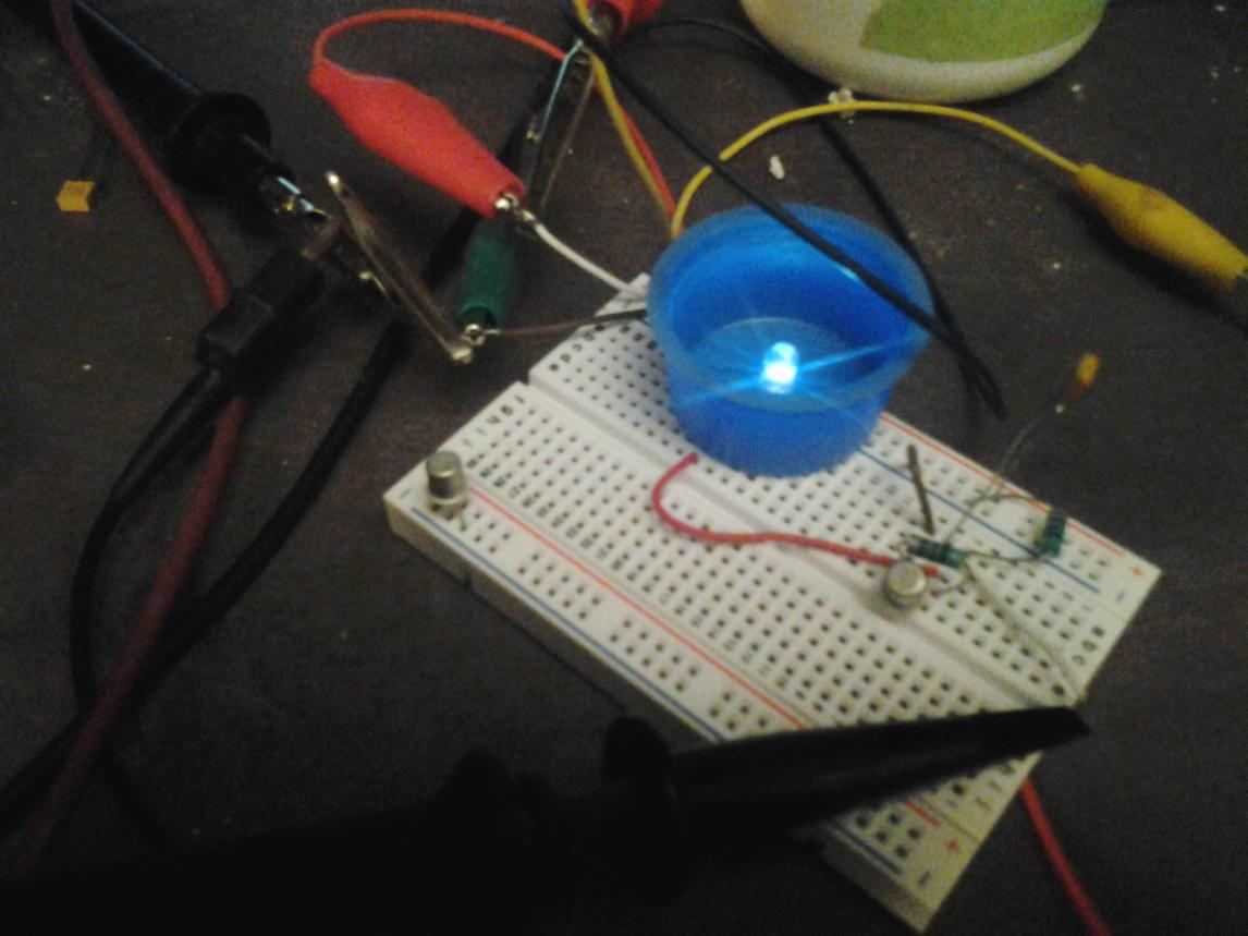

Okay, I have now put a the John Bedini earth light circuit on, I am only using 1 battery, before it used to take two to get an Led to light up. Will post the results when it runs out or in a couple of days ... what ever comes first.
The first batteries and Led bank are still running at the same voltage and current as the last post. I do not see them stopping at this point.

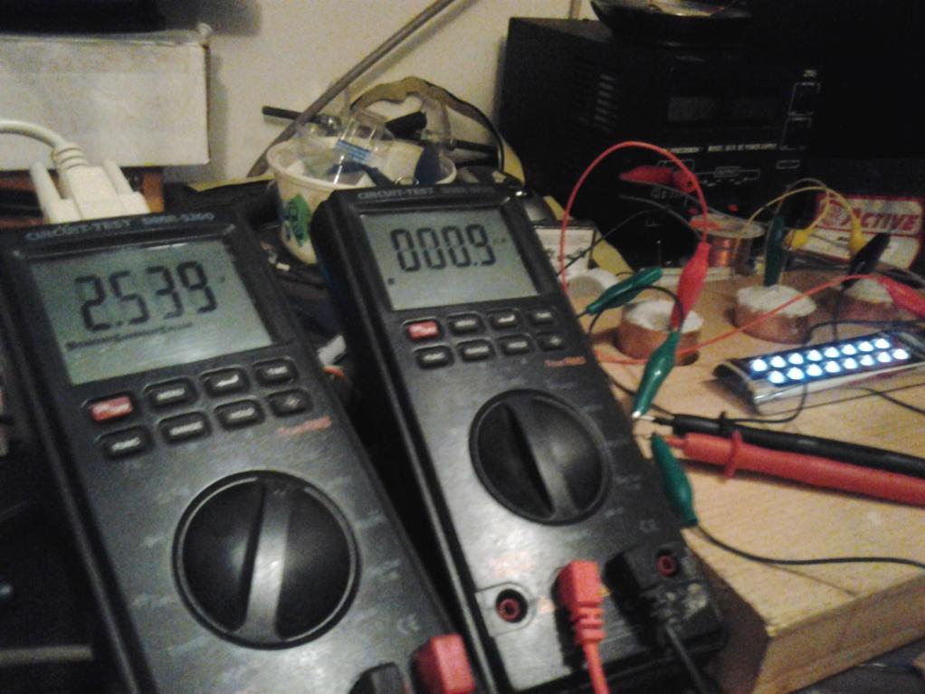

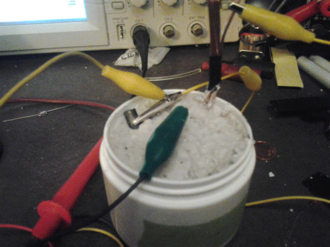

Update on few things, I have have running mix 5 for awhile now. One of the problems that I found with my cell is that it only ran with the earth light circuit for a few hours, with good illumination, then it went out. As most cells are constanstly changing their impedance values away must be devised to compensate easily. My cells seem to find their own impedance match to the LED's, the cell works in such a way that it does not want to create power in excess, like most I am thinking. In these photo's I am using a carbon rod anode / specially formed Mg cathode and a copper wire impedance ballancing circuit (8 ohm resistor) connected between the carbon rod and the copper wire. The earth light circuit now stays active and it LED is bright. I am using a LUX meter at a set distance to measure the power with and with out the circuit, the metering change the balance of the circuit when left connected or even used. This setup has been now running for the last 4 days with no loss and infact a small gain since it found its balanced.
The first is the combined voltage and then the voltage at the resistor.

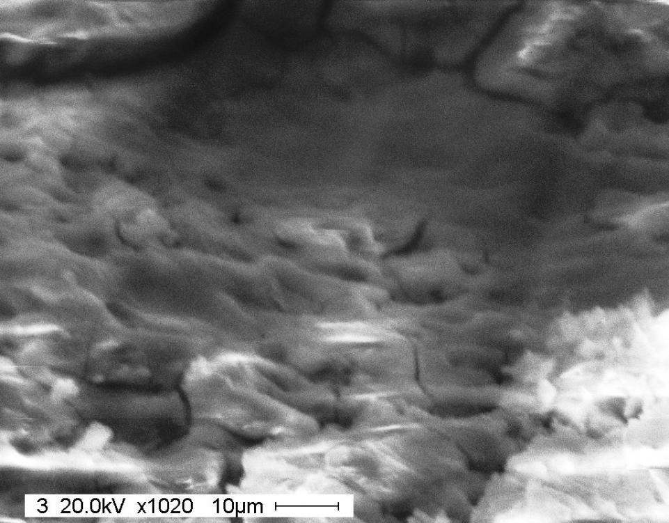

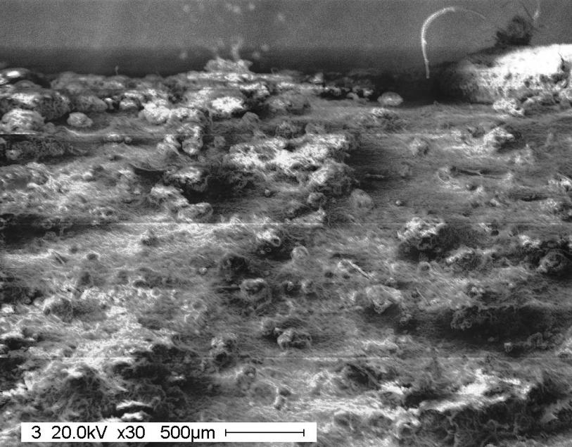

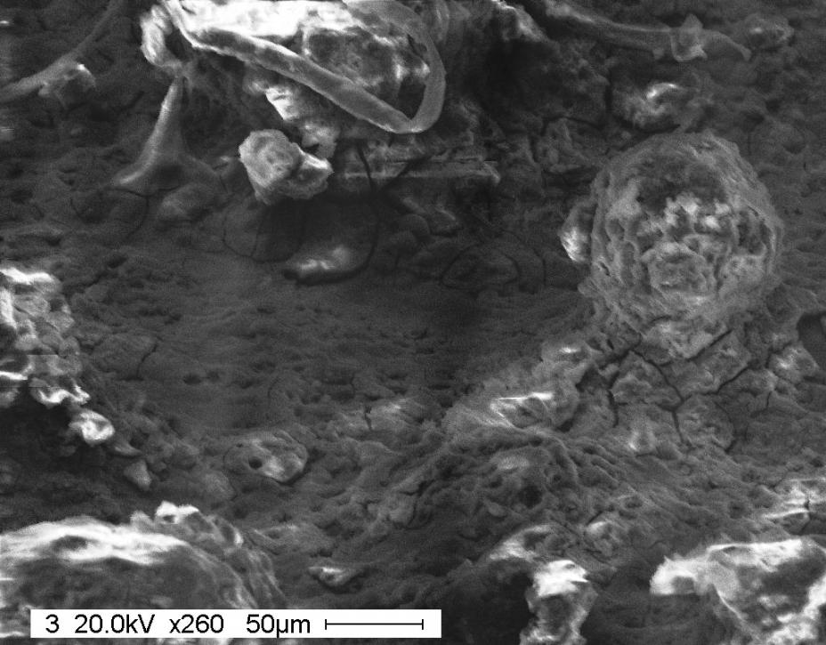

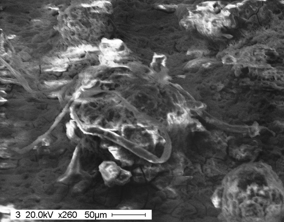

okay here is some imaging - this the surface of the Mg after forming and being in use ... this cell was taken apart after 3 weeks of continuos use and was still working

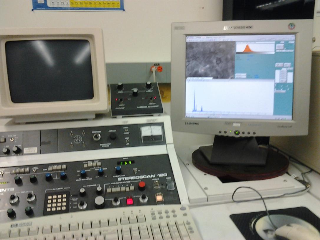

The very light areas are not absorbing any electrons from the scope, the dark area circles/pockets - I call them energy aborbing pockets-are void of anything - spectrum analisys- vacuum if you want -as the imagery is done inside a vacuum - this a 3 layer formation - i do not have each layer formation at this time.Last edited by nickle989; 10-26-2012, 01:45 PM.
