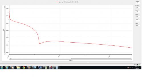

I don't have a battery charger (except the SG) so I used a transformer and rectifier to put current onto the battery (about 2.5 amps). The voltage while charging is about 16V and you can see the attached curve to see what it does under load. This curve is after charging @ 2.5 amps for 4 hrs. I only got 1A for about 20 minutes. The graph might be a bit hard to see but the big notch there is at about 7V.
