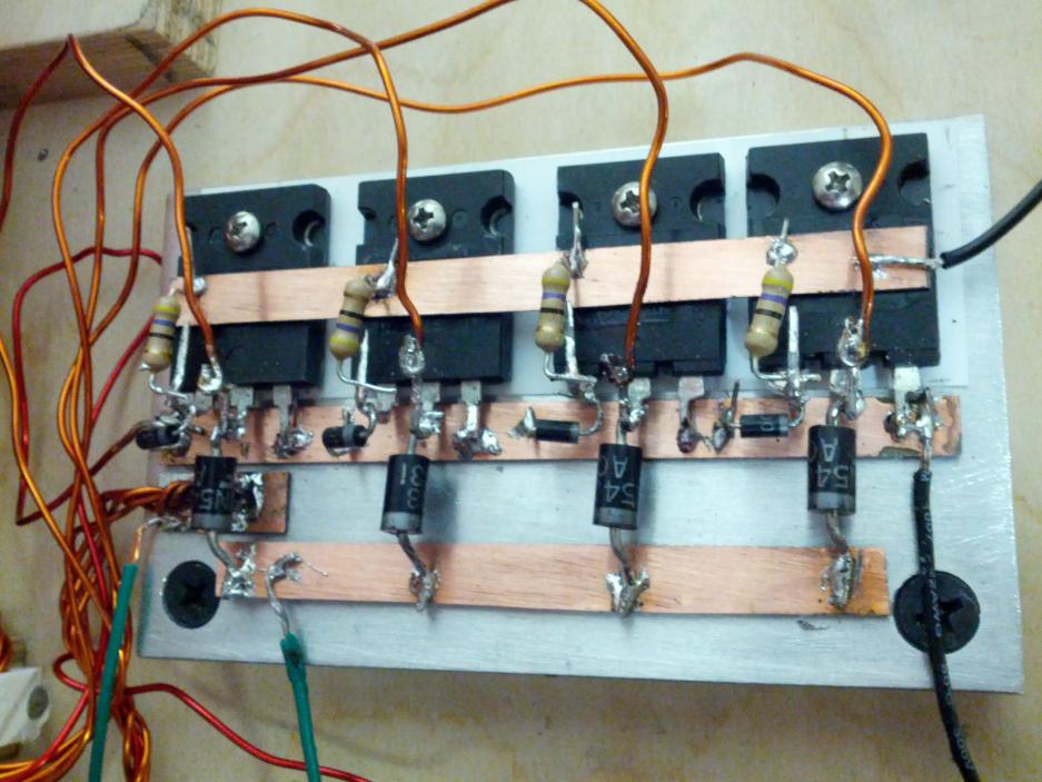

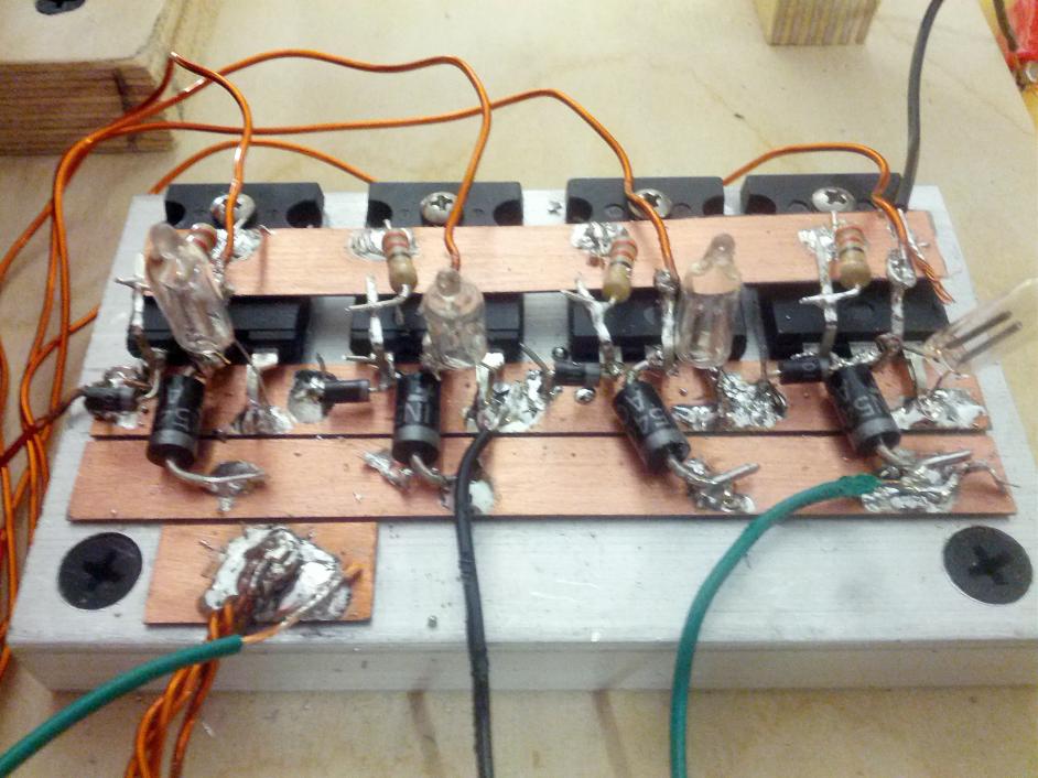

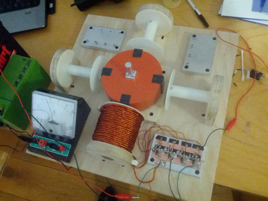

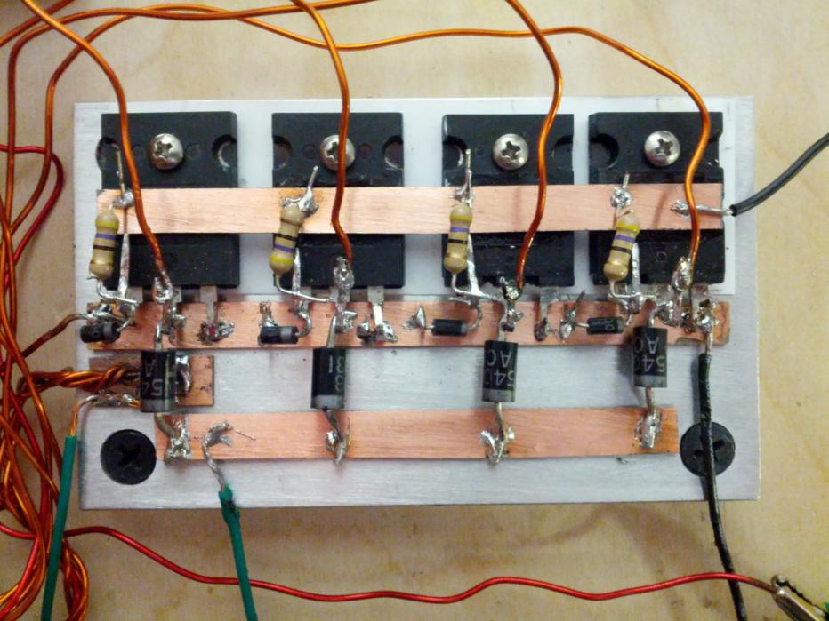

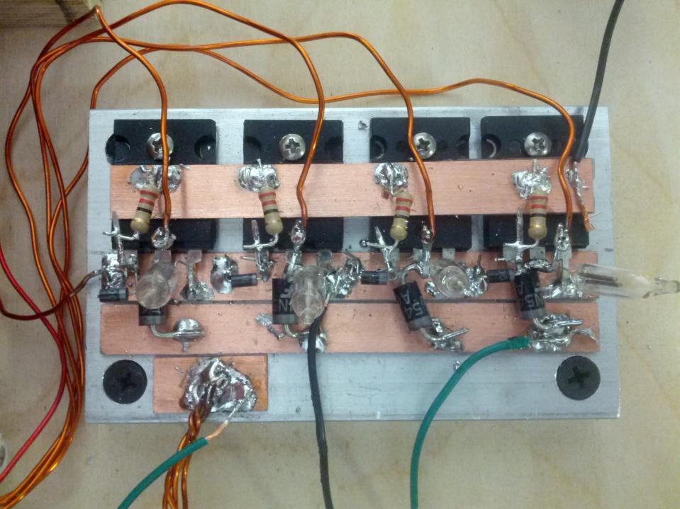

I have recently finished building this motor, but I am having problems tuning it, and just making it run stably.
The coil is 5-filar, all 18 AWG wire, litzed, wound to 1.2 Ohms, and R60 welding rods for the core. I have 4 superpole ferrite magnets on the rotor. All 4 MJL21194 transistors are matched, as are the 1N5408 diodes. The free spin time is relatively low, but I think that's because I'm not able to spin it very fast by hand and it doesn't have the size of a bike wheel or something big like that.
I started with a base resistance of 100 Ohms, but it wouldn't run at that (although I could see some spikes on the scope). So I lowered the base to around 60 Ohms, and it was barely able to sustain itself. I then lowered it again to around 40 Ohms, and it runs, but at a very low speed. I lowered it even more to 22 Ohms but it still runs at a very low speed and draws too much current, around 2 Amps.
I am skeptical to lower it even more. I don't know if I am doing something wrong or if superpole set-ups run on very low resistance. I wanted to ask you guys before I blow up the circuit.
