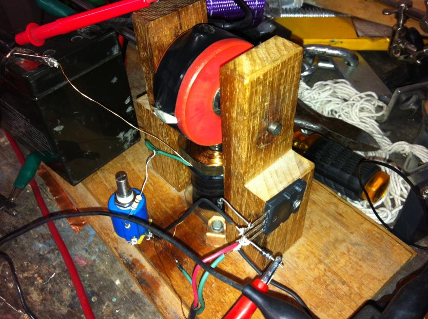

    This old dinosaur, my first ever SG from 12 years ago gives a 2.38 COP on the output battery and that doesn't even include mechanical work. That is just one recent test.
    Circuit is MJl21194, both trigger and spike diodes are 1N4007 and base resistor is 60 ohms with a 1k 10 turn precision pot in series. Rotor is pink roller skate wheel from a $2 pair of roller skates from the good will with bearings in fair condition. I'm actually using neos - 3/8" thick double stacked neos...1 recessed into the wheel flush and the 2nd on top of that. Magnets are every 90 degrees and it is running in the enhanced mode described in Bedini SG - The Complete Beginner's Handbook. The power windings is 23 awg and trigger is 26 awg. The power winding is 4 ohms so that tells you how long it is. I built it originally with a MPS 8099 and followed the instructions in the original SG diagram posted on Keelynet WAY back.

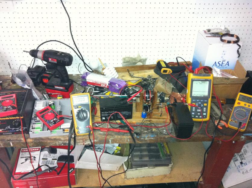

    For this particular test, I used different batteries than are shown in the pictures. In the pictures are 12v 7ah gel cells that were from an electric scooter. I used to charge those up with a bicycle wheel trifilar SG and used to drive it down to John Bedini's shop when I worked at a pulsed light healing device company down the street about 10 years ago or so. They're not in perfect shape but it is a miracle they're even half way good considering the agony and torment that I've put them through.
    Anyway, for the COP test I did yesterday, I used 18v nicads from a Black & Decker Grasshog trimmer. They are rated at 1200 mah or 1.2 Ah.
    Looks like this:

    I used a Fluke Scopemeter 123 for the test. It is 2 channels. I had a 0.25 ohm calibrated current sensing resistor on the ground line of the input battery and had both channels across that resistor.
    Input battery went from 18.83 to 18.20 and I ran it with a battery on the back end for 32 minutes.
