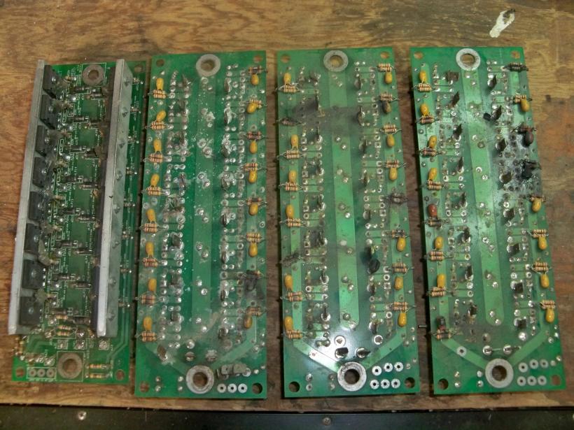

the pic below shows the 3 Fogal mod'ed PCB's bottom side with the burned up parts, and the one on the left is the top side of a standard SSG PCB that has several blown trannys too (I blew them up, when your pushing the envelope, things happen)........

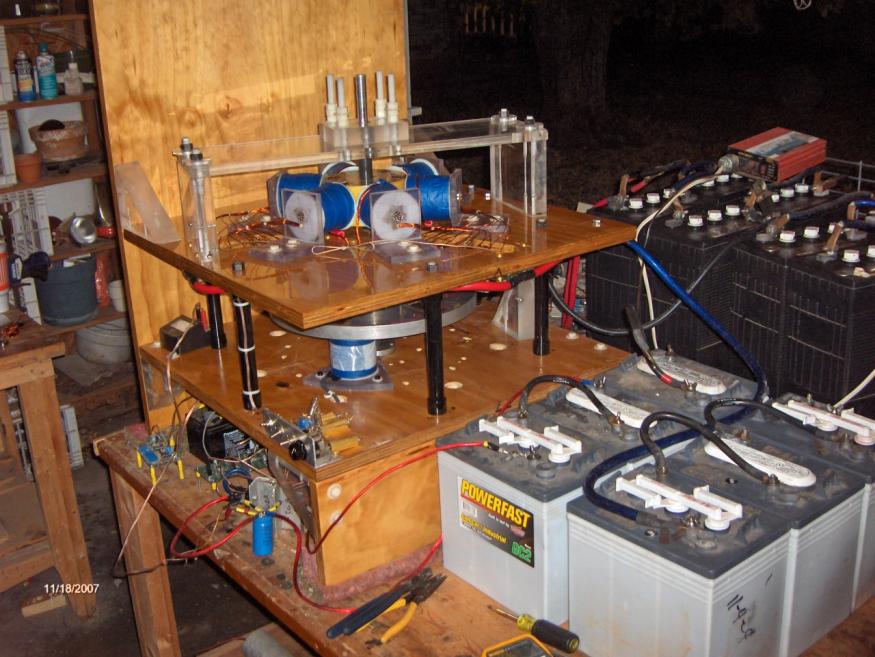

next pic is the Dan B SSG machine when we first got it running. it does not show all the equipment currently there, as all that was built later......
it was nice and shiny then, now it's quite dusty and will need a good cleaning and electrical reconnecting to get it all back to running in it's new location in my new shop......

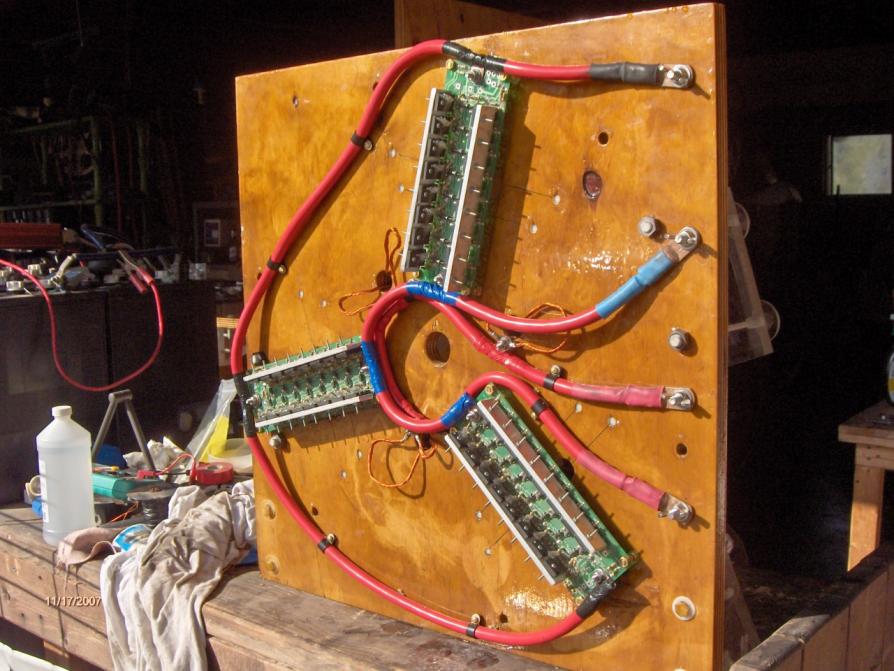

the 3rd pic shows the PCB's mounted to the bottom side of the coil platform
