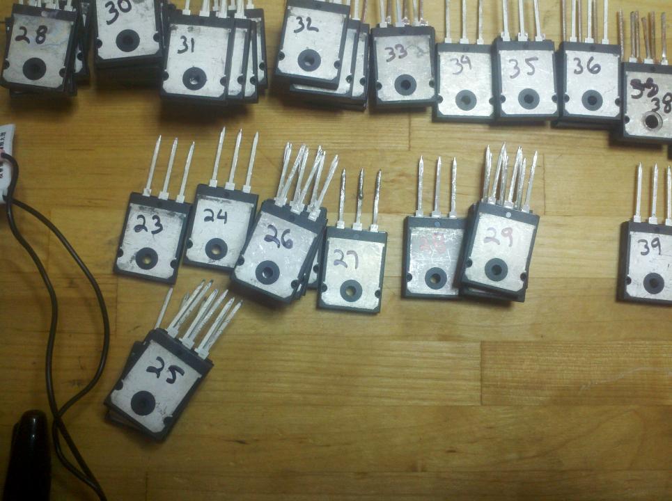

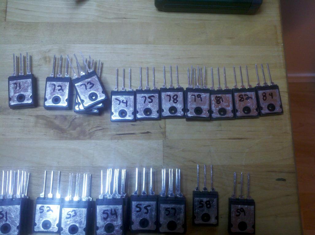

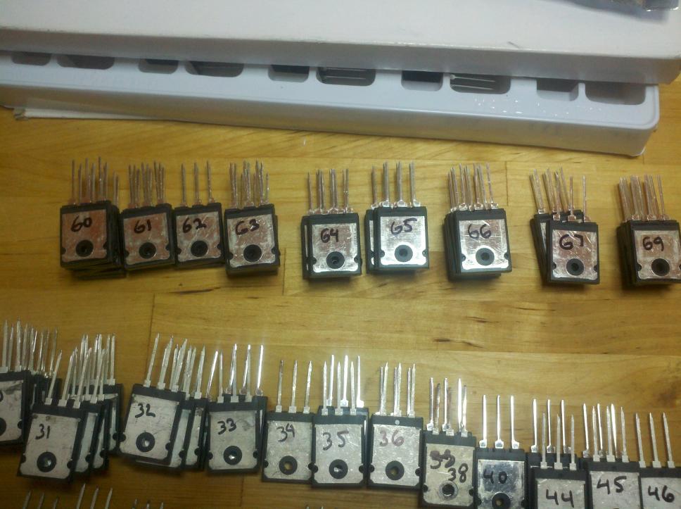

    I recently purchased 100 MJL 21194 and 100 MJL 21193. the first thing I wanted to do was match them, using a common method, the Hfe on my multi meter. I made 3 clip leads with wire so I could easily attach them to the transistor without having to bend the transistor legs to fit in the holes as they were way too close together. I figured with 100 transistors I should have no problem getting a large amount to match. These trannies are from a single lot number from on semiconductor.
    Well here are some pics of what I discovered.

    The lowest Hfe value was 23 the highest was 84. There was a bell curve very noticable, in that in between the 50 and 70 range were the most transistors. Even with this there was a huge difference in gain from the lowest to the highest. So you can imagine if you have a string of 4 or 8 transistors and you had one with an Hfe of 23 and one with an Hfe of 84, how unbalanced your circuit would be.
    What was also interesting to note, was that if I held the transistor in my hand with my thumb on the back, it would heat it up a bit and the gain would go up as much as 3 points over a peroid of a few minutes.
    Now add to this that if you were building a full bipolar circuit you would have to match the 93's and the 94's so both sides of the switch interacted with the coil the same way.
    So to put this out to the group, you have all of these differences, how would you mathc the gain board to board? I know how I would do it, but I want some more ideas.
