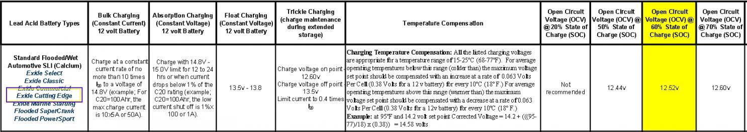

It looks like Exide is the manufacturer of these Napa batteries. I looked on their website for some recommended D.O.D. specs. They are saying 20 percent is NOT recommended. 50 percent is the lowest they are recommending from their PDF, which is 12.44V.
Here is a link to the doc: http://exide.com/Media/files/Downloa...7;205_9_13.pdf
So...should I go ahead and following the manufacturers recommendations here, or go lower due to the nature of the SG machine and how it charges?
