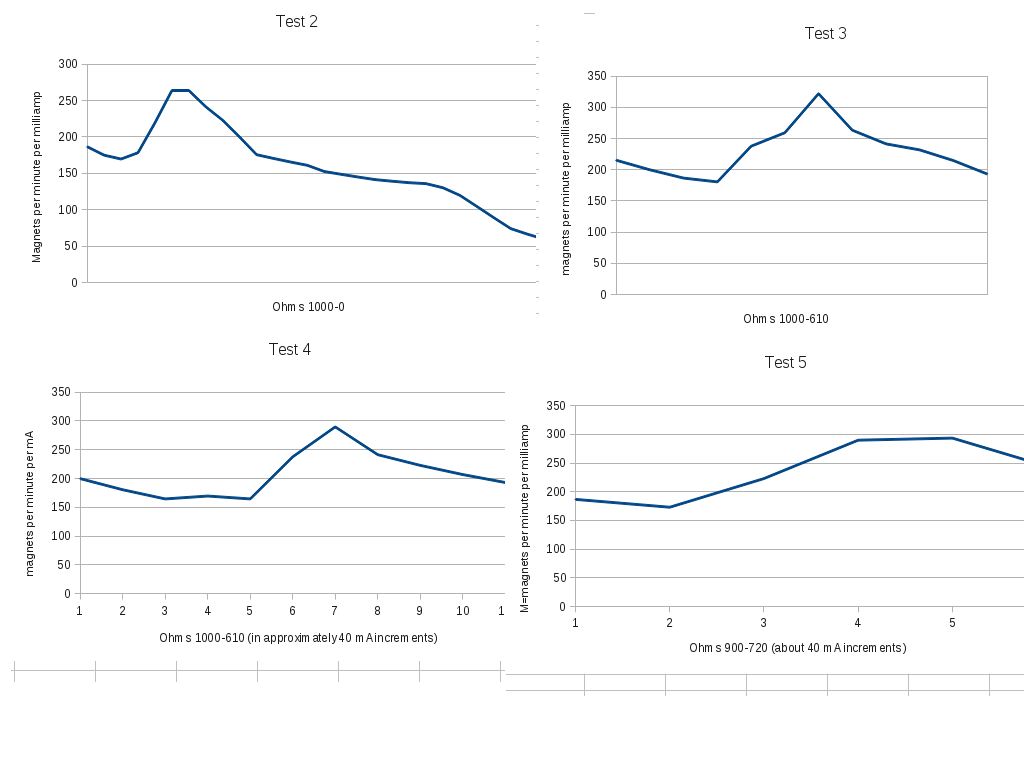

Wanted to post my tuning data, looks like I have a good spot at about 800 ohms
. I changed the range of the Ohms I measured as I zeroed in on sucessive tests. Same peak seems to show up in the range of 810-780 Ohms or so.
Mike
edit: on the graphs the "40 mA increments" should be "40 Ohm increments."
