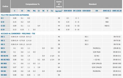

          Hi everybody,
          I found this chart about welding rods categories..
          Looks like R60 in Europe is the G2, R60-G is G3 and R45 is G1..
          In Europe you can find them easily on eBay
          Check it out
