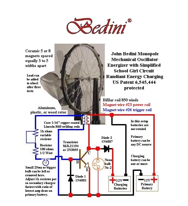

Anybody have any idea what might be wrong? I have double checked everything. My coil is hooked up right (exactly the way it is in this picture) Like I said, both coils worked fine with my shopping cart wheel rotor as long as I gave it a hard spin to start (and put the magnet on the backend). Why is my coil not repelling? And why won't it turn the bike wheel? I ran it off the shopping cart wheel on 9volt batteries, but it won't run the bike wheel hooked up to the solar panel.
