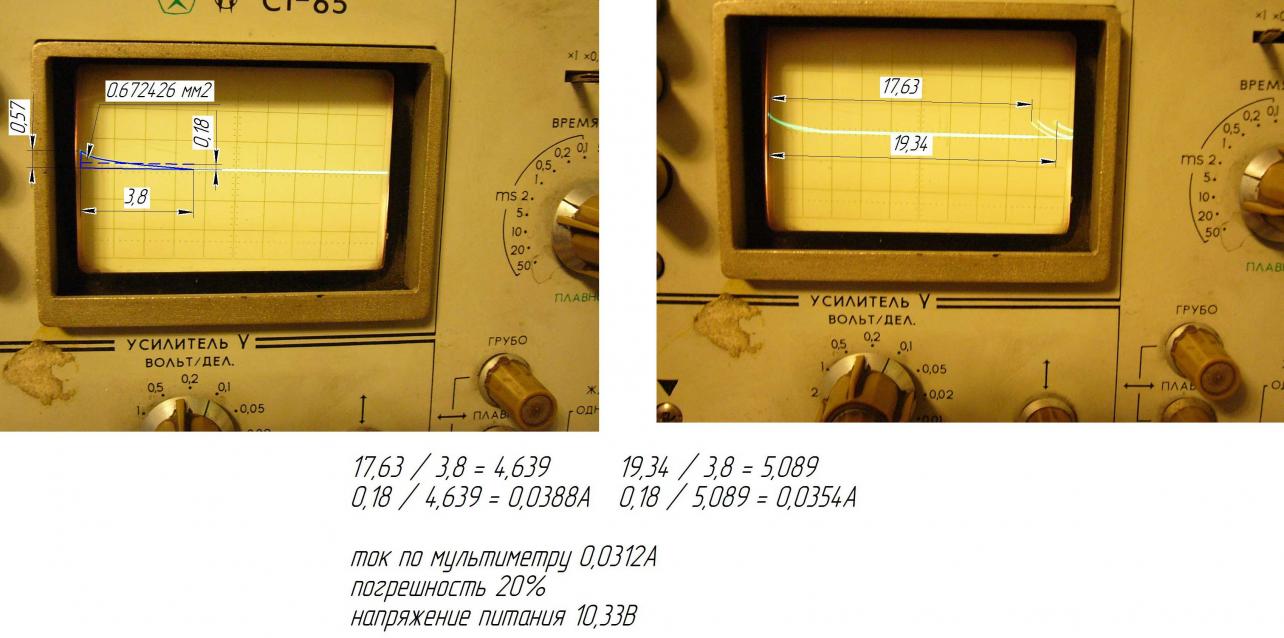

I measure the the amperage on the oscilloscope. For this, I connect 1 ohm resistor in series with the secondary battery. And the recorded waveform voltage to the resistor. In this 1Volt must equal 1 Amp. Is that correct? I then, with the help of design software, creating a large-scale chart, and calculate the area under it. Then I calculate the average current pulse. Then, I divide it by the ratio of the pulse duration to the time between pulses. Get current flowing into the secondary battery. Here is a picture illustrating it

Constantin,
1- your wire length is too long bring it down to 130 feet, bifilar. that is the specification for wire that size.
2- the 1 ohm resistor test is where you REPLACE the charging battery with a 1 ohm resistor. if the resistor heats up you are using too much cuurrent.
3- do NOT measure the current on the charge side, only worry about what is coming out of the primary.
4- from the video, the washer is magnetized that is why it is hanging on to the transformet laminations. can you get any welding rod?
5- tune the machine with THE PRIMARY CURRENT. use your ammeter setting on your multimeter.
