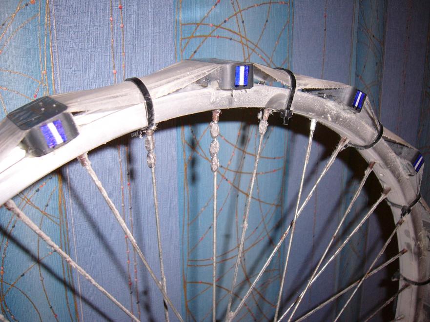

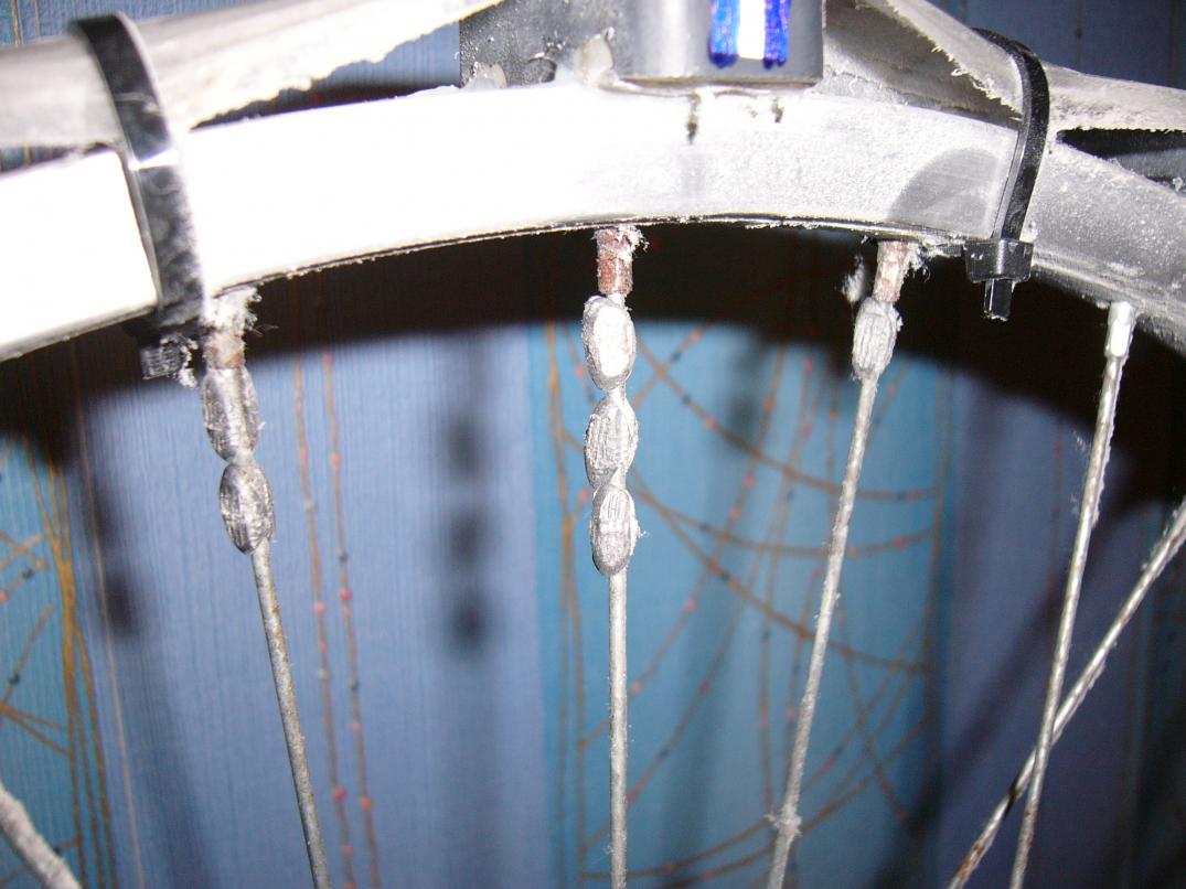

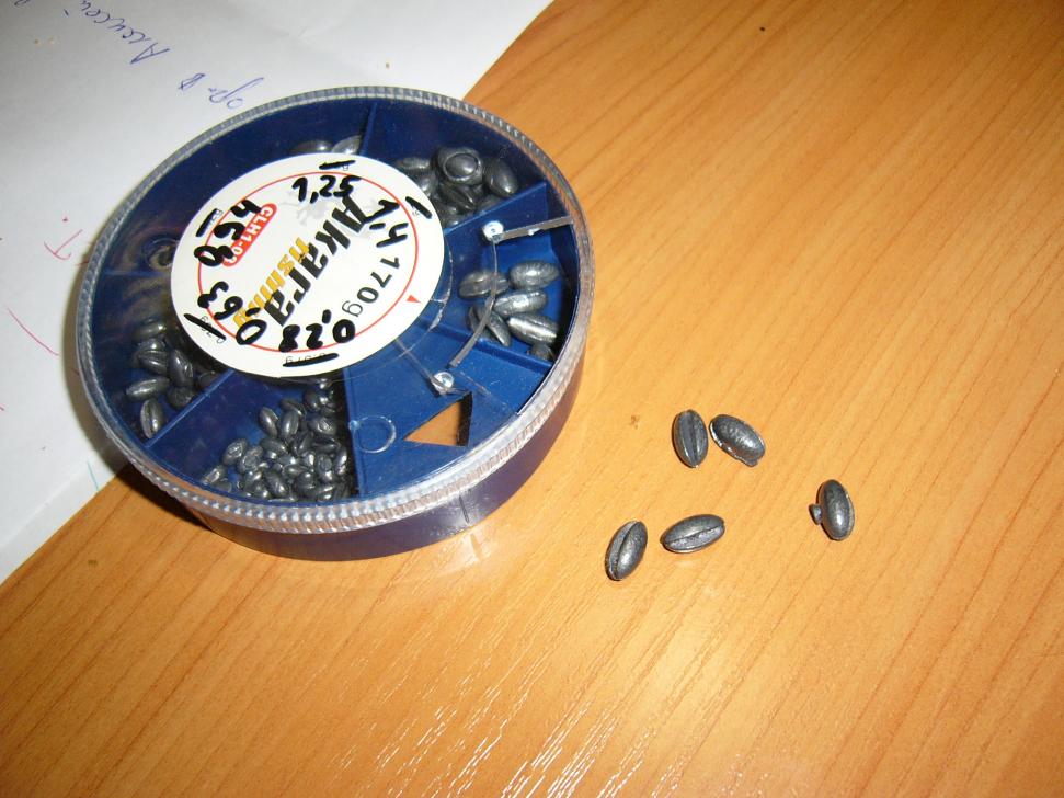

                I've only just found this thread and decided to share my own way. I did as well as balancing Barrie Castle. I used fishing sinkers instead of glue. It did not take much time. Click image for larger version
ID:	45216Click image for larger version
ID:	45217Click image for larger version
                I hope it will help someone.
                Konstantin.
