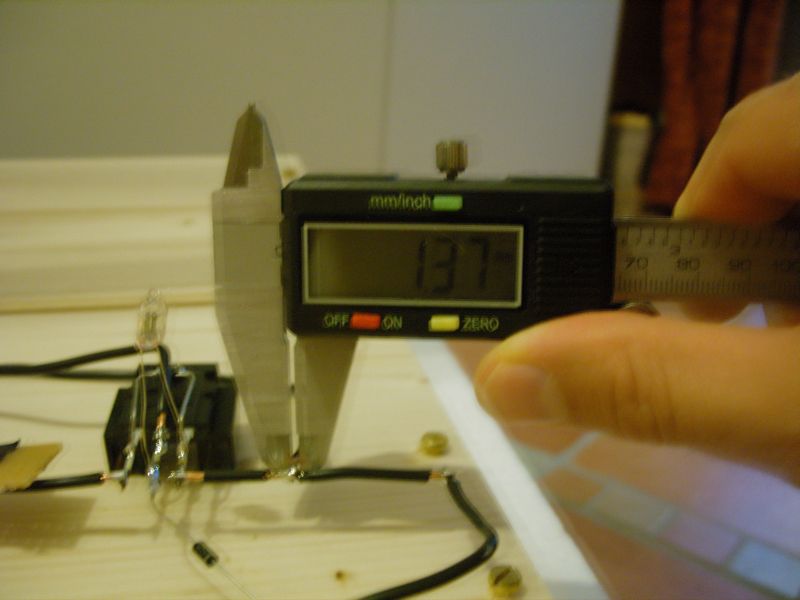

                      i use solid wire diameter 1.37 mm ( measured without coating ) all over the place in my bicycle vanila ssg
                      AWG15 diam 1,449578mm
                      AWG16 diam 1,290828mm
                      should be big enough i guess..

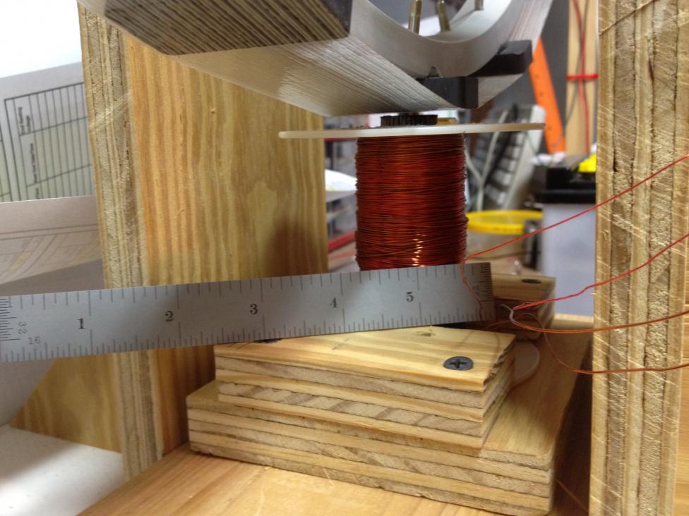

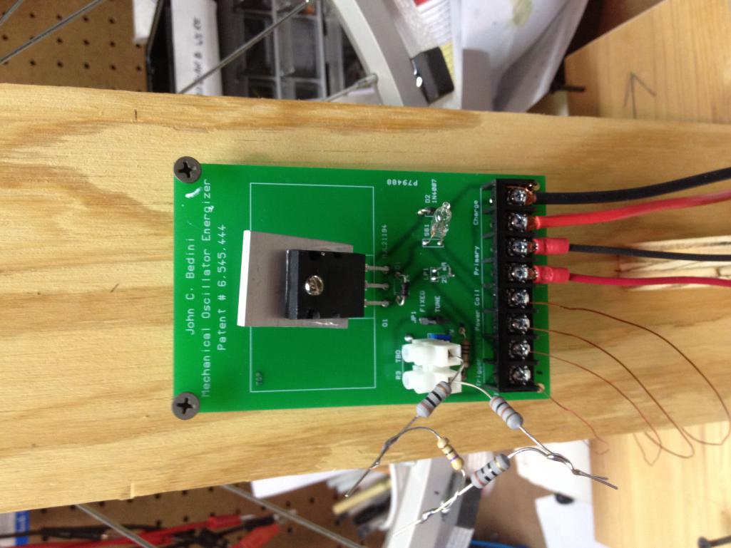

                        John, thanks for the reply.
                        I attached some pics. The coil is the standard one from Rick I bought close to 2 years ago along with the circuit board. I think its the same one he sells now. I believe the coil wires are #23 and #26 with 900 turns. Working on this I have increased the charging ability from when I first put it together.
                        Free spin time is about 8 mins, #10 wire to charging battery, I have a 22" aluminum bicycle wheel with 18 magnets, also the magnets from Rick. The wheel has 36 spokes so 18 was a great way to take advantage of placing the magnets very other spoke.
                        7 Ah batteries, they were new when I started.
                        Charging for longer than 4 days the voltage only tops out at about 14.6 - 14.7 tops.
                        The SSG functionally works, just takes a long, long time to charge to 14.5v, and perhaps matching the coil to the battery as John says is an answer.
                        The "spider" of resistors is what I use once I've found the sweet spot to jumper the pot.
                        Alex

                          I'll be interested to see what is holding you up. I am in the process of switching from the 3PM Kit (not much luck with it) to building the bicycle wheel monopole...and everything you described above is what I had planned on doing. Pretty much just following the instructions from the experiment doc exactly.
                          I'll probably just wind my coil from the start with #19 and #26 wire per JB's suggestion...unless there is some risk of overpowering small batteries (I have 5AH batteries).
                          Hopefully you can post again if you try a different coil and get better results.
