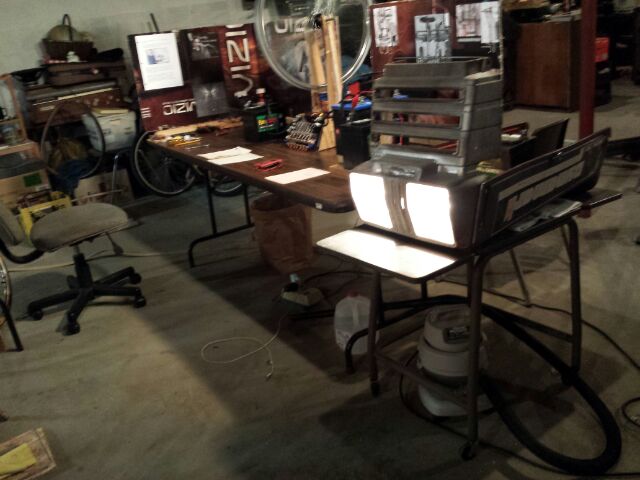

you should not have any problems getting those batteries above 15 if the ones in the picture are the ones you are referring to. a fuly charged battery RESTING voltage is 12.8 or so. however that is not what you need to charge to. a commercial battery charger will charge a battery to 14.5 that is considered full, an Energenx charger built by John will charge to 15.3

thanks..need to get my prime battery in shape as you say for sure. I get what your saying about the careful discharge to "flip"over and accomplish actual desulphation. I always watch the discharge and following your guideline..those headlights are from the lawn tractor designed to run on tractor battery I'm using as prime run battery. I can reduce to just one light or use a different size load as you might suggest..??
