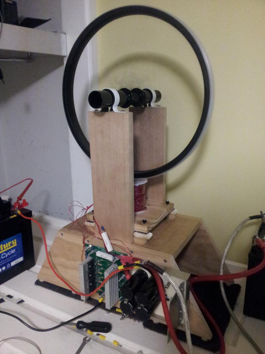

I have been mucking around with my SSG's magnet spacing, wheel size, coil gap and base resistance, nothing very scientific or well recorded, just general fiddling and watching what happens to charge rates, RPM's etc.

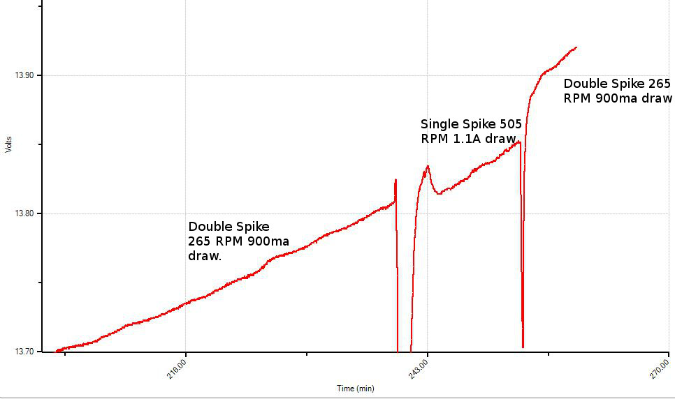

One thing I have noticed is that my SSG "seems" to perform better when it's double spiking. The amp draw can be all over the place and I can usually alter the coil gap to smooth that out a little but in general, having a lower RPM, double spike means increased charge rate and lower amp draw!?
If I go single spike my wheel goes flat out and gives me the warm and fuzzies like it's pounding the charge battery but if I go to the slower "clunkity, clunk" double spike performance seems better.
I was just curious whether anyone uses the double spike all the time and whether JB's machine is single or double spike?

? So in theory if I have a battery that can cope with the single spike it may charge better than double (or triple) spike.
