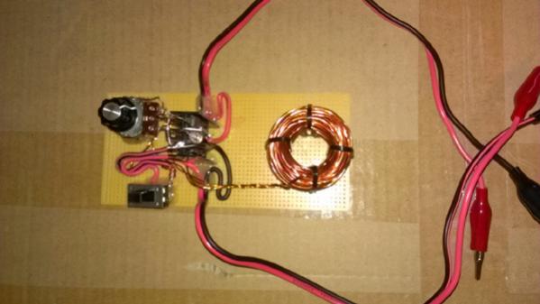

    Here is a picture of it.

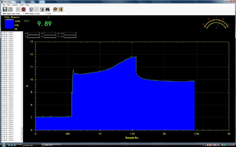

    The first chart is of a 9v Ni-MH. This charge was pulling about 200ma from the primary.
    Here is a video I shot while doing these sample runs:

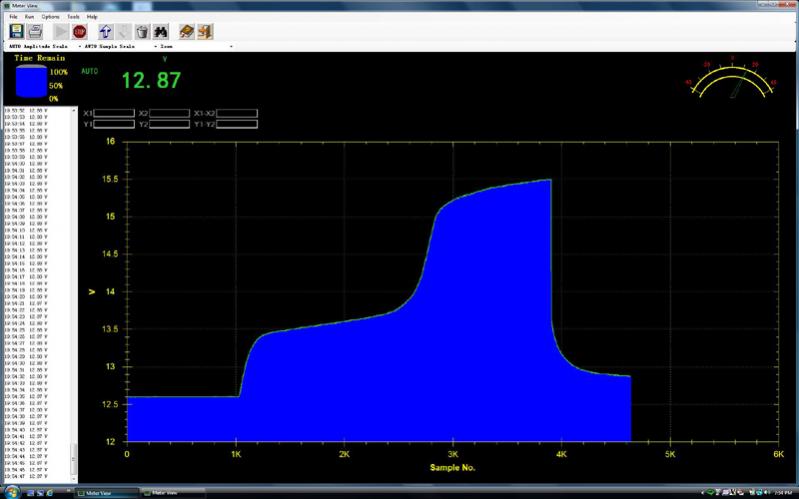

    I finished up with the 5AH 12v that was the primary in the first two charges, just topping it off. This charge was pulling between 600 – 700 ma from a different primary.
    http://1drv.ms/1Pe3zfL
