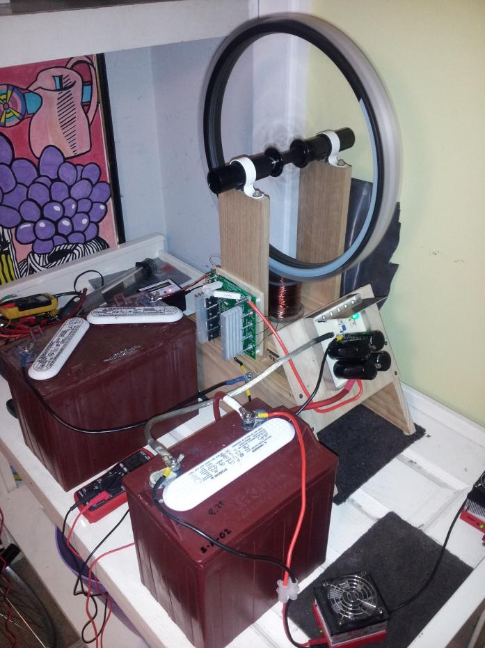

                  I thought it would be fun to post some updated pics of what my SSG looks like now. It's been through countless experiments and is now settled in for a rather large Trojan 8V battery rejuvination project. It's about to get some backup from a second SSG and a Tesla charger otherwise I will be waiting a long... long time.
                  I moved the Comparator so it receives the airflow of the wheel so I needn't cool the heatsink with a separate fan, works really well.

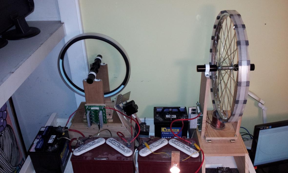

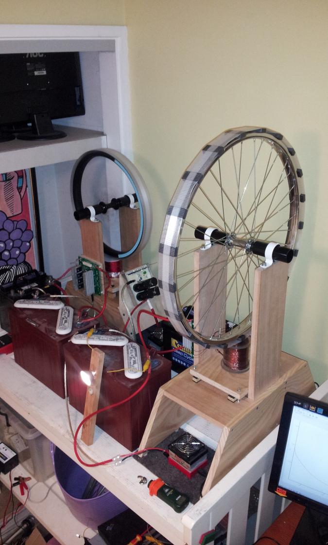

                          I built my second SSG a couple of weeks back. It's the bigger brother of my existing SSG. The frame is slightly larger and fitted out with the classic SSG specs, 26" steel rim x 21 magnets, Teslagenx board but with a 9 filar coil from http://www.aussiecoils.com to use all 8 Transistors. Some good news is that I got 1:1 in gen mode, hurray!!!, but in radiant mode it still eludes me I'm really starting to think the batteries I bought for testing are garbage. I'll probably do some more COP testing in a few weeks and might post a youtube vid.
                          So here they are working on some 12V Trojan's, Big Woody is taking a rest at the moment while I pull some energy out of it's charge battery. More good news is that these 12V Trojan's are coming good! I can now top 2 of them on my TST5 after having pummled them with my Comparator and Radiant charging. The other 2 haven't been in the rejunation cycle that long but I'm sure they will come good as well.
