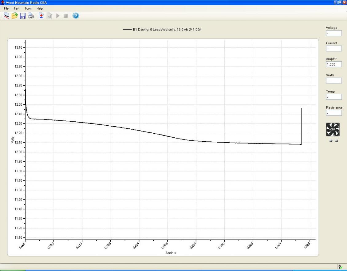

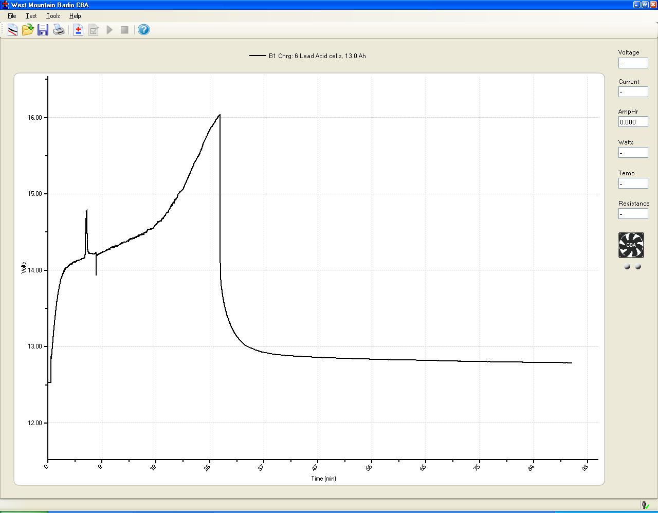

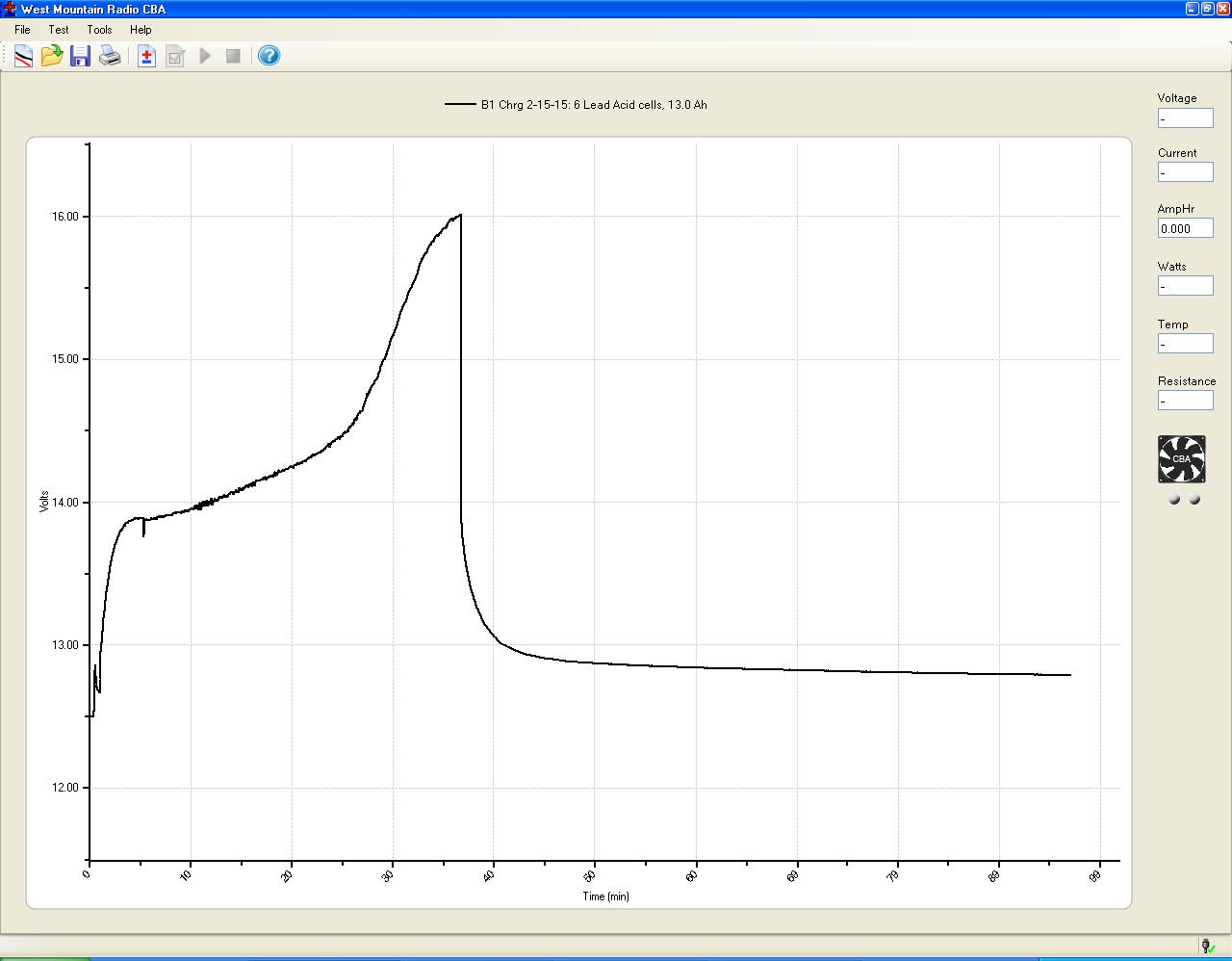

                      @Tom ............Thanks Tom My dad passed away shortly after I got home from the conference, so my sister and I had to spend a lot of time settling his estate. Then I bought a go kart for the grandkids. That, the Bradley, and some honey-do jobs took up the rest of the year. Then there were a couple of one week vacations and the holidays thrown in. Family first you know!
                      @Hobbyrobotic ...............Those were the two charge curves I reported on. I'll try uploading a screen shot of them and the last discharge curve as well latter today or tomorrow.

                      • #56
                        Hi Hobbyrobotic,
                        Here's the page scans of the two charge curves and the discharge curve in between.
Name:	2-14-14 charge graph.JPG
ID:	46091Click image for larger version
Name:	2-15-14 one AH Discharge.jpg
ID:	46092Click image for larger version
Name:	2-15-14 Charge Curve.JPG
