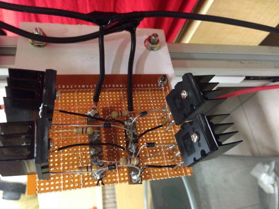

        Thanks for the advice I'm not getting any good result . I suppose it is the primary battery that is not fully charged. Are the transistors to be hot or warm to the touch when the motor is running? Because I have only 4 transistors that is running warm, the rest of the 8 transistors are around room temperature when I touched it. Sorry that I have a lot of questions to ask. haha. O well shall do the test over again with a fully charged primary battery.
        Cheers
        attached is my circuit board for 1 spool (heatsink attached)

        • #19
          Mark.....
          not sure where to start. multi coil machines are hard to tune and are not easy to get decent charging from. you do not have spec coils, your frame is aluminum which is paramagnetic and will create eddy currents. most likely your magnets are not perfectly spaced and your coils are not perfectly at 120 degrees apart, that is the most likely cause of heat, one coil is fighting the other two. you have built a machine that will give you headaches for a long time I dont know how your coils will perform. the best thing you can do for now is build a completely wooden frame, use 1 coil and circuit, and experiment with that. also a pair of smaller 5 to 7 AH batteries will be good for that size, maybe....... dont know with the coils you have. there are too many variables both electronic and mechanical to be able to diagnose them all.
          before going any farther or spending any more cash I would encourage you to do a LOT of reading on the subject, this forum especially there is a lot of great info from a bunch of great guys.

          • #20
            Hi all,
            I can only recommend everybody who is not realy familiar with this technology to do what Tom C and John Koorn says.Its not allways a answer which makes happy because it means you have to built something new,but we can be happy that there are people which helping others.Thank you that you bring my head from time to time in the right direction.

            • #21
              Mark,
              It is apparent that coil alignment is highly critical. I have encountered the same. See the start of the this thread to see a similar report.
              Followed by my diagnosis with a dual trace 100MHZ CRO.
              Tom is spot on and if you intend to build a multi-coil machine it will need to be to spec, with non magnetic support structure wood or plastic and exacting in tolerances for your coils and magnets.
              If you go down this path expect to consume $$$$ in copper wire alone. Its not something that can be put together in a hurry but methodically planned and executed. That why JB states that it cost him tens of thousands to build his ten coiler.
              I hope that doesn't put you off! It is just a statement of fact! Know your machine, how it works, how it can be tweaked and what gets the best results. Then PLAN meticulously for a multicoil. We all start with big ideas and then find out how precise we need to be and that precise tuning that makes the difference between less than OU and OU. Many of us here are still plugging away at it after some years. Sadly I can not yet report OU after 2 years. But my understanding is streets ahead of where it was even 6 months after starting. It can be frustrating hearing others say this, but in hindsight I can say they are kind words of wisdom. I tried to run fast but needed time to absorb and understand, then learn for myself, through personal experimentation.
              I wish you the best in your progress.
              James

                Mark.....
                Ah! It makes so much sense that 1 coil is fighting with the other 2 coils. I shall change it to 90 degree instead or 120 degree, to at least align it better. I'm having 4coils/spool. Well... need to save up for another wooden frame build and of course, more research. haha. Meantime will try with smaller batteries and see how's the result. I've tried with 3.2aH, doesn't seem that bad.

                  Yeah, im changing into 90 degrees instead. Will be tweaking this build before I go for another wooden model. Today I've tried to charge a dead 1.3aH lead-acid battery with a voltage of 2.33V. It fried my transistors! It was so hot i burnt my fingers. O well, shall stay away from dead battery after I've done sufficient research. And nope it doesn't put me off! I will get a working model! hahaha
                  Thanks James!
