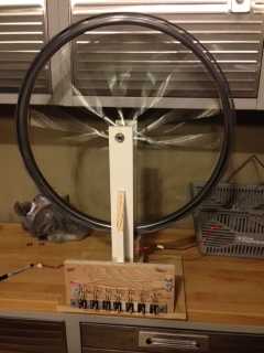

ID:	46041 That's my setup so far. Of course the batteries are hooked up, but I didn't put a shaft on it. This was a little before completion.
      Tom, the hub nuts are not tight at all. It seems that in order to get better freewheeling, you have to tighten to the point where you have binding, and then back off a slight bit. After the removal of all the grease with solvent and the addition of wd-40, and before assembly, i can spin the spindle very freely and it just zips away. I do get the clicking sound in the bearings too yes. I will have to remove my coil and I will try again to see if I can work with it. I would just figure a pillow block and good bearings would help to decrease the slop that is in the spindle with the crappy basket bearings. Paul
