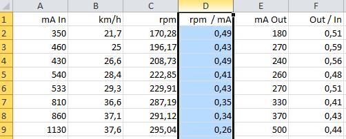

                Before that, I tuned my machine finding several sweet spots. I didn't go higher in amps, as with around 300 rpm I didn't trust my construction any more, if I should go that way, I need to make the arms for the wheel stronger and probably have to balance the wheel a little bit better. With 230 rpm's everything seems to be much smoother.
                For checking the speed, I use a bicycle Speed meter with magnetic coupling, and calculated with a formula km/h into rpm.
                In the input line is an analogue Amp meter, in front of the Output Battery is another analogue amp meter.
                Main exercise was finding the spot with the highest rpm per mA. As I noted earlier, I didn't trust my construction running faster than 300 rpm, and the other limit is my output meter - it can handle a max of 500 mA.
                To have at least one constant in the whole thing, I use a mains power converter to 12V with a 1F capacitor as input.
                I have seen rises and falls of the output amps more or less independant from these sweet spots. Means a little more input gives a lot more output. Is this something important?

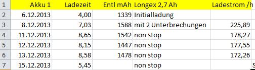

                The question now: Which one of these spots should I try for SG cycling my batteries for getting the best Input vs battery output results? As an example: Using 350mA Input, 180mA output shown with the analogue Amp meter, 170rpm I was able to extract from the battery between 225mA and 172mA, the tendency is sinking. These values are identical using 1 charging battery alone or 2 in parallel.
                I'm confused...

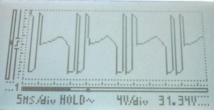

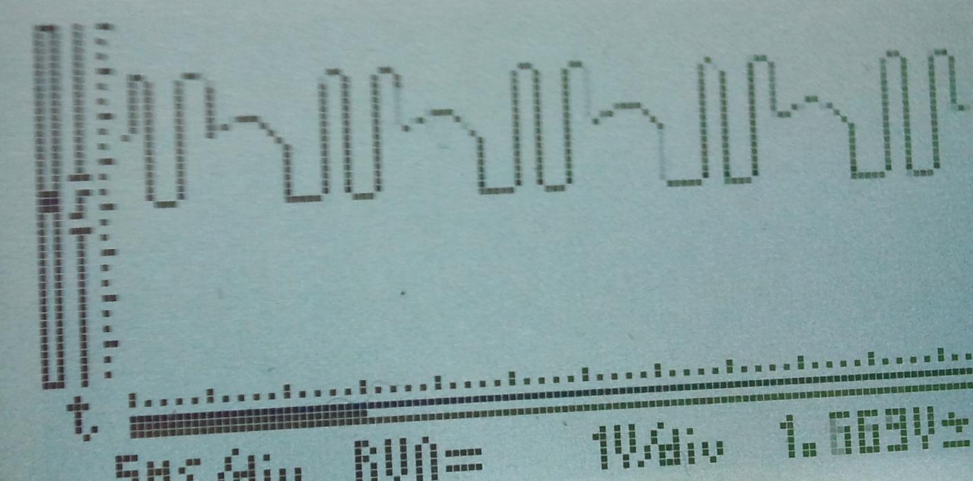

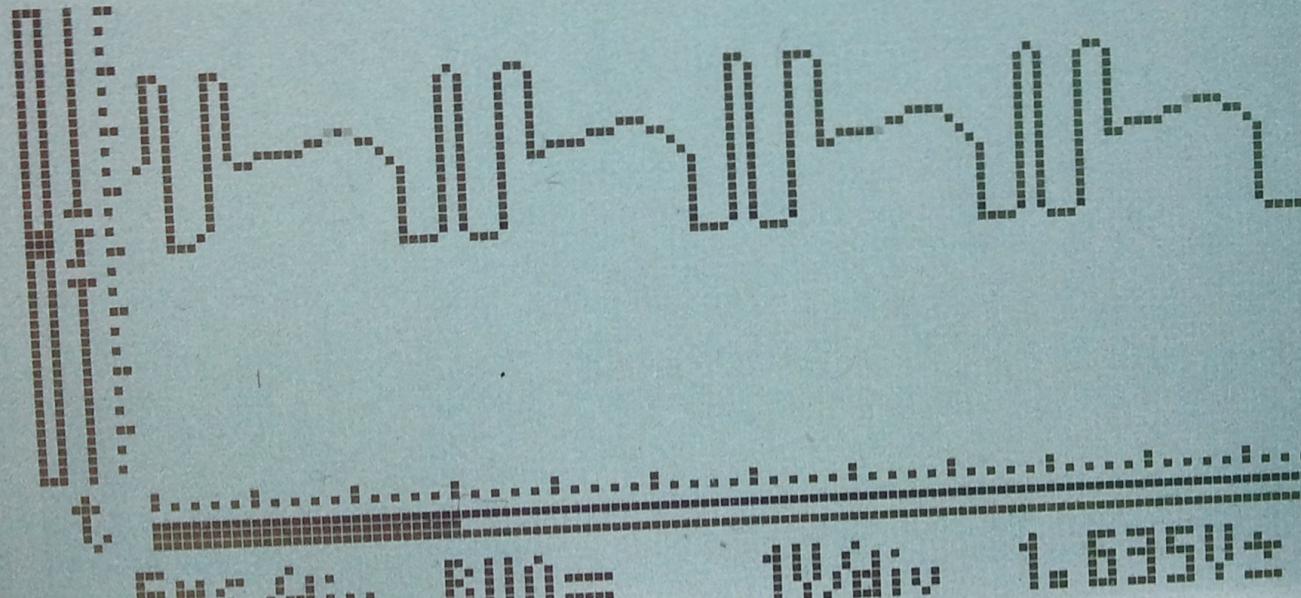

                Here are some oscilloscope pics with 287 rpm and with 230 rpm. I measured at the input of the diodes going into the charge battery against input ground.Click image for larger version
Name:	2013-12-15 18.01.13.jpg
ID:	45945Click image for larger version
Name:	2013-12-15 18.05.00.jpg
                Waiting for comments and hints
                Ralf K
